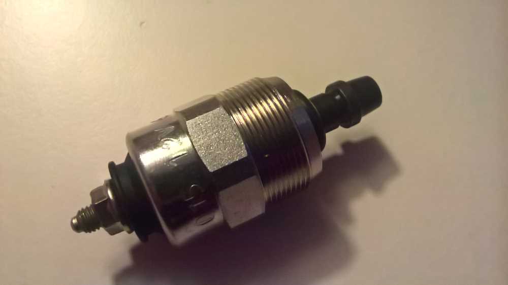

In other news I purchased something shiny and new, a 12v stop solenoid. Trying to get bits sold on ebay and need to weigh in a load of scrap from this to fund other bits.
