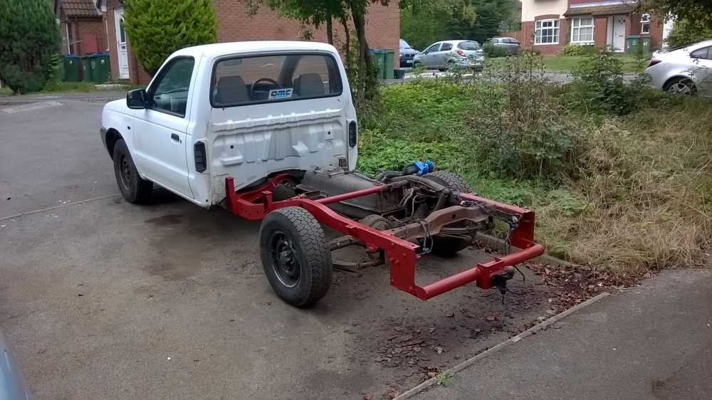

Well this really is the truck that just keeps giving.

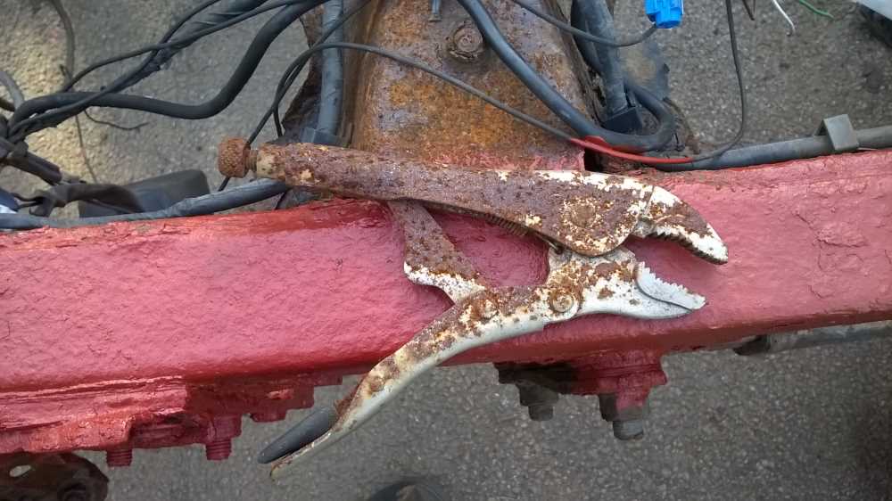

Not only had a previous mechanic left a set of mole grips on the rear brake nipple

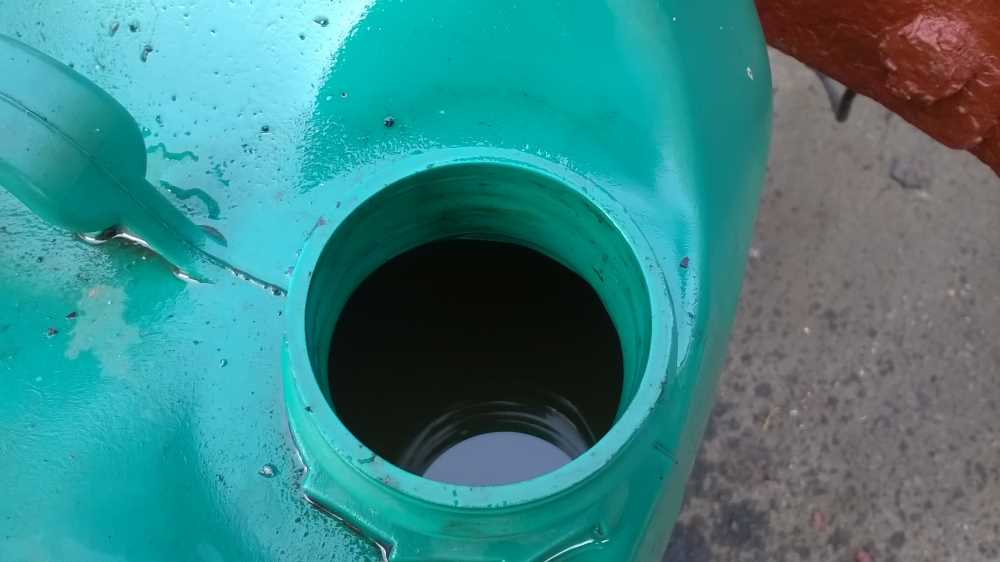

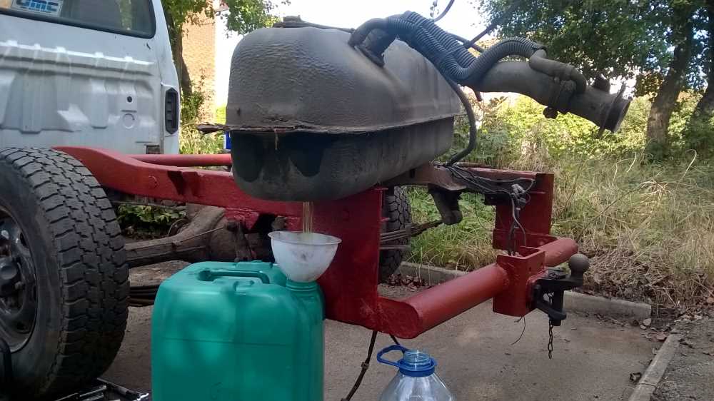

But the fuel tank was half full of what appears to be pure white diesel (no water, no cherry, no veg, no engine oil, no piss etc). So as I'd already made my £100 back and there is about £30 worth of diesel there plus what I've made in scrap from bits I don't want.

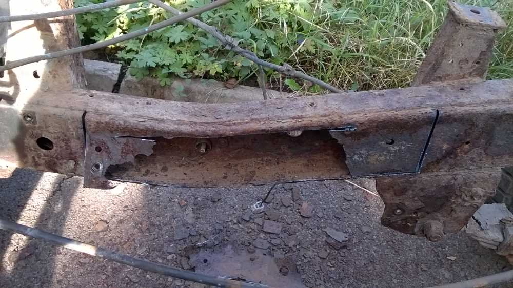

Glad I took the tank off as it was hiding the rustiest bit of chassis. Cut out 3 sections in the end for welding when I get a chance
Painted inside where I could reach
And the rest of the outside of the chassis (bar the bit that's getting replaced)

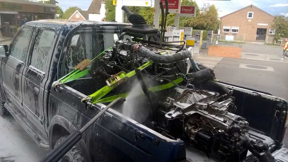

More excited than a very excited thing as I FINALLY have a Cummins engine.
Like genuinely, If it had been a choice between getting laid today and going and getting the engine I'd still have gone to get the engine.
It's taken a while as more people are fitting them to cars and there is less of the lorries on the roads so while this time last year you'd have got one for £500 with all the bits no trouble there now isn't one on ebay even for double that, they are actually getting close to tripple the money.
Anyway a very nice man in Norfolk was breaking one and I got mine for £500 cash, he even gave me 2 rather well made cups of tea between finishing removing it and craning it onto my truck.
I got it strapped down in the other Ranger using a couple of axle stands to stop it falling over. The Ranger has a payload of 1135kg so I should have been well within my weights  and only the prop was hanging out past the end of the bed but it definitely felt a little light at the front on the way home.
On the way home I took her for a wash.
And after a lot of huffing and puffing it's sitting on my driveway. It's a right pain as I can't have the boom all the way out on the crane due to the weight and so it was only just off the bed at full reach. It's a 130bhp model from a 1997 DAF 45. Can you believe a turbo'd motor that has 22bhp per liter!? Anyway that won't matter, it's getting an intercooler fitted and it's got a 12mm bosch VE Smile

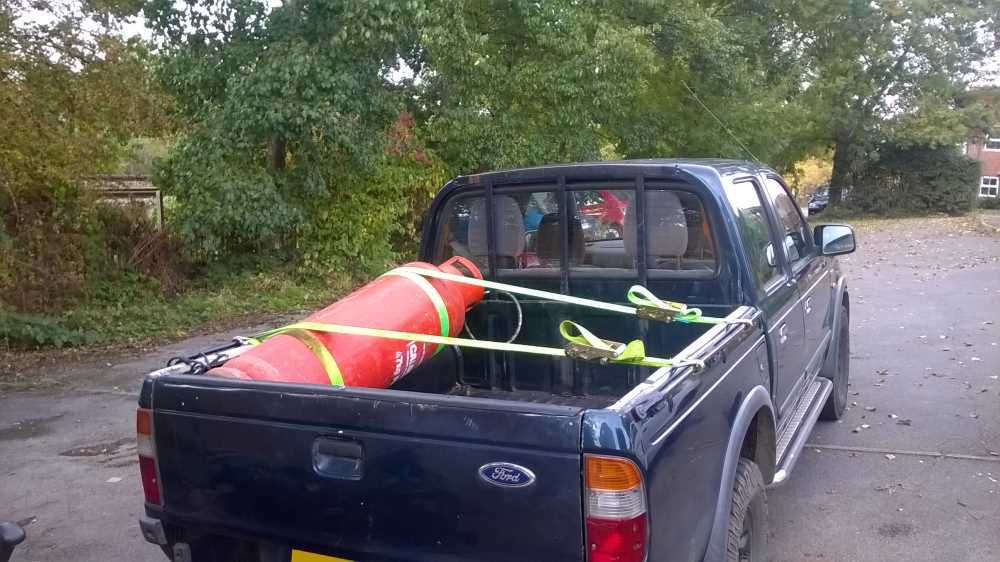

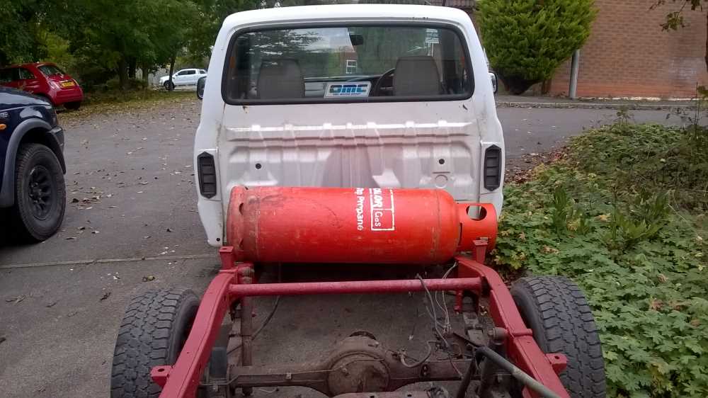

As you may have seen in the other thread I picked up an empty 47kg propane cylinder for £5.99 from a marine supplier in Barnes.
I intend to use it as a fuel tank as it holds 92L but as with everything on this truck it will need some modifications. I need a filler neck, block up the main valve, possibly fit some baffles as well as pipes for feed, return and breather.
I intend to mount it horizontally across the bed on custom mounts (isolated by rubber strips). Gonna have the valve at the drivers side and slightly offset it to the passenger side so I can run the legal exhaust up behind the cab that side as well as balancing it side to side.
