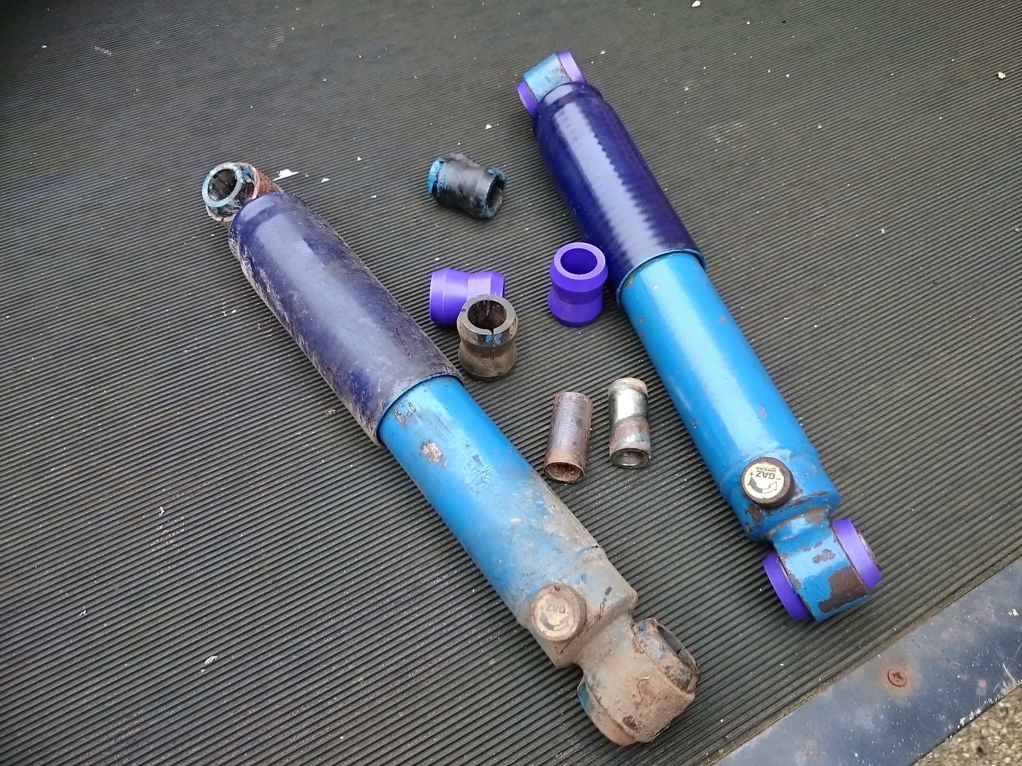

Spoke to GAZ...
£13 later and they are sending FOUR damper bushes for the rear dampers first class post.
#win
Couldnt of got a better outcome!

Bushes arrived today...
