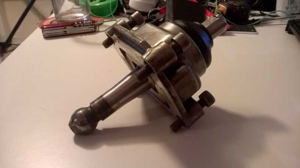

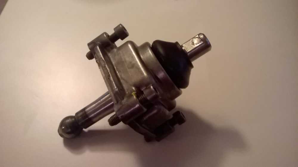

Had a package turn up all the way from the good old U S of A
A bit of bargain off American eBay, the upper shifter tower for a ZF box. It was BINoBO and I offered him $25 looking to haggle and he accepted.
Just need a similar bargain on the middle bit (if not they are about 80 euros from Germany).

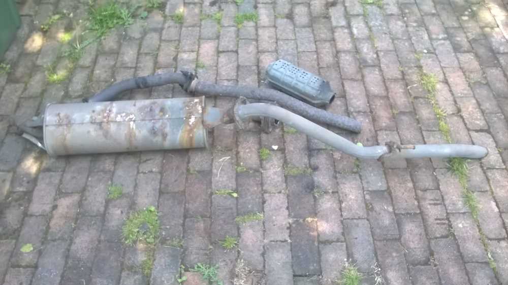

Removed the original exhaust from the truck today, It was only on by 1 hanger as every other one had rusted and snapped. Got £16 for weighing in the cat. Still got the original box and spare wheel to remove from the underside before I'd consider it clear of crap underneath.
And I took a photo to use as a sig then re-sized it slightly

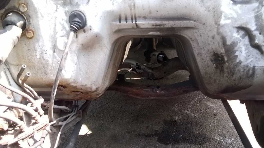

Forgot why I was posting on here, progress Smile
Got the box out (without removing the crossmembers)
Left a reasonable space in the tunnel
I'd cleared off the center console as it was in an absolutely minging state (along with most of the interior TBH). Been eyeing up the tunnel for cutting and seeing what I need to remove but haven't chopped anything yet as I don't know where the ZF will sit.
And I got the pedal box refitted, on the second attempt as I didn't line the clevis for the brakes up first time and bolted it down without realising. The brakes work and the hole centers are within 2mm of being right for the 30mm clutch master cylinder I've been eyeing up.
