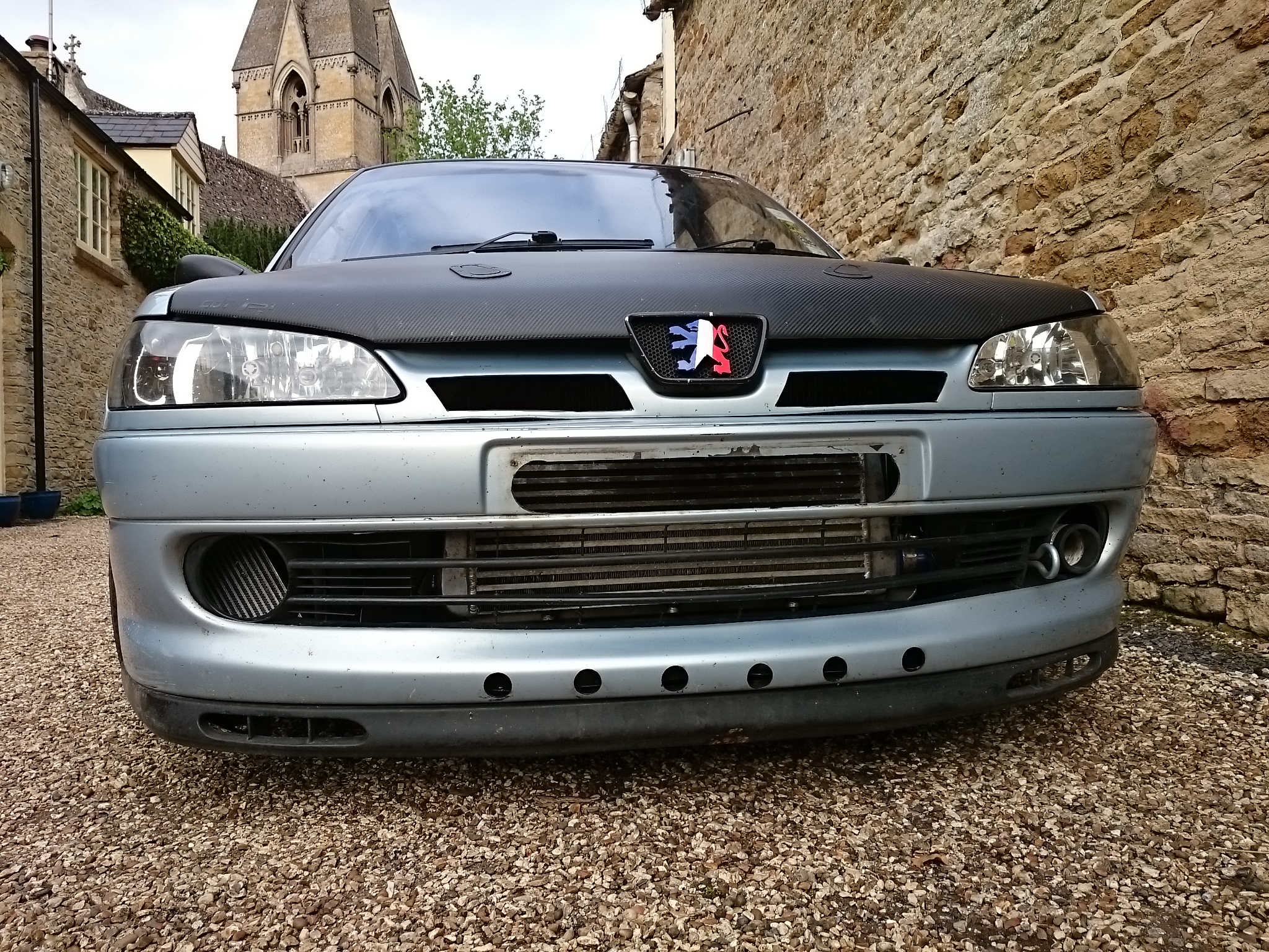

Got oil cooler on... Remember previous results? Hopefully this be a bit better. Mocal 13row cooler and thermostatic sandwich plate, pirtek lines.
How it sort of sits.... Note: less kinky boost hose also
With bumper: (bumper just slotted on to check fitment)
It will get some shrowding as will the rad/ic.
Had to "make" a tool for doing up the oil lines in place...
Painted couple brackets that looked nasty too. Lots of room now for some air flow

Haven't you got to be a bit careful running the cooler upside down?
its pressured wont make a blind bit of difference

(19-05-2016, 07:51 PM)allye Wrote: Haven't you got to be a bit careful running the cooler upside down?
Run it anyway you want... 6 bar pressure sorts things out

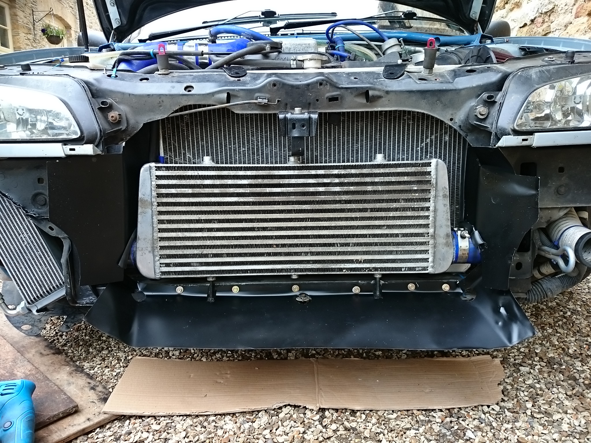

So...began to add some shrowding...(side of a fridge)
Cut some more bumper away too...so for track time/no numberplate it look like this:
Just need some trimming to inner splash guard for the oil lines, a bit of shrowd for oil cooler, give it a service and can fit the undertray.
Then got some galvanised sheet free, so use that to make a sort of airbox.
#allthecooling
...then front brake service...
...then hopefully meth injection...
...then wash and polish.
...then fcs.
