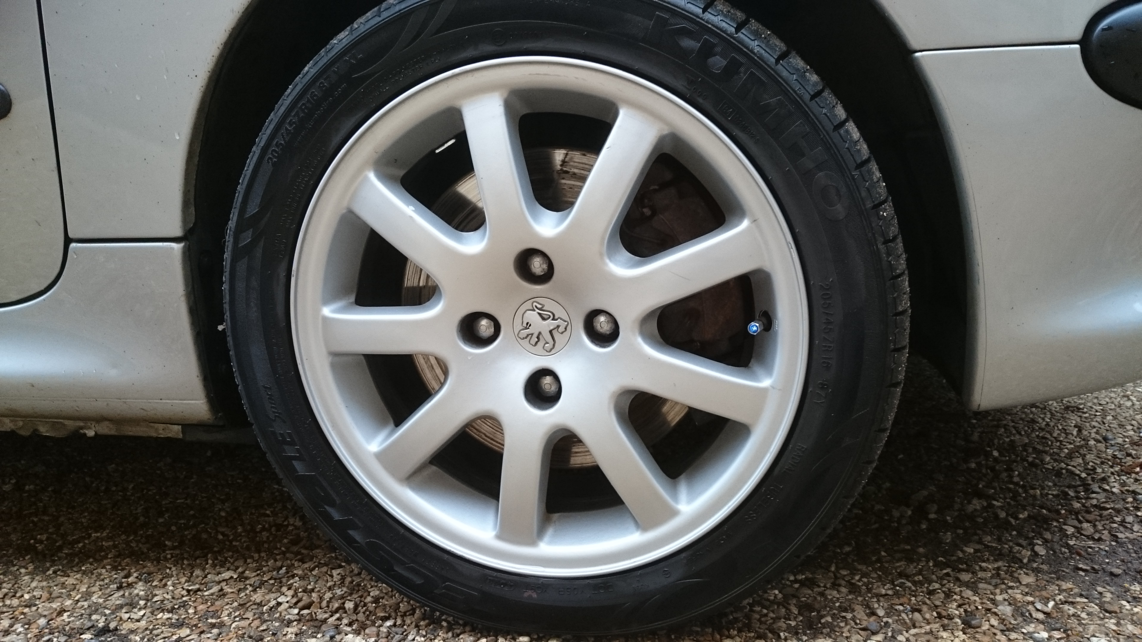

So...this has had some new wheels recently and now has bigger brakes:
Before:
After:
Pic doesn't show it well...but thats 302mm. From 266.
Although...need a bigger M/C now.

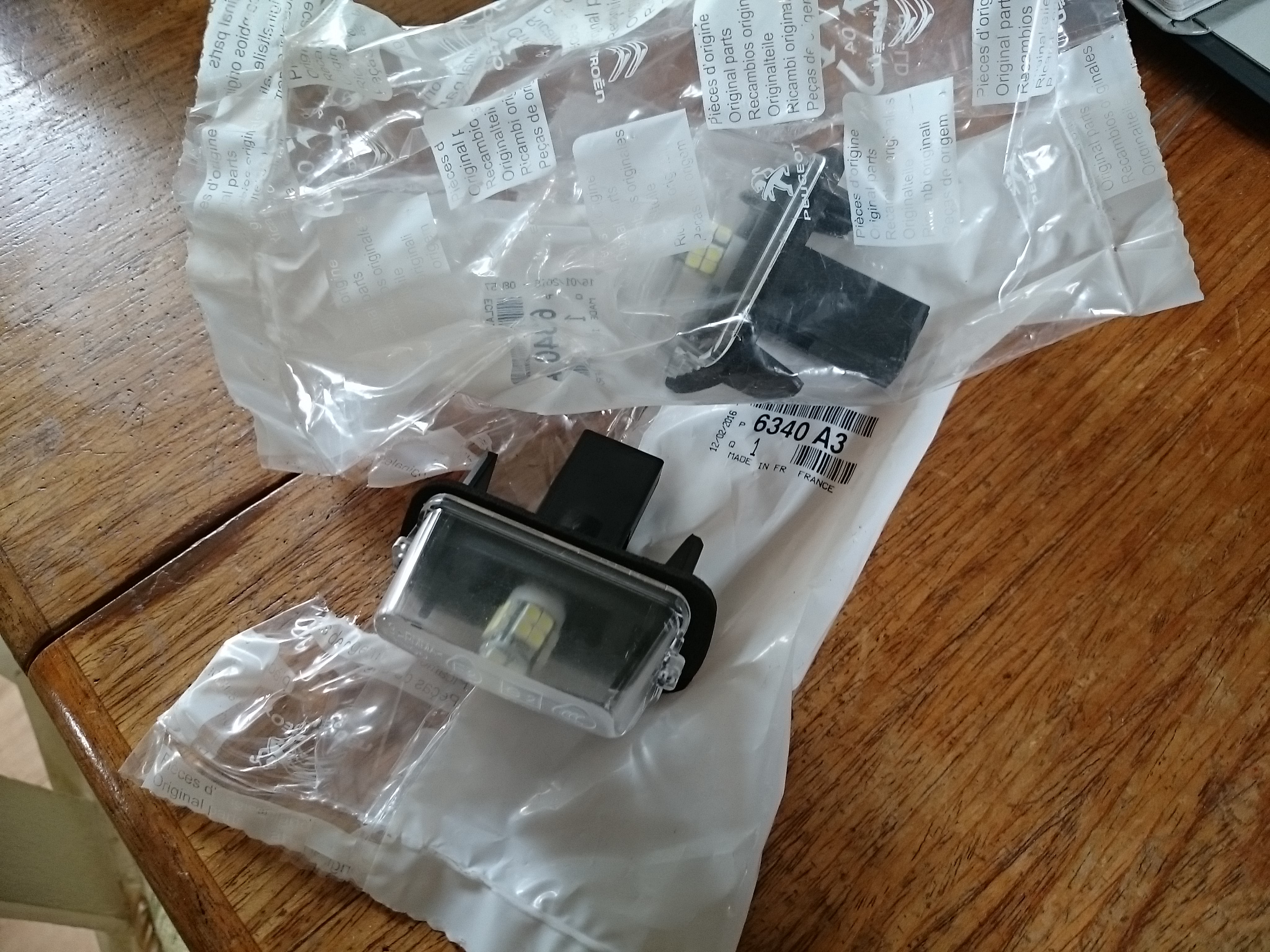

One was broken and one missing its.cover...
£5.70 delivered later... (I replaced the lamps that came with them with the leds)

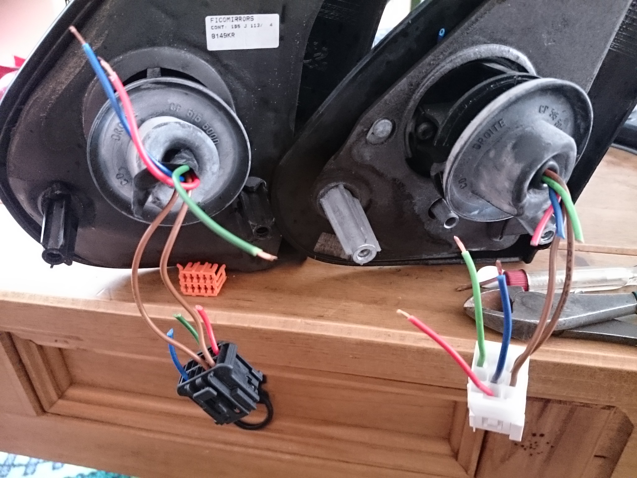

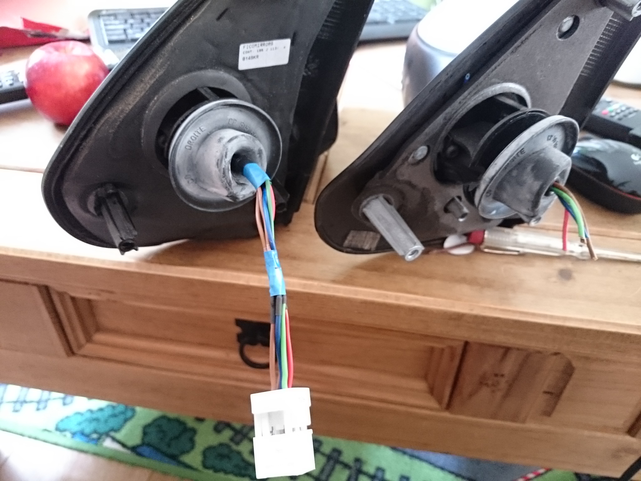

But today...grabbed the wingmirror which got smacked off three months ago and has been taped up since. Despite getting one from an almost identical 206... Had different plugs.
Sorted.

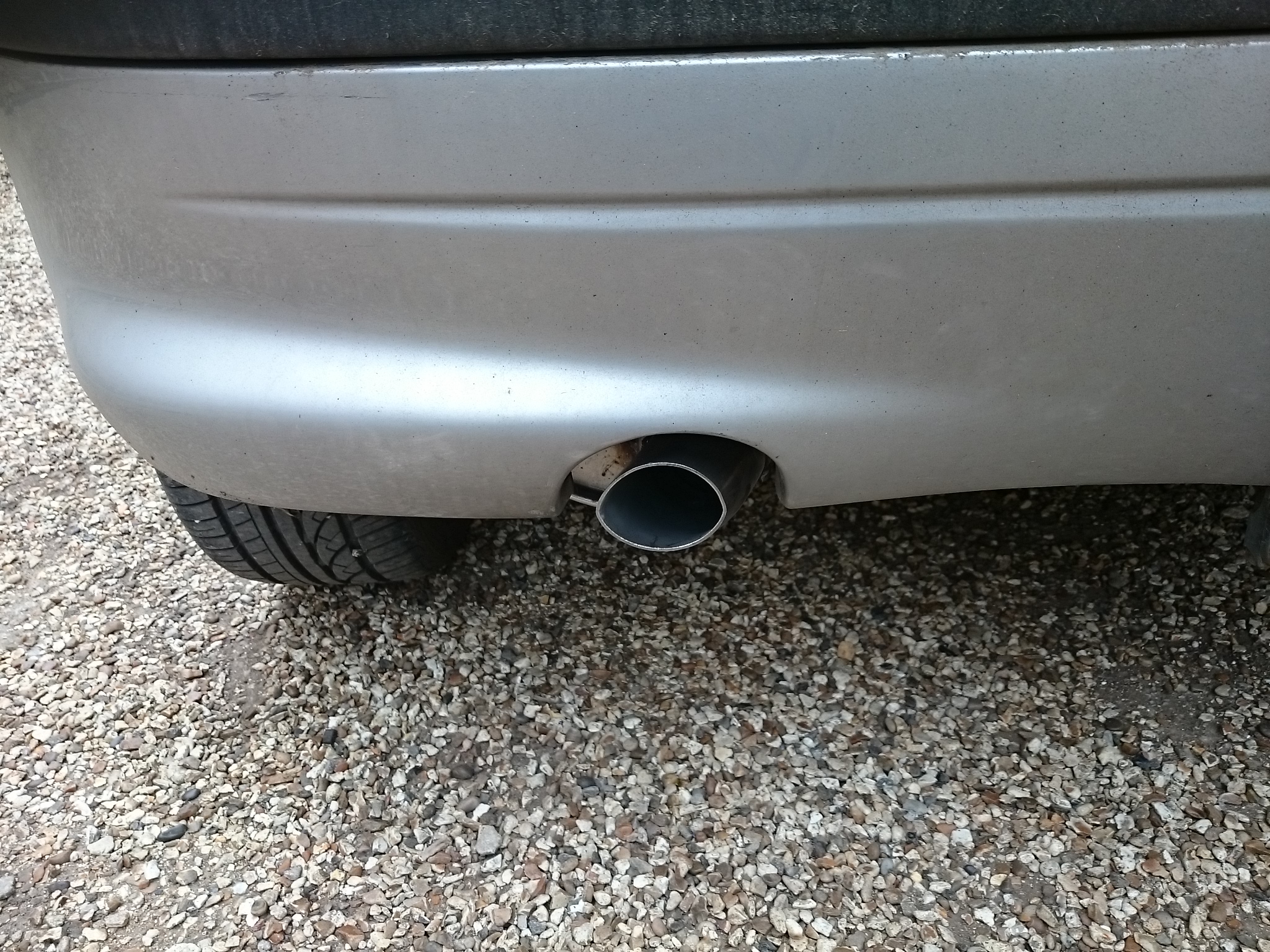

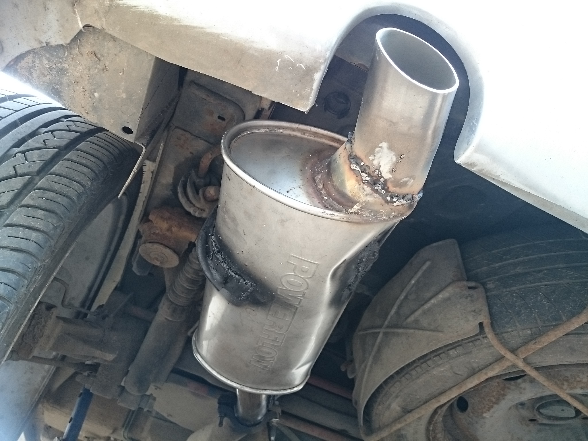

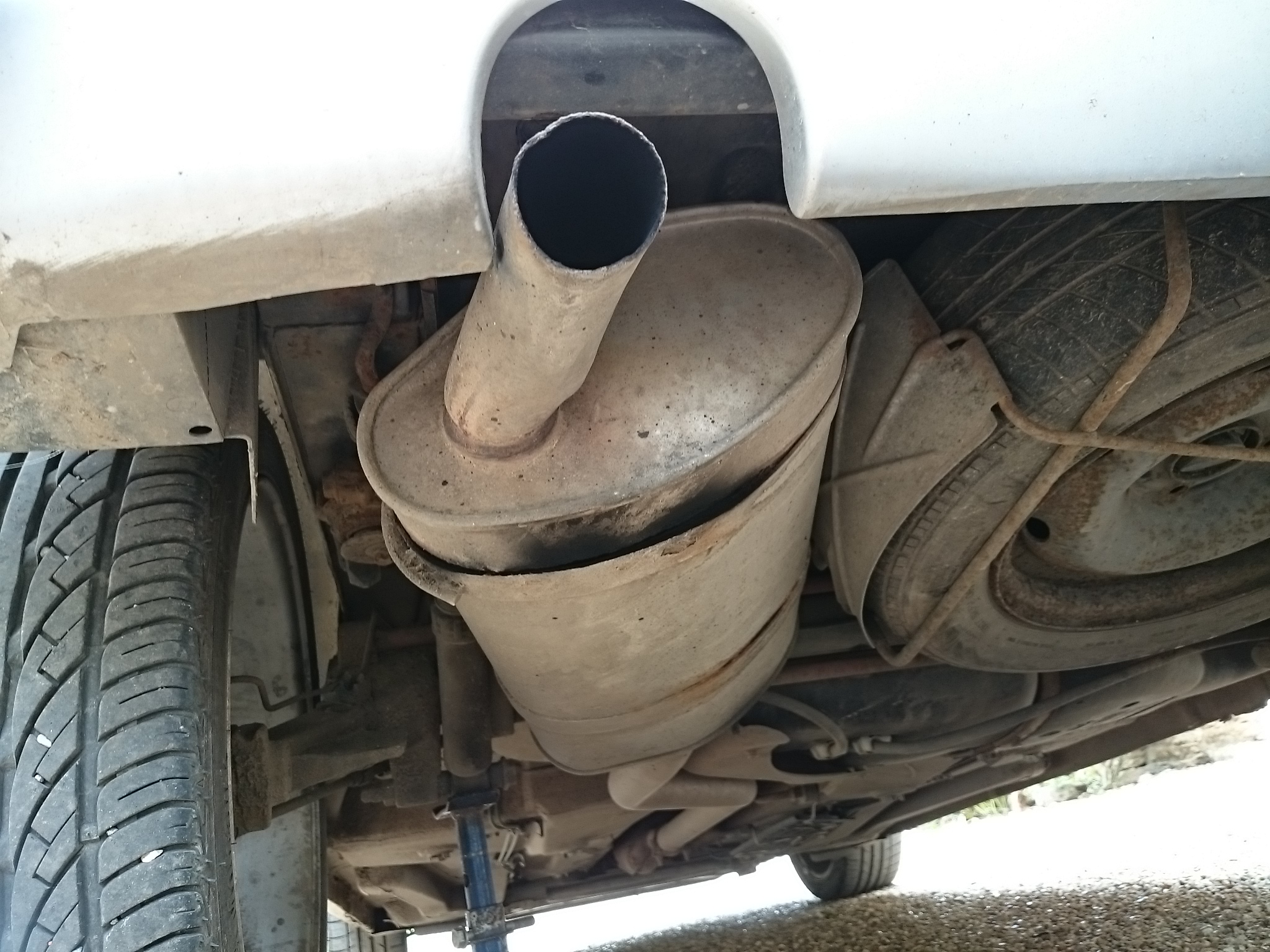

Exhaust has been knocking blowing...thought better have a look...woops...that needs doing...

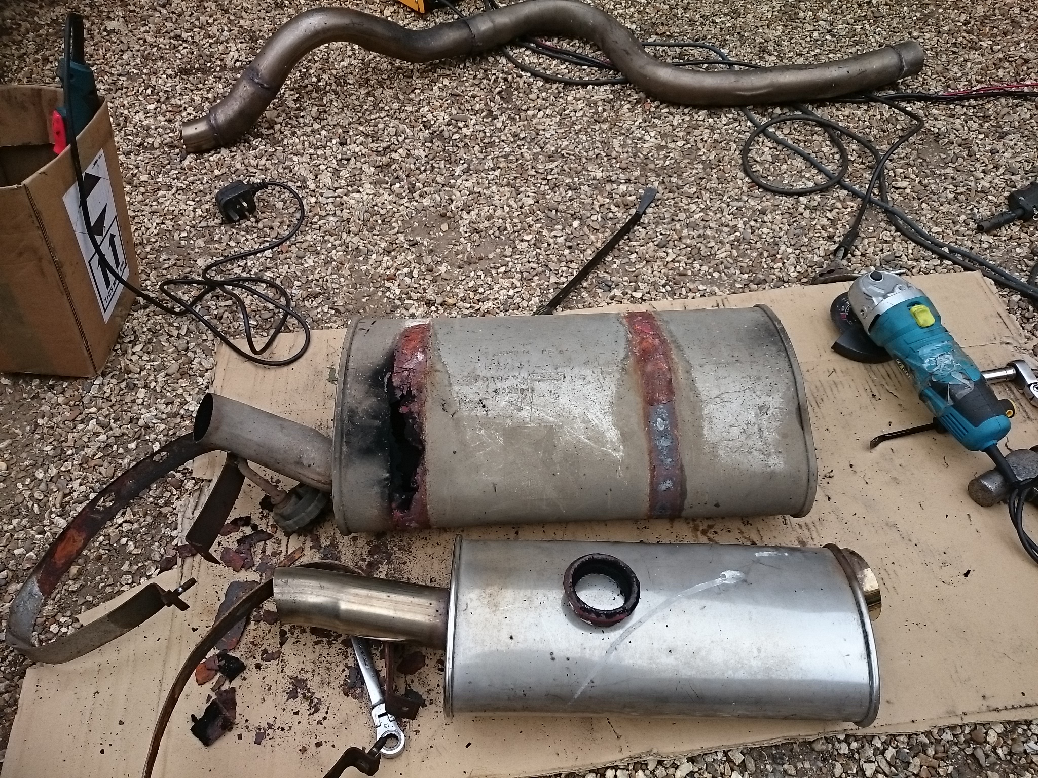

Yes the welds are awful..gasless cheap mig vs thin mild onto thick stainless...
But it does the job, aids flow ready for stg2 and from outside looks OEM ish.
Plus it was free and just cost time and a grinder disc exploding into my hand ThumbsUp

exhaust bandage would have been simpler/easier ThumbsUp

Man.... That welding, I don't know if that even counts
(14-05-2016, 10:06 PM)ozonehostile Wrote: Man.... That welding, I don't know if that even counts
best comment ive seen in a while. granted piggy was up against the odds with equipment and material his welding. but come on dude youre ocd about everything flapper disc works wonders ;Winkeen a while since ive looked at this thread seems to be making some good progress in the right direction though
Really could not care less.
lol
Cant see it...so its perfect lol
But you know its there! I can't even weld and it still looks awful...not that the dented box looks any better tbf. lmao
Ah well i it doesnt bother you and holds its not an issue really is it. Not like its structle or anything lol
I can assure you its strong.
But...my hands are in the air like I just dont care.
It looks like you've used a stick welder and forgot to knock the stag off. Surely worth just running a grinder over it quickly?
No...ripped old one off...put "new" in position. Welded it in position with a crap welder and an idiot.
Works.
Win.
/Thread

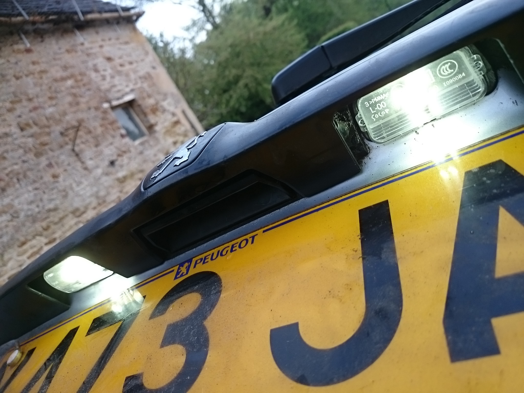

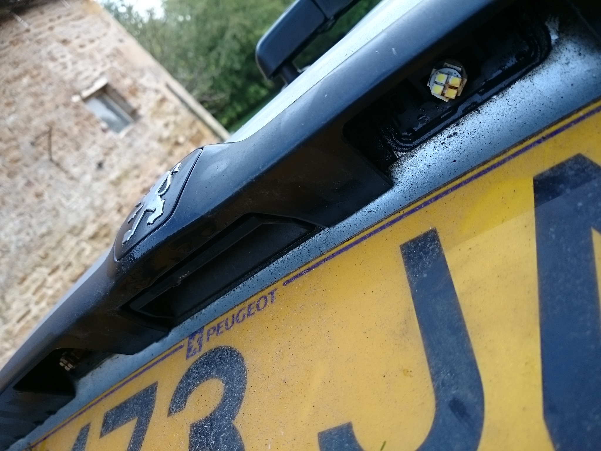

Sorted this too:
New n/plate light holders, pair was £5.70 new delivered, in gen pug packets.
Needs new plates I think...maybe some pressed ones
