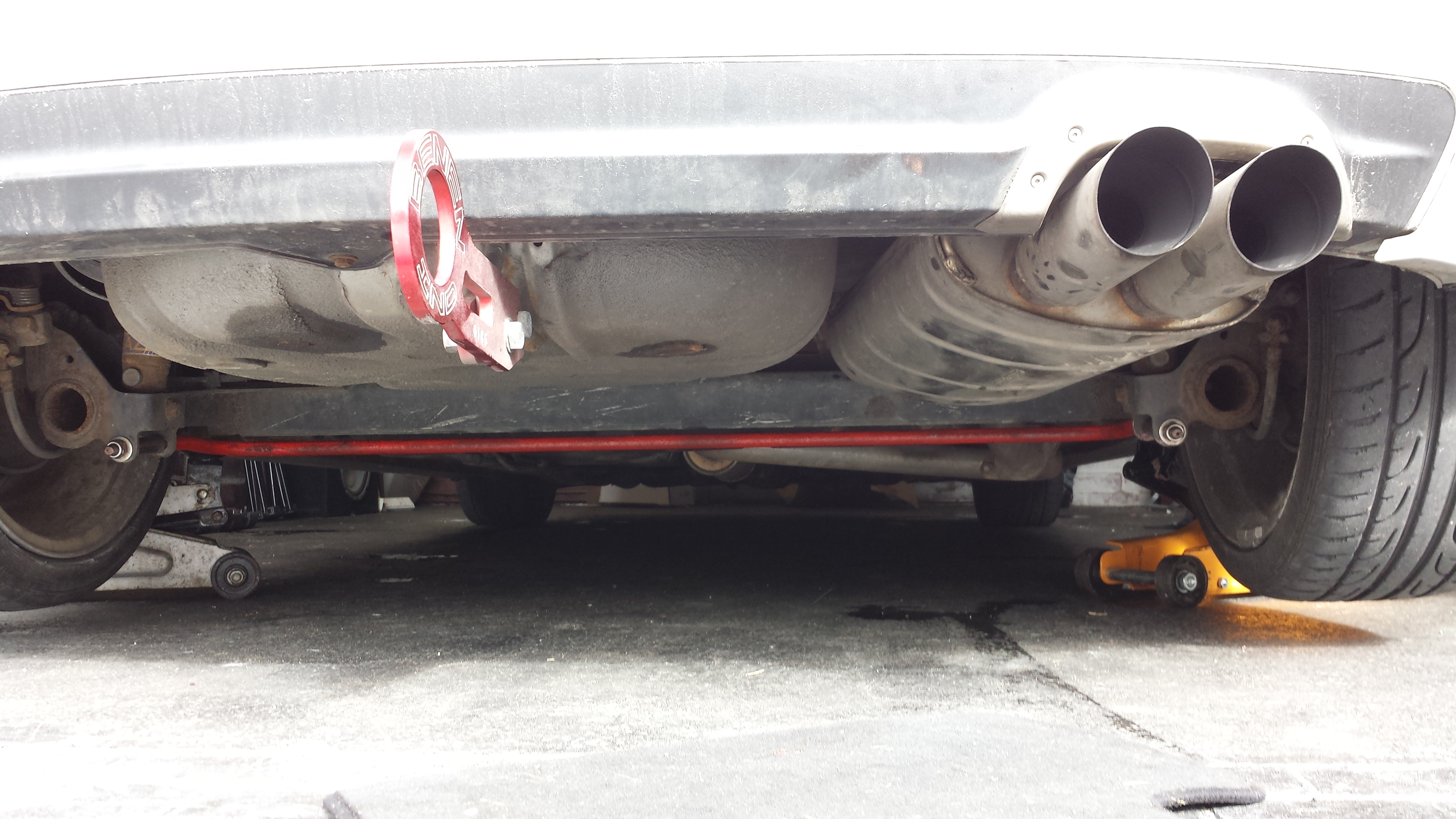

Ordered a rear anti roll bar which should be arriving soon

Fitting rear anti roll bar (think its made a massive difference in reducing the understeer)

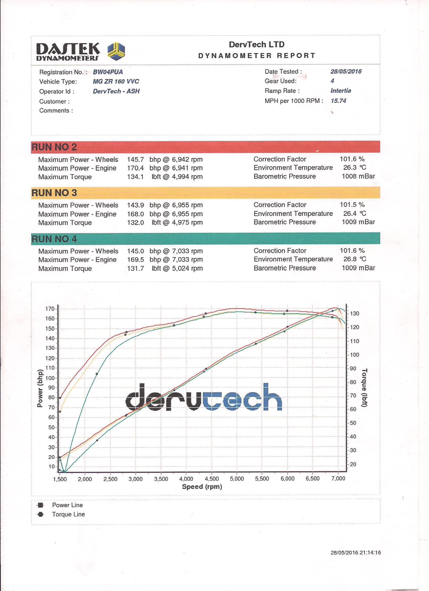

and DYNO Resultssssss
With my own developed remap and all the mods etc it pulled 170hp (at fly) . Now dyno results are always going to be a can of worms as everyone has their own thoughts on the matter but if anything the value seems lesser than what others seem to think vvc engines make. As such im happy with it rather than being overly optimistic.
The dyno was also brilliant at finding the choke points as the first few runs on the stock map saw 145 hp, sacking off the air filter instantly bumped it to the mid 150s so we checked it and found the filter to be dirtier than Dumdums internet search history, the lack of a cold air feed also doesnt help. contacted ITG to source a replacement intake pipe and they wanted £80 for a silicone S bend! They can fk right off the cheeky lady gardens.
