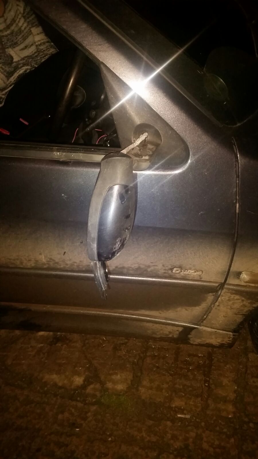

I'm still not sure if it was a good purchase or not haha, the clutch is slipping again and it's leaking diesel.
Just to top off how unlucky this car seems to be for me, some mong in a polo driving on the wrong side of the road smashed my mirror off tonight!
[attachment=undefined]

Did you catch a reg or catch the driver? Im still saying this car is cursed lol

(06-11-2015, 10:16 PM)ozonehostile Wrote: Just to top off how unlucky this car seems to be for me, some mong in a polo driving on the wrong side of the road smashed my mirror off tonight!
Same thing happened to my car. Damn them drunk drivers!
#82
(07-11-2015, 08:04 AM)Matt-Rallye Wrote: Did you catch a reg or catch the driver? Im still saying this car is cursed lol
I couldn't see their front or rear plates Sad they were following too close to the car in front of them and there was a line of cars behind them. All I saw was it was a 2004 silver polo, so if you see one missing the drivers mirror on your travels...  :p
#83
If someone asks at work for a mirror i'll get an address Wink
Team Cyril
#84
(07-11-2015, 10:07 AM)Matt-Rallye Wrote: If someone asks at work for a mirror i'll get an address Wink
excellent sir :p
If I see them driving around today ill certainly be having some very strong words aha
