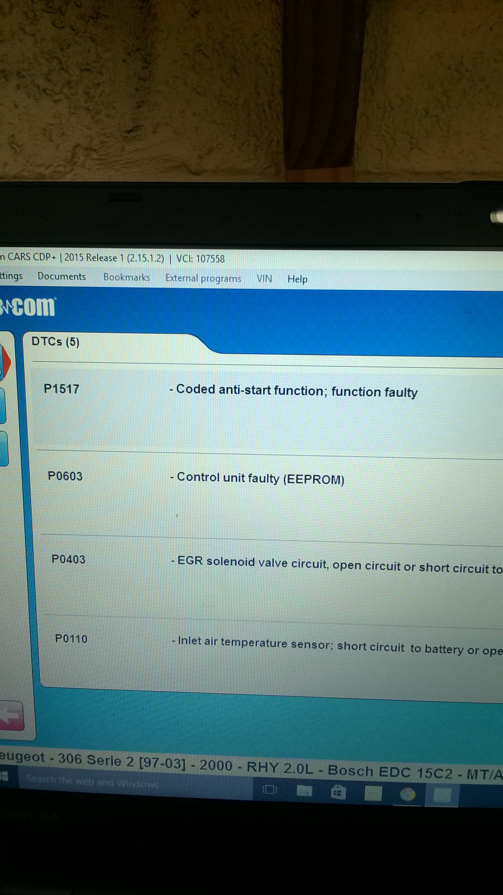

On case anyone's interested. Broke down 8 times this morning.
'Control unit faulty - EEPROM' Not an expert but that sounds like the ECU is indeed fubared..
It shouldn't be that, there is a reason for that code, it's been there since fitting the engine.
There's nothing new in those codes from what we had before though. What was the 5th code as it says 5 but only lists 4 lol? Have you got PP yet? You're welcome to try mine again if you want.
5th is a maf code. Again unimportant.
Just so you know, mine was communicating fine but ECU was replaced and the car fired straight up.
Im not, even for a second doubting your ability. But might be worth trying another ECU if you can get your hands on one Smile

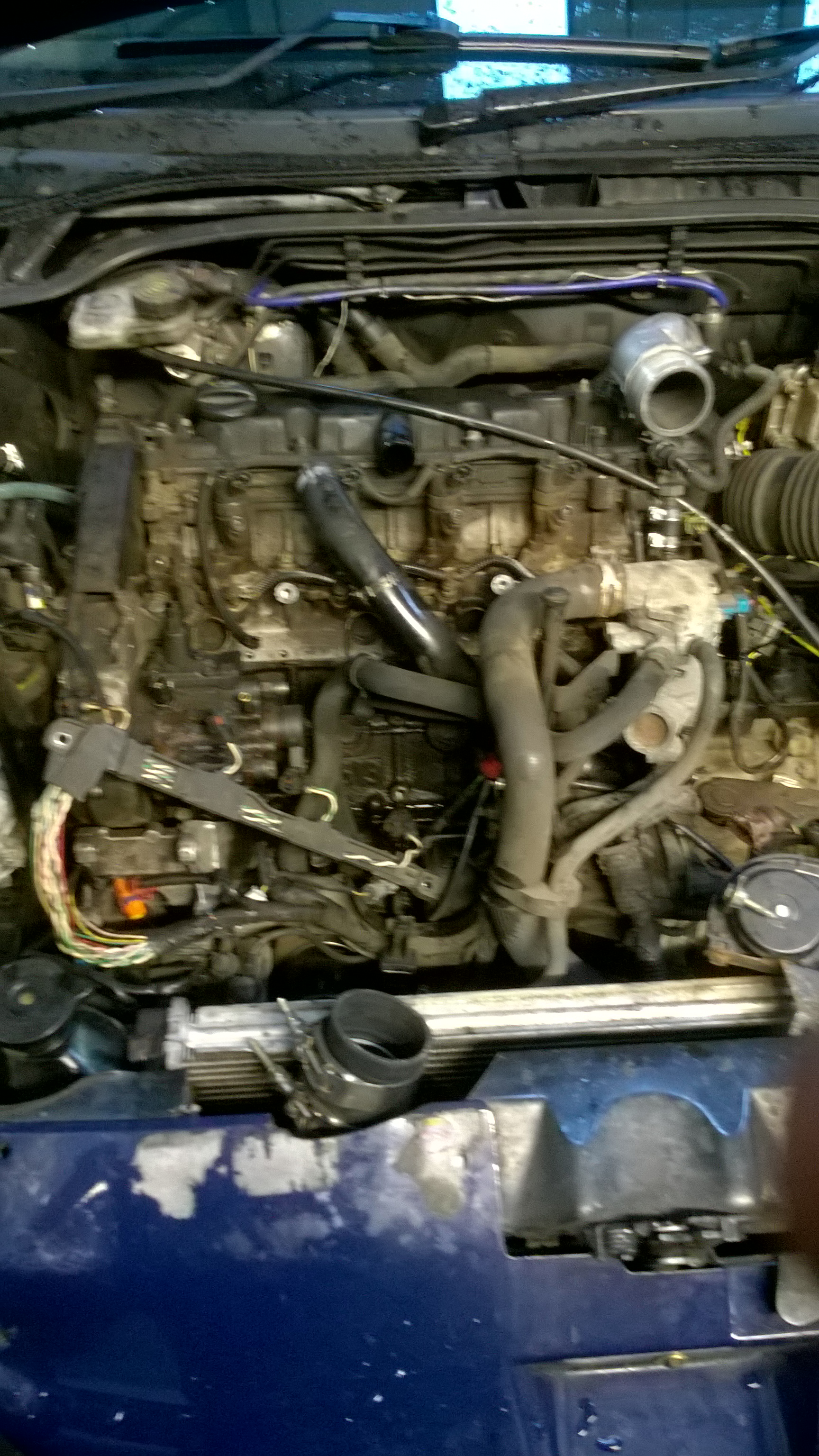

Well it took me 50 mins to get to work this morning instead of the usual 20 with the cutting out so decided to leave it in the workshop and started pulling bits off i no longer need. Thinking i may put an xud wiring harness on it at some point as well. So here is a picture of the progress. Took half hour. So not a lot done. Rail off, filter off, various brackets off etc. Plan to fit injectors tomorrow as the clamps need a bit of modding if my measurement are right.
Might be worth going over the remains of your loom while you're there bud, i've yet to come across an ecu that failed that sporadically so it's probably a wiring fault somewhere.

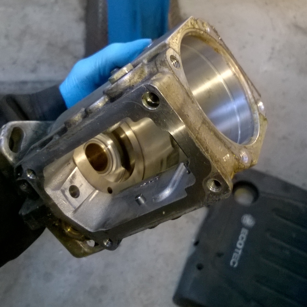

So i stripped down 3 pumps today to try and get all the bits to make one good pump. Cleaned up pump casing then got to the roller cage and have to wait untill tomorrow when i strip my 4th pump for the remainder of bits.
