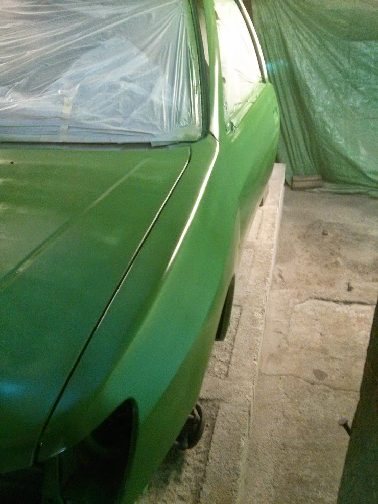

Ok,
So ill show you what colour I painted it now, although, anyone who knows me / my general projects, will have already guessed what colour the farmer has painted his car! So I am already holding tight for the abuse!!!
I loved the black ph1, and in alot of ways will miss it, but I wanted the car to stand out a bit, and the most important thing I've always had with the car / project, is how its been built at home in a farm workshop, and is heavily inspired by "agricultural" ways of working...and anyone that knows me personally, will know my love for a certain breed of tractors!
So decided you only live once, **** it I'm going to paint my car JD green!!
As with all parts of this respray project, I'm on a steep learning curve, so as will become apparent in a few videos / posts time, you will realize why i call this the "first attempt" of spraying it, but this is the first time I laid paint on the car, but sadly it turned out that I was using a far to fine nozzle in the gun, which resulted in much to little material being shot, leaving a very "dry" finish, and alot of orange peel...but for the time being, this is how it went...
So started out by cleaning up the car / tack rag and mixed the paint up, got extractor / air mask on, and applied a tack coat, followed by 3-4 "heavy" coats, albeit, not very heavy with the initial gun setup!!
[Image: IMG_20140615_194557.jpg]
Redneck heating system got workshop temp up fairly well!:
[Image: IMG_20140615_202012.jpg]
Did engine bay and door shuts, trying to do it "properly" even if I dont know what im doing!
[Image: IMG_20140615_161945.jpg]
And then the rest of the car, what have I done!!! If you look close / in the video, you can really see how "dry" the paint is:
[Image: IMG_20140615_170449.jpg]
[Image: IMG_20140615_170438.jpg]
[Image: IMG_20140615_223319.jpg]
[Image: wxUILyBUF_olE_LKBDX-C5djMHW2DWsJPxB8XDZu...40-h987-no]
Mugshot!
[Image: IMG_20140615_151956.jpg]
And a video, can really see the issues here! Notice how thin / rubbish its coming out the gun....after sourcing the correct nozzle, I realize what an epic fail this was!
https://www.youtube.com/watch?v=RAyfLqpGyh0
Thanks for reading, I know its a bit criminal to the old ph1, but its only a paint job , it can be reversed heh, so not to much hate please! #farmerspecftw!!!

Keep forgetting to mention, I am no expert with painting, my best mate is a painter/bodywork guy, does lambos etc now....he was watching them and said for you to get a painters disposable overalls which help massively with stopping dust as your clothes/body are pretty bad for introducing the stuff being in so close quarters.
And to not release the trigger at end of each stroke to avoid build up but to "flick away" the nozzle at the end of each stroke/sweep ThumbsUp
#78
possibly too much pressure by the sound of it as well, and you havent got that flick at the end of the sweep I've seen every sprayer do.
Still, damn sight better than most peoples first attempts Big Grin
JD Yeloow wheels?
#79
Hehe yeah, theres alot of things wrong with that first attempt, infact, watching it back now is fairly cringe worthy..Ive painted it again now...with the correct nozzle, which went alot better! Have learnt to leave air flow going all the time, and just flick the paint in / out, stops the splatter / dry start / stop! Takes a bit of getting used to, infact, painting the entire car twice haha!
Interesting point piggy about spray suit, sadly its done now, Dust really is the biggest enemy trying to do this yourself, but can only do my best. 90% of it will sand back, but at the end of the day its a 100 quid respray, so I guess in some ways, at least people will believe me I did it myself!!
Had the pressure in the green / at levels I was recommended, The main issue here is just lack of paint flow, the nozzle was A - to small, and B - should have bought new gun first as last as it was obviously massivel choked up, I went out and bought a new gun after with bigger nozzle, and was like a different tool all together, each stroke would cover 3 times the area and a thick shiny coat instead of that matt / non even finish!
Will upload some more photos / videos of next few days, luckily I bought enough paint to cover the car more than once, as I predicted epic fails!
Its all a learning curve! One that after this I dont think ill be repeating for a while...!
