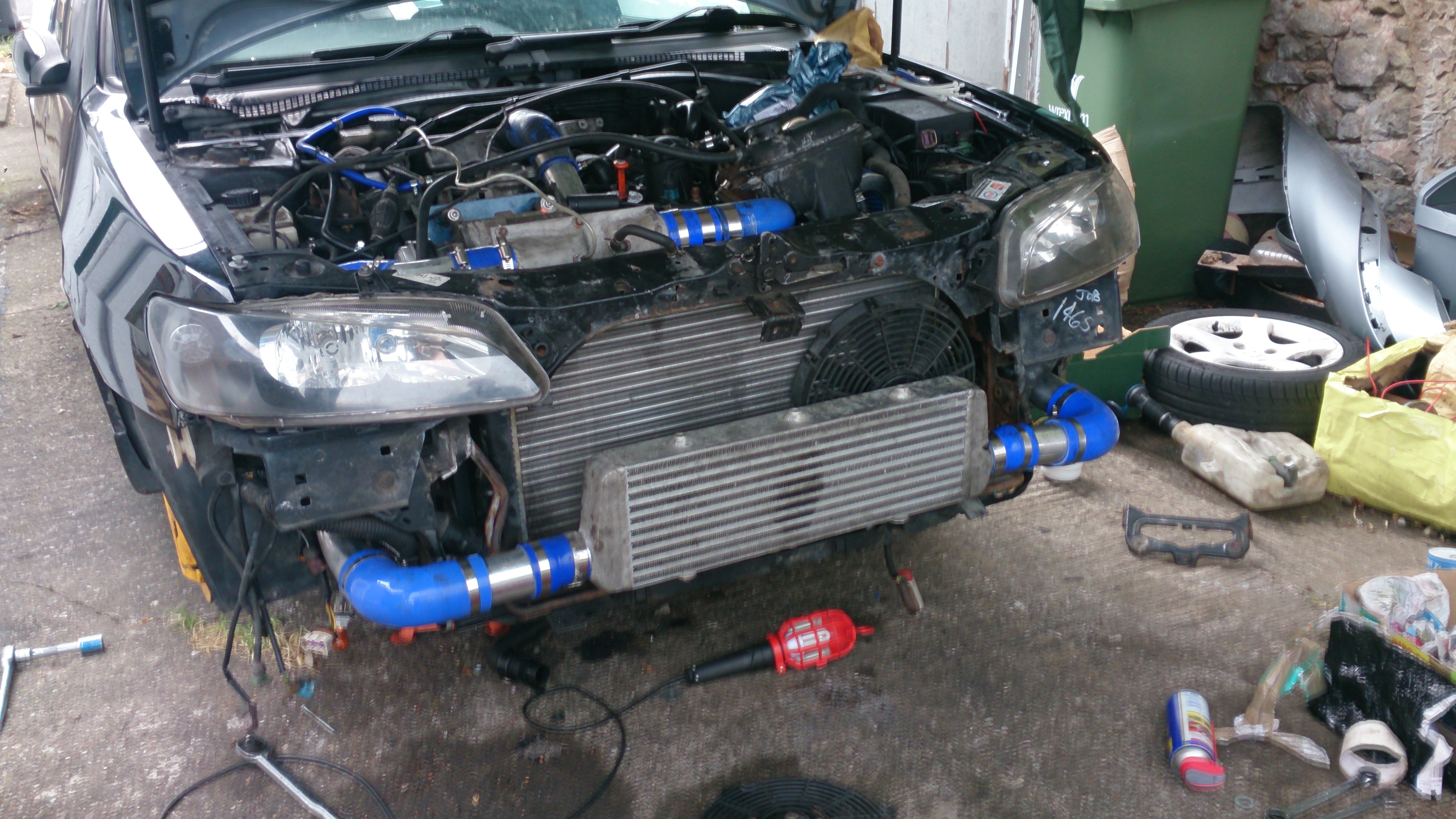

Well the day started off really well, got all the hoses and bits I needed from the scrappy. Next I connected the intercooler, oil lines to the turbo and wiring loom. I turned the engine over by hand a few times to check belt tracking and then got ready to motor the engine to prime the turbo. Then things went down hill of an electrical nature.
When I turn the key one click I get the battery light on dim, oil light even dimmer and the glow plug light even dimmer again! I've checked all the earths and other connections but still the same problem. I think the loom may have a break in it somewhere which has really pissed me off as I can't get another til next week as I'm at work. Sad

Yea, battery in the boot with bmw 328 battery cable from back to front, earth from battery to chassis

Have you double checked earth from engine to body? Or if you've got jump leads you can use one to go from battery to front to rule out your cables. I had some issues with my battery relocation, mostly crappy connections and earths.

Mine wouldn't work until I ran 23mm2 cable both ways. The chassis didn't earth it properly.
#40
Mines always been fine using chassis, just make sure you have good connections, put a jump lead between a GOOD earth on the engine and a GOOD earth on the body, do you have full power to inside elecrtical stuff? bacause all the stuff you described is on engine loom, which suggests engine ground to me Smile

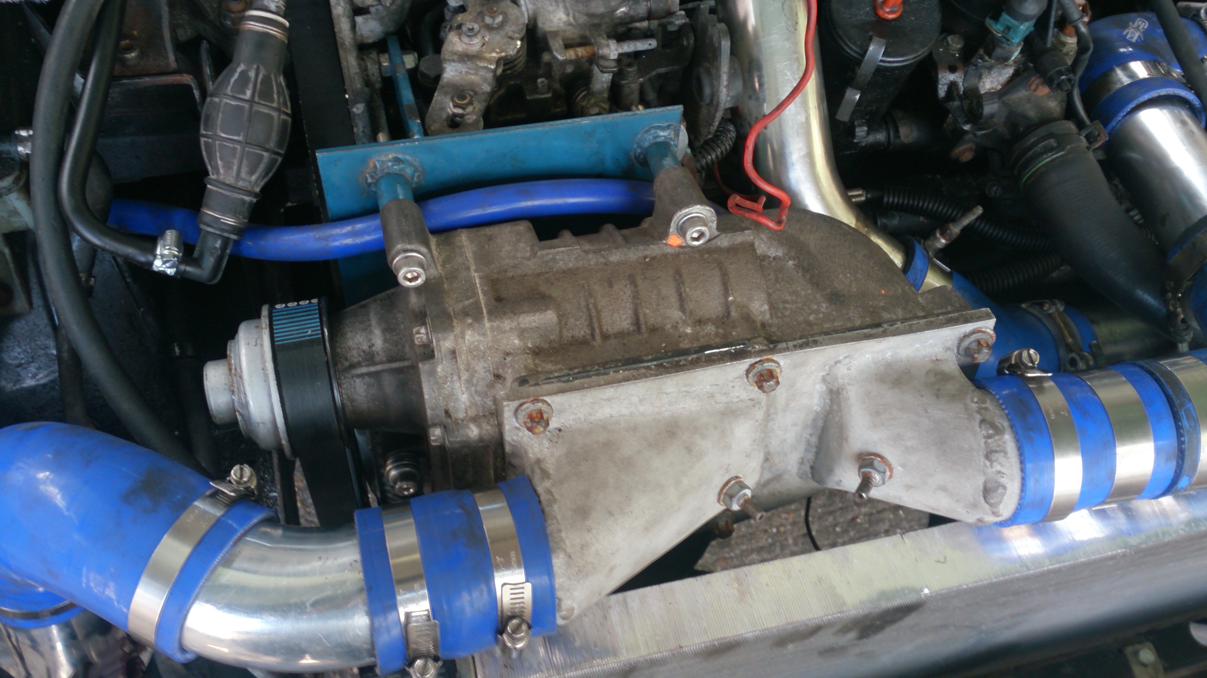

THis is whaere I did get to today before loads had to come back off again

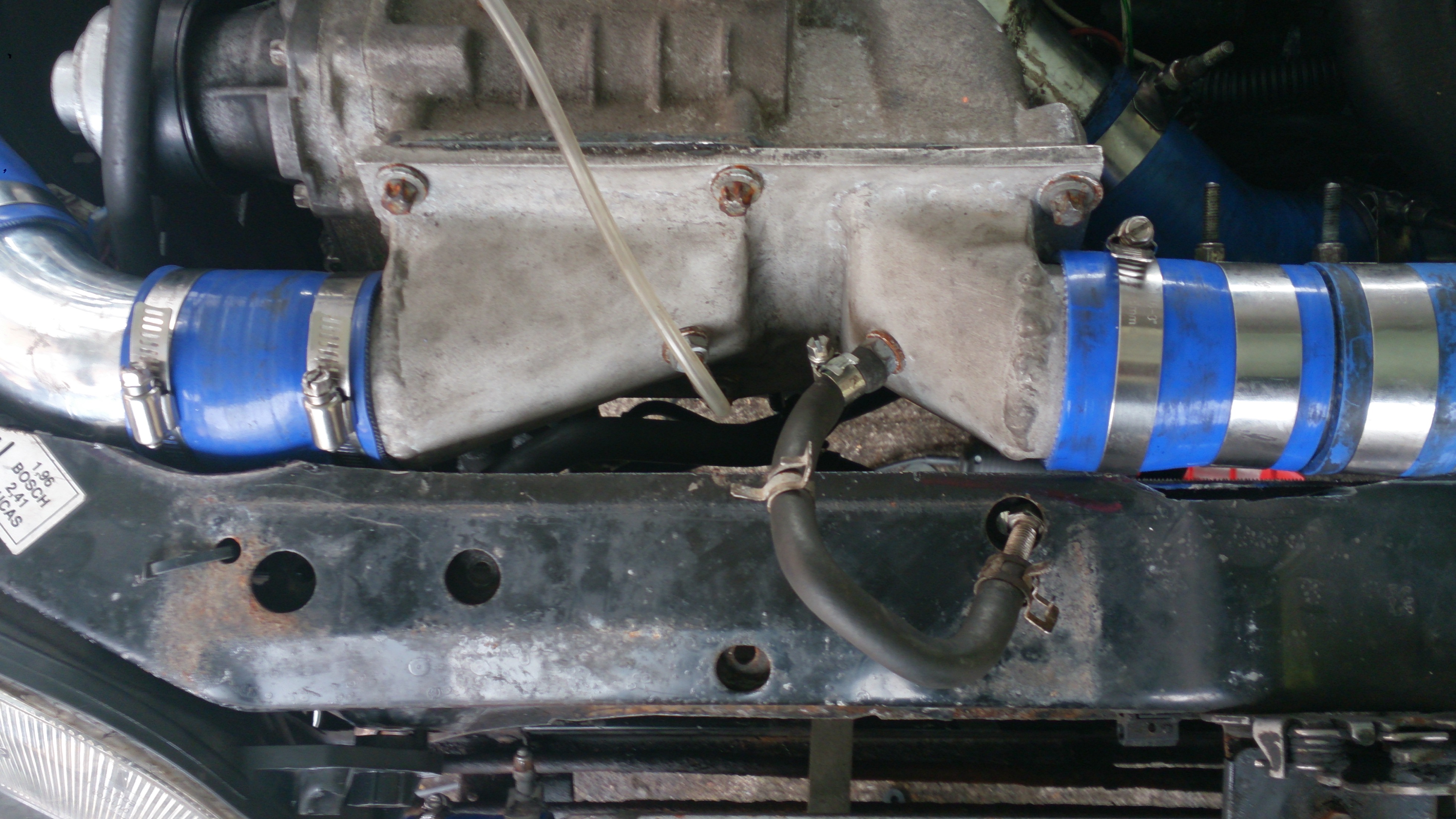

Bloody snug fit around the rad on that charger!
The beasty! Need to get some more 8mm silicone for a boost gauge pre and post charger.

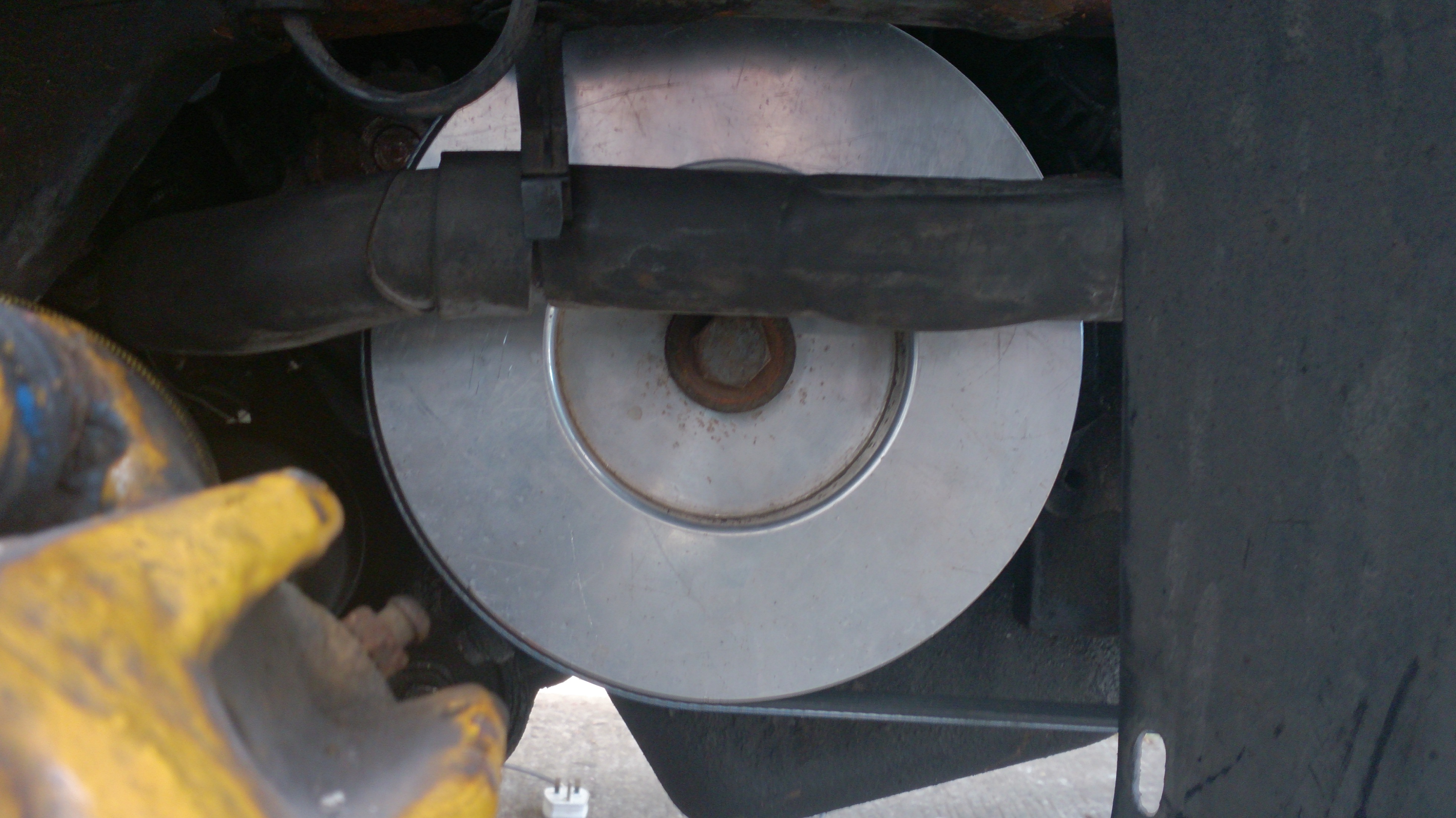

The mahoosive crank pulley, Ill try and get a pic of the original and this together tomorrow

Have you put small panel / lights in yet? Got a feeling that pipe will foul, I had to cut a section out the headlight / use a sharper bend than that on mine, and yes, its tight against the rad, oil filters from underneath from now on!
Also with the crank pulley, have you cut the "lip" off the cam belt cover behind it? as it will touch that otherwise, just cutting the lip off worked fine on mine Smile

The battery connection just turned out to be a bad earth in the boot so I just attacked it with the dremel to get the whole area back to bare metal. She then jumped into life for me to prime the turbo.
This is the very first start with the fuel pump solenoid connected. The charger belt tensioner was in the wrong position causing some slip, hence all the noise!
I then rectified this and went for another start, much much better thi time as you can see! And what a noise, the camera doesnt do it justice as I'm sure Darren will confirm!!!
Next was a start with the system full of water, and this is genuinely the first time I have had a 306 part to this state where there has not been a single leak of any kind! Still need somewhere for the washer bottle though!!!
Next as Darren prdicted in his last post the slam panel was miles out so had to heavily attack it with the grinder as well as chop out a big chunk from the headlight!
It then fitted!!
