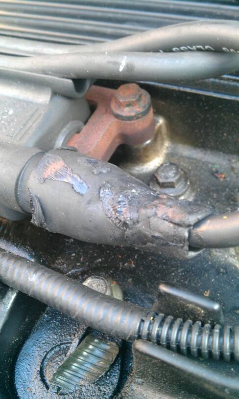

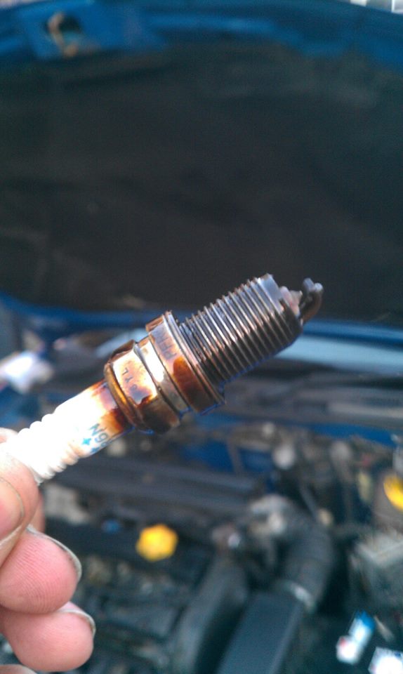

Changed spark plugs yesterday, however upon attempting to unplug the ht leads it turns out they had gotten rather hot and somewhat melted.
After getting the ht leads off we found some of the spark plugs with oil on them, could be from the oil change the other day/leaking rocker cover?

#54
oily spark plugs........bad news.
#55
Headgasket?
[Image: mcetg0.png]
#56
Generally piston rings or valve guide seals. Get someone to start it cold whilst you look at the exhaust then leave it idling for a minute or two then pull away. Any small puffs of blue smoke?
Could just be that when you removed the plug, oil has run down it but it looks liberally covered so i wouldn't bet on that!
#57
Those tyres leave them alone, you only like them cos they have race in the name, get something proper.
As for the plugs do me a closer pic of the tip and ill see what I can tell you
Or clean the holes properly and give the new ones a week and see how they come out.
