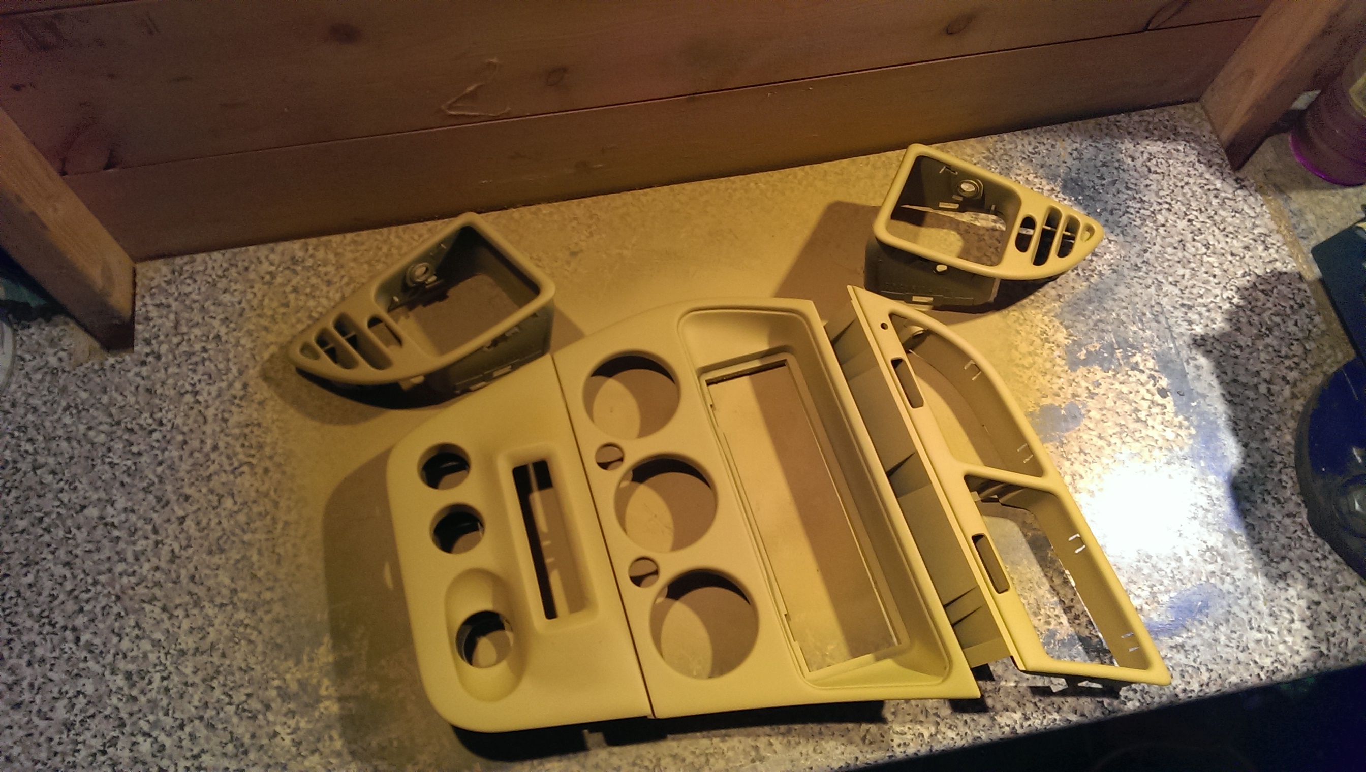

Dee, any chance of an update? I finally got mine wired into my ecu. Got two issues. Firstly, as soon as i turn the car off, i loose all readings completely. Almost like the battery has been taken off and secondly, i dont have a working range till empty. Still just get the 3 lines. Any idea? Oh and btw ive used the original facia for the screen and fixed it into the original dash
#72
Bad news on the range till empty, it's looking like the sender on the on the 406 work opposite to our cars, I still need to confirm this. I need to measure the resistance on a 406 when fuel low and compare it on ours. But everything else should work right if you follow the table.
Are you getting 12v on pin 1 with the keys out the ignition?
Fascias looking good.
