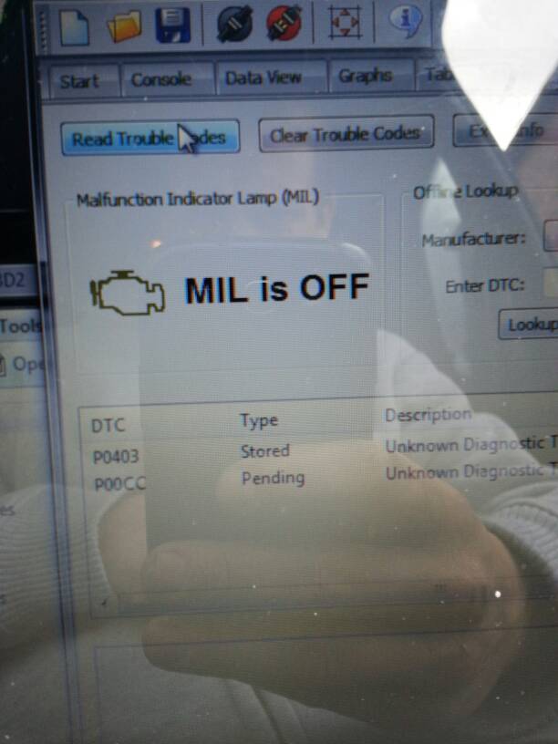

Right I clear the codes and am left with these

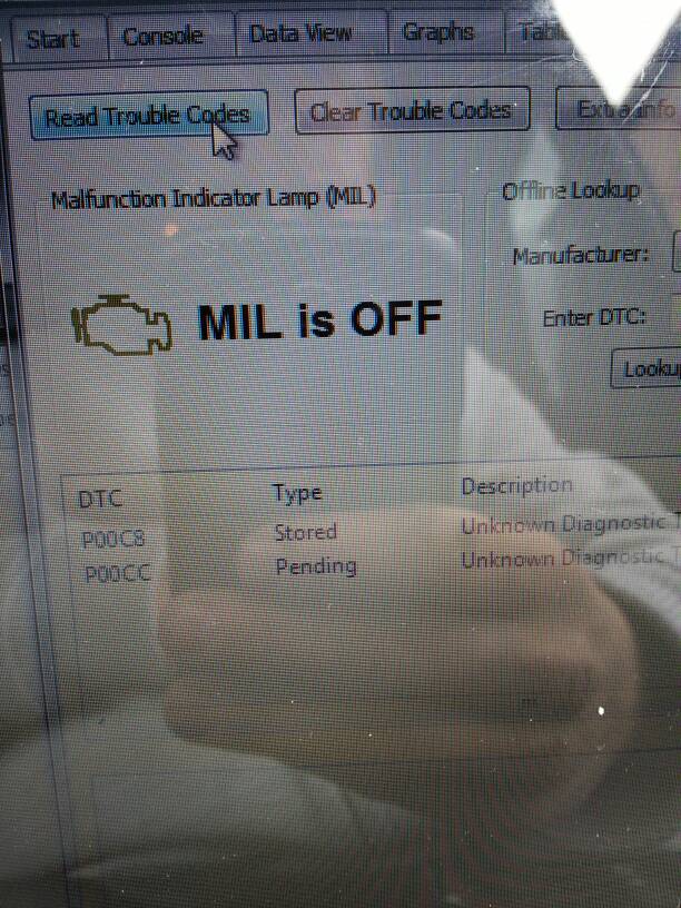

Then I try to start it and refresh the codes then get these
P00CC = P0204 which is an injector circuit code - but I've a feeling that software ALWAYS brings up that code..
P00C8 = P0200 again an injector circuit code, and again I've a feeling that's often detected by that software, cant remember the name of it, but a friend has used it on HDis in the past and I've seen that code time and again.
P0403 is an EGR code, so doubt it's that... Probably got your EGR unplugged and it's picked it up.
Yeh the egr unplugged so not worried about that. What do you think then ruan? Obviously the crank code isnt there now so cant be that?
Try a different software?
Might be an intermittent fault with the ckp, starting to see more and more issues with the looms on these, think they could just be getting to that age. Might be worth checking your injectors for the same, just to be sure. Maybe OT, but are you still running stage 2? Been about 2 years now hasn't it..?
