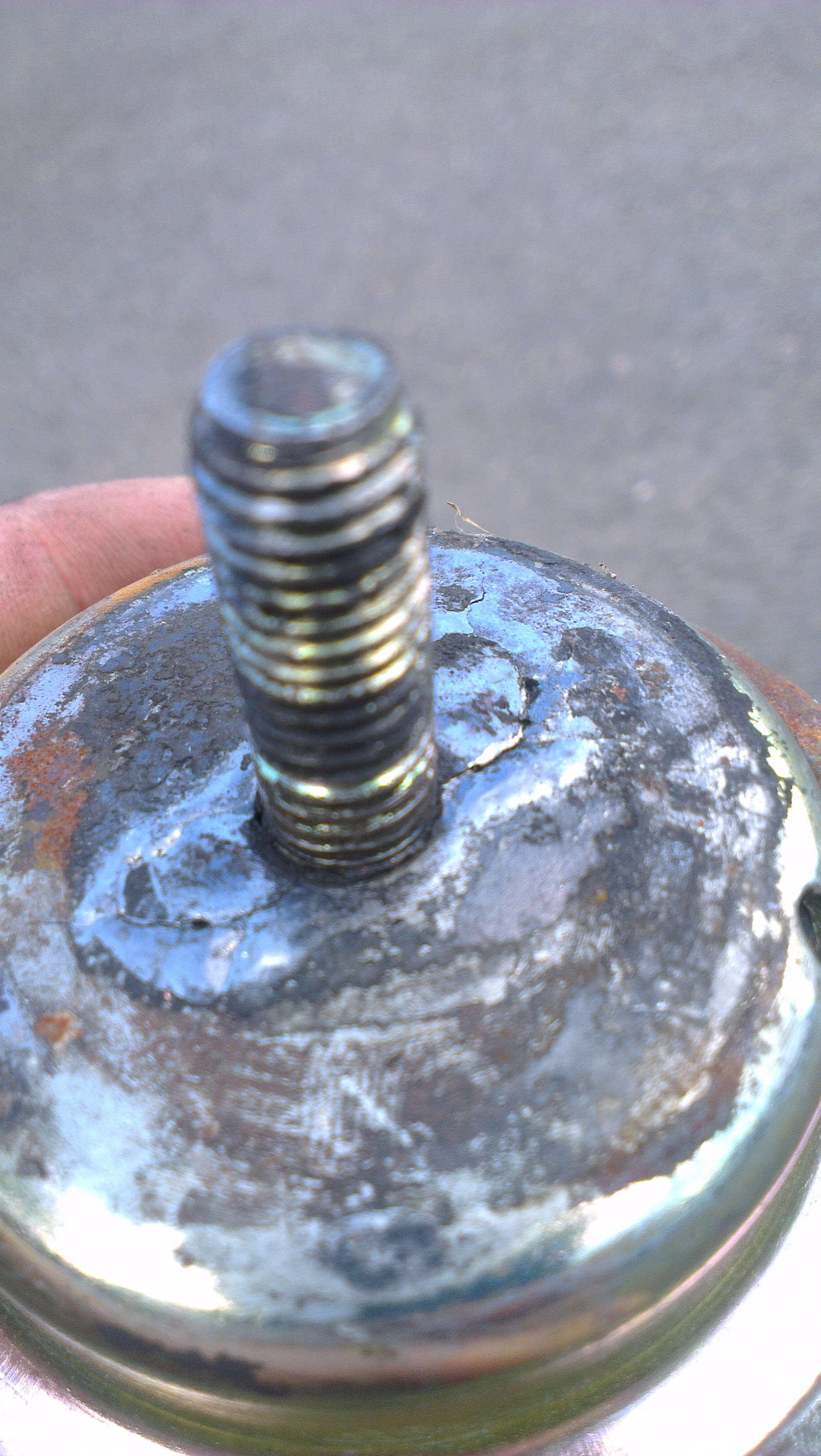

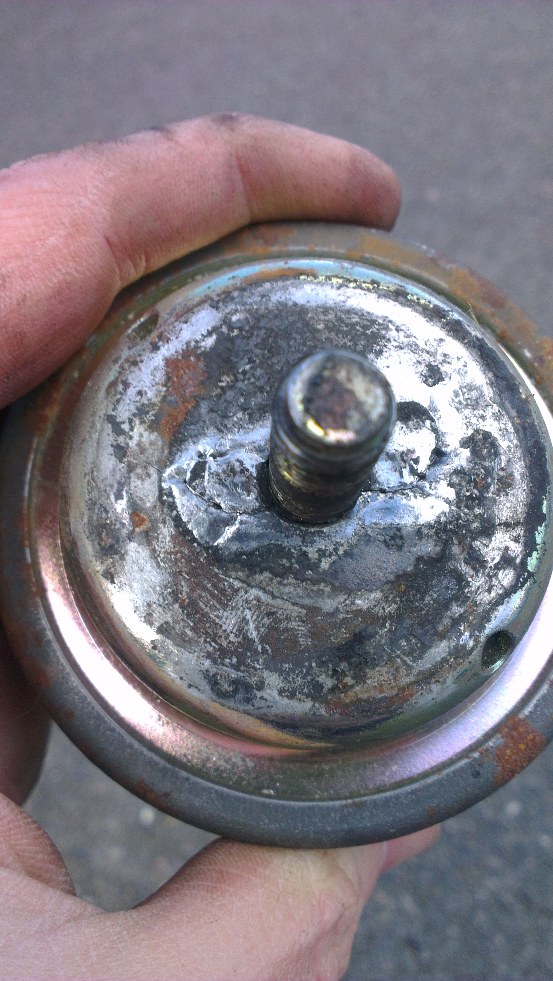

Out of interest, when I took the engine cradle off, the bbm mount was pretty loose. It was tighened into the bolt, but could rock backwards and forwards with relative ease. I then undid it to find a large washer underneath the mount (I can only assume it was there when I put it in originally??).
It looks a little like the mount is starting to break up too...
Anyways, the washer had been shaped (no doubt from the engine rocking back and forth), and was therefore preventing a good tight fit of the mount to the car so I left it off when re-assembling.
Pics of the mount, and the washer:
It actually feels heaps better with the bbm cradle, and believe it or not that clonk has gone...?!
