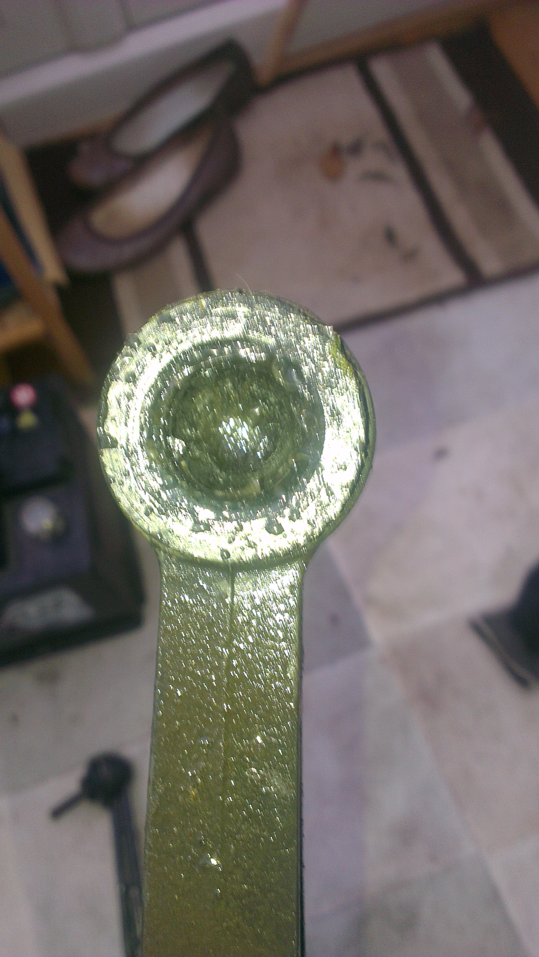

It started as a half-hearted "I'll take the wheels off and prod things with a 17mm" but when I took the passenger wishbone off, I literally just touched it with the 17 and this happened...
So from then on I was fairly committed!! Typically it had been dry until the wishbone broke... Then it literally pissed down! So I spent most of the time lying in a small stream which my carpark had turned into!!

2. There is a definite issue with the suspension. There is a clonk from the front-end, and i'm having to change my steering angle when accelerating/coming sharply off the throttle. It also feels quite unsettled and 'snappy' over bumps and when modulating the throttle through said corners... I'm fairly convinced it's the wishbones. Which if it is I'm pretty disappointed, as it's the meyle HDs which were only put on the car about 8k ago... not cool!
Anyone got recommendations on wishbones? I'll be trying to grab 5mins to change the wishbones over to Scott's old set, and if the Meyles are at fault I'll be sending them back as they should last a fucksight more than 8k!!

And it was never this twitchy. It was awesome, but I think over time the hubs have possibly become ovalled which has introduced some play in the ball joints, caused a hell of a clonk and due to changing the pivotal point on the road about which the car is turning, made it very twitchy
The top mounts do make a bit of noise occasionally but that's when the springs become nearly totally uncompressed. It's not the same noise by a long way!!

Back-end is twitchy, but every time I floor it, I have to correct the steering wheel, and whenever I come off the accelerator sharply, I have to correct in the opposite direction. To me that says something in the front suspension assembly is allowing the struts/hubs to move in the arches, which alters the geometry. It honestly feels almost exactly the same as when a P Bush had died in my old dt. Long corners are scary as fook!!

Yeah. I partially bought the drop links to see if it would cure the issue but tbh I knew already the clonk was too loud for drop links...
Hmm what shocks have you got on there on the front, nothing loose anywhere?
Now only a has been!!
www.autorite-sport.co.uk
(28-12-2012, 10:53 PM)Tallguy_2 Wrote: Hmm what shocks have you got on there on the front, nothing loose anywhere?
Thats a good point. He did have GAZ GHAs but now probably has a rusty bit of metal that flexes all over the place!
Such a Dick Niall Tongue
I have approx. 5k old gaz coilovers with spherical bearing top mounts. The clonk doesn't seem to be coming from the area of the top mounts, I'm pretty certain its coming from the lower suspension area...
