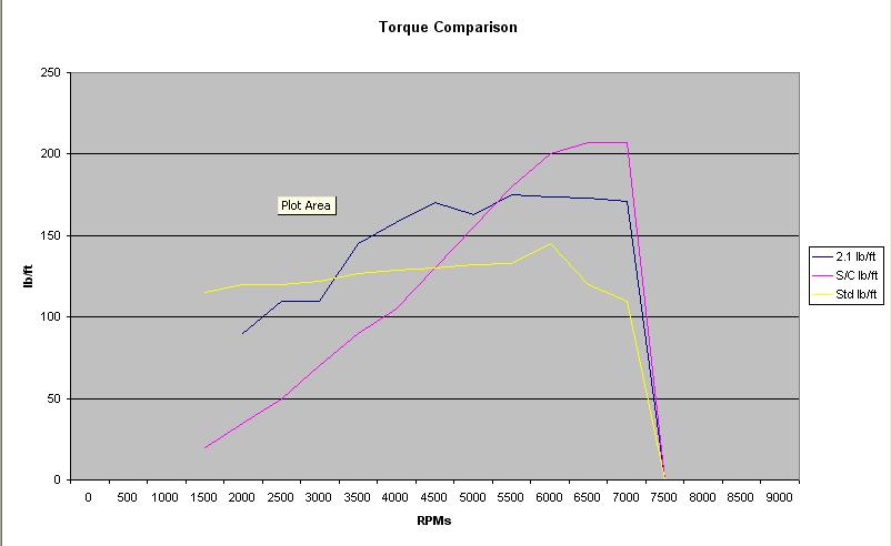

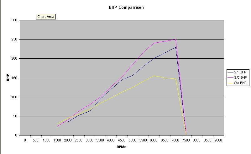

Anyway for comparison
.xls   GTi6 power comparisons.xls (Size: 28.5 KB / Downloads: 58)
This is based on the data contained in Petes GTi6 standard power graph and the 2 graphs below, the 230bhp is a 2.1 and the 250bhp is a S/C

Ill remind you that the S/C will have a bit more low down and mid range than a turbod car also the S/C is running a little more boost than the OP is talking about so making a little more power. If i could find one to do a 230bhp N/A to 230bhp boosted comparison but i reckon it would be pretty interesting.
Dum the low boost rotrex charger is shit low down, and as a general rule turbos have much more lower down than a charger, if sized correctly.
The lynx low boost charger isnt a great example of what you can achieve with that application, a bigger charger Like the 38-94 They use with the high high boostengines with a restrictor ring would be better For the significant increase inow down torque it privides.
either way a turbo properly sized is a step up again in torque levels all over the rpms
