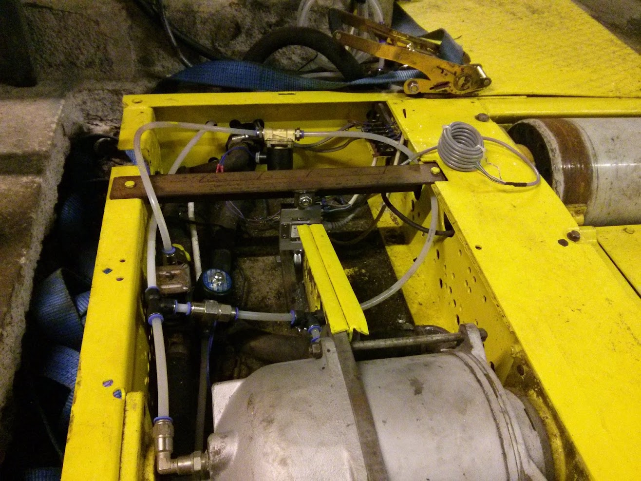

Decided to re engineer the "Torque Bridge" so that it sits flush and below the top of the dyno to help with clearances, and so that I can make a flat cover to go on top rather than a lifted one (not ideal with super low cars!)
So made up a new bridge and rose joint mount:
[Image: IMG_20150121_173032.jpg]
And in position with modifications to the torque arm also:
[Image: IMG_20150131_151516.jpg]
The more observant of you will notice a change in the load / unload pipework (yes its still a mess, this will get tidied / mounted properly at some point soon!)...I have added one way valves to the stator's outer housing pipes, so that under HIGH rpm full load, it can still add load via the vane (stator pressure rises above pump pressure)...I have also added a stator pressure gauge on the wall so I can monitor the load.
I have also added a "balance" pipe between stators, 10mm pushfit, which keeps the load left to right always the same, so if one brake fills / drains slightly faster or slower, the load is always equalized to keep the power balance as close to 50/50 side to side as we can!
Had to weld some extensions on the arms to keep the load cells in the same position (wanted to keep the same length from shaft to cell as stock so that the calculations were still correct and torque lower)
