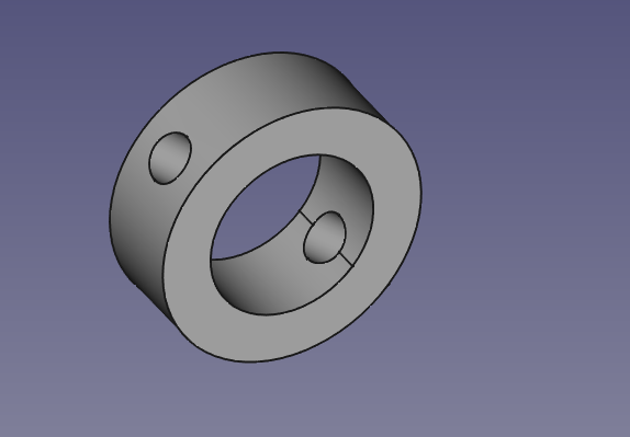

Injector mounting ring for 300tdi injectors:
diameter 27mm 10mm high and a 17mm hole, 5mm holes trough and trough with M6 in it.
Use the ring to drill 2 holes in the injector about 2mm deep (first dry fit to find out the correct placement and keep some extra room for tightening) and tighten the ring with 2 M6x12 grub screws, now you can use the Hdi's original clamps to mount the injectors. (with use of extended studs and taller bolts)
With the use of this ring you can turn the injectors around any way you want so you can correct the spray pattern angle to match the engine.

Could you use these if the center was machined out to 17mm?
[Image: F6918064-01_zpsp6ekhzab.jpg]
#98
Wouldn't try it, if it gets loose and the injector looses it's mounting pressure the flame will burn a hole in the head... (learned from experience)

Thats a good idea when i mounted mine i just bolted them in to start with and they almost immediately flew straight back out. Had to drill and tap the back to make a more solid surface to pull them down onto. Worked well. Your idea is far better though. However at the time mine was get in and go. As regards to the rotation of injector i managed to get mine to rotate what i though was "enough" may have will lathe me a set of these up for the new project at some point though. Some really good info on here. Wish you had started this earlier so i didnt have any research to do lol
Found an ready to go alternative: adjusting ring DIN 705/916
28mm diameter, 17mm hole and 12mm high, should work... (should save me some work if I found them sooner)

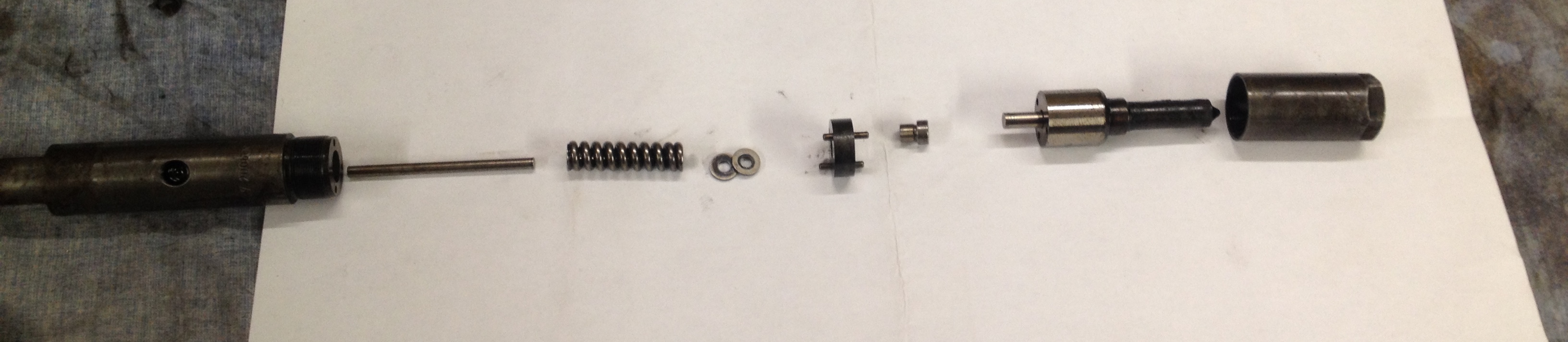

So the injectors, as wrote before I am using Land Rover 300tdi injectors, they are cheap and easy to work with and in stock setup they can handle up to 180cc (per 1000 injections) of fuel so that should be good enough for way over 200BPH.
But 200BPH is for sissies right? ;-)
We want to inject over 300cc of fuel so we need bigger nozzles, for that we choose DLLA144P144 which are used on Scania and MAN trucks, the main issue when choosing nozzles are the spraying angle (144 means 144 degree, original are 135 I believe so not to much difference) and the injector angle (the holes in the nozzle should reflect the correct injector angle else we will spray holes in the head or pistons the same way a water cutter does and believe me that will happen) unfortunately that angle is nowhere to be seen in the docs so that is trial and error...
Another thing according to nozzles is how to rotate them when mounting, these nozzles have 5 holes in it and since the injector is mounted under an angle you have to watch the position of the holes and rotate the injector when mounting to match it all up.
There are 2 ways to get a working injector, we can choose to either make a one-shot injector set at say 320bar that makes a hell of a bang but has some troubles running idle or we can follow the 300tdi injectors 2-stage injection setup:

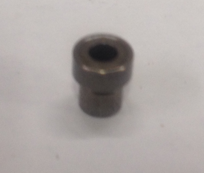

p.s. if you want a single shot setup you can use the bushing from a DW10 Siemens piezo injector instead of the LaRo one, needs some mods to the rod use for the first spring so both the first and second spring are used at the same time but I won't describe that so you have some room for your own skills... ;-)
Over here a 300tdi injector in pieces:
Over here we see the 300tdi nozzle, the needle in the nozzle is the same hight as the nozzle so the bushing is limiting the needle movement.
The chamber in the inner part part of the bushing is 0,03mm and the part itself can move 0,27mm in the bushing so we have 0,03mm lift@200bar and a total of 0,3mm@300bar.
Over here our Scania nozzle which is single shot and a different design, the needle has a little rod on top which normally sits against the spring and the needle top itself is 0,3mm lower then the nozzle so the total needle movement is limited to that 0,3mm which is the same as with the LaRo injectors.
Since I want to copy the LaRo setup I have to remove the little bar on top of the needle and cut away 0.3mm of the top of the nozzle so needle and nozzle are lined up.
