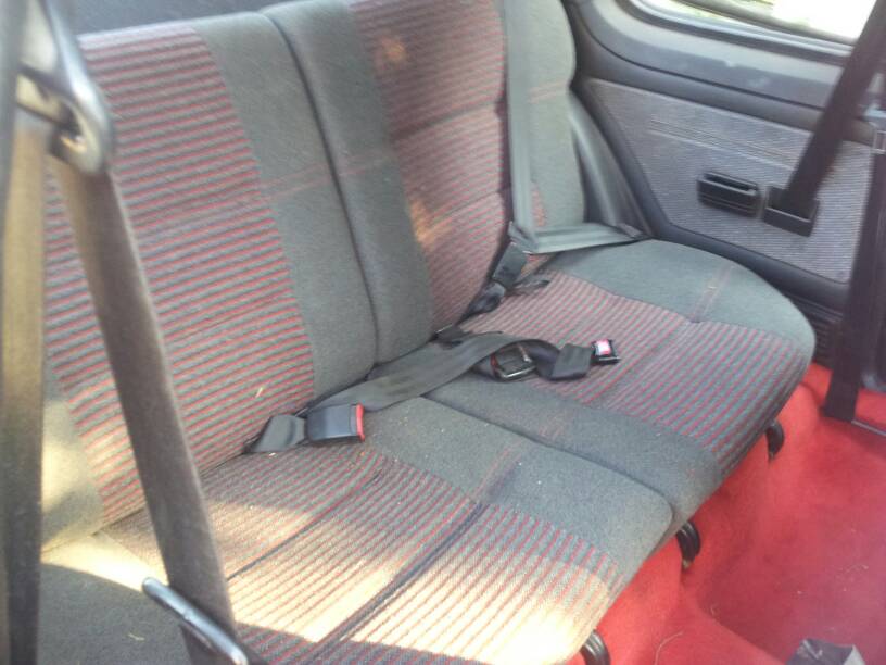

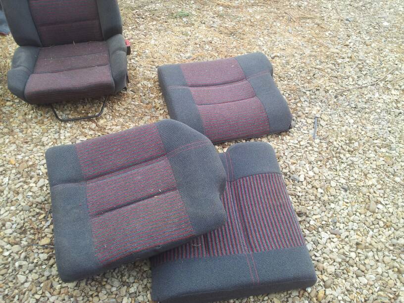

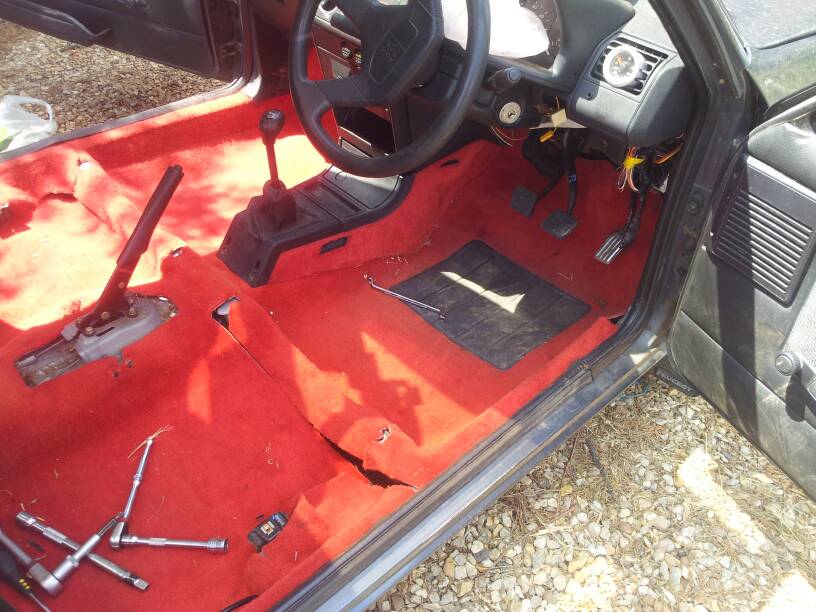

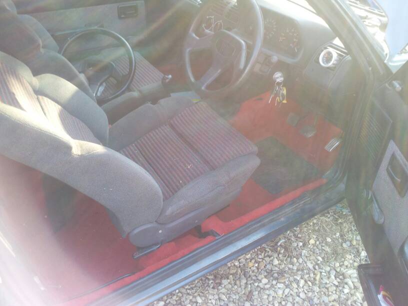

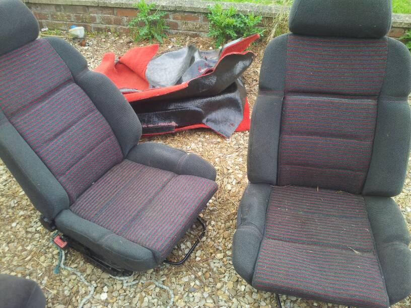

Decided to make a start on the interior today putting in the seats out of the cti I had
Also I had a red carpet aswell
Looks so much tidyer now as the old interior was light grey with alot of oil stains as it looks now
Also got a better condition steering wheel to put in and then a little bit of welding then should be good for an mot

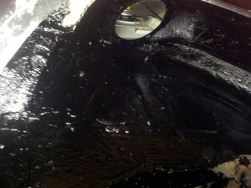

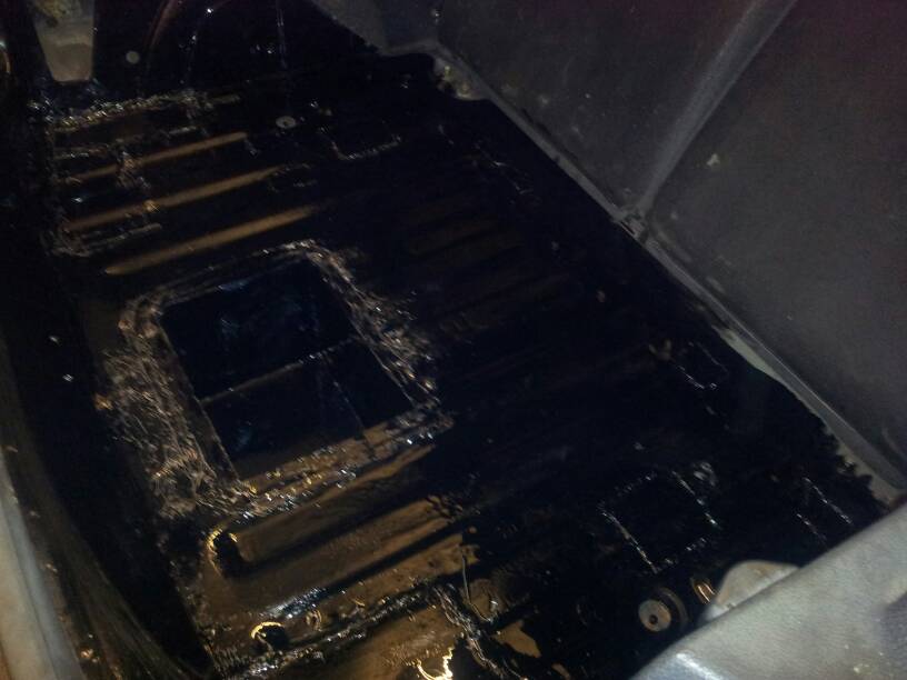

Bought a tin of underseal today for once the welding in the boot has been done. Hopefully will be enough for a 205 done my mates mk2 golf today and need to get another tin lol

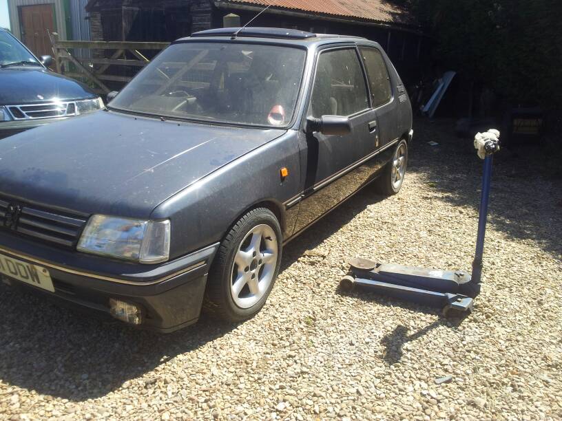

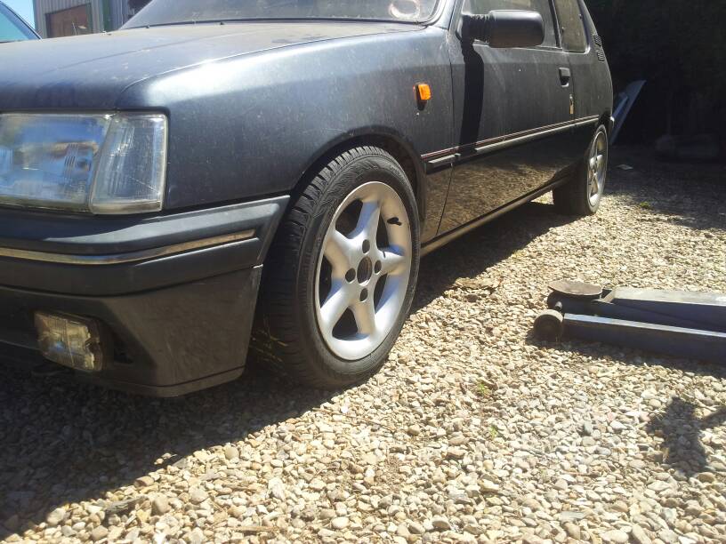

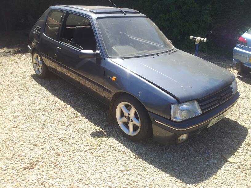

Dont thinknthe alloys look to bad but u cant beat 1900 gti speedlines on a 205
Posts: 866
Threads: 61
Joined: Dec 2011
Reputation:
4
Thanks: 0
Given 6 thank(s) in 5 post(s)
Yea I know what you mean I am going to keep the speedlines but they rub alot atm with the tyres they have on and also I have had to put on some gti hubs to fit my brakes and the tyre comes further out than the arch lol. The plan is to just mot it with these wheels and go from there realy they only have 165/65's on so dint want them on to long lol

My speedlines rub, too. I'm running 185 rears and 195 fronts. The rear scrubs on roundabouts and the front does on full lock.
Posts: 4,926
Threads: 266
Joined: Dec 2011
Reputation:
18
Location: Somerset
Car Model/Spec: 205 DTurbo
Thanks: 73
Given 7 thank(s) in 7 post(s)
My speedlines don't rub at all - ever. 195 all round. Thought that was normal?
Posts: 10,864
Threads: 117
Joined: Dec 2011
Reputation:
119
Location: Southampton
Thanks: 13
Mine don't rub either, are there different hub assemblies for the GTi's/stdt's or something?
Posts: 866
Threads: 61
Joined: Dec 2011
Reputation:
4
Thanks: 0
But I have lowered mine a fair bit though the speedlines have 185/55 on them also poodle dont you have a stdt so your arches will give you a bit more clearence.
I had to swap the hubs on the 205 because I changed over to 306 247mm discs and calipers as I had them in the shed and when I put the discs on the hub it wouldnt sit right because it hit the bracket that the caliper bolts on to and the gti hubs stuck out a bit more so the disc would fit on right

Yea I think I would need some 195 45's of I put 15's back on
Posts: 1,804
Threads: 129
Joined: Mar 2012
Reputation:
11
Thanks: 0
Given 0 thank(s) in 0 post(s)
I've got a 309 rear beam (wider) and banded steels with 175 60 14's and it sprayed really bad at first so I had to roll out the arches. Stock beams should be ok with most wheels depending in the tyres though

Ah i see, fair enough. I do love the comedy arch gaps on these as standard, didn't realise it was actually cut away further on the stdts/gtis.
Don't think those alloys look bad tbf, something different anyway, which is a nice change.

I really like those current alloys as you say it does make a change from the usual speedlines ect.
People always say I should get speedlines but every other 205 has them now.

Yea these wheels do look better than I thought they would lol. No not going to fcs this year Im working and having to save for my holiday  definitely next year though and also this will be on the road aswell.

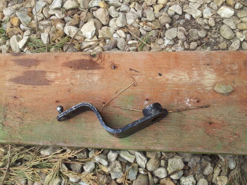

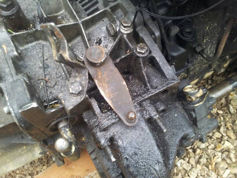

Few pics of the gear selector I had to change over to run a 1.9 gearbox for td_dan
The 306 selector that had to be replaced.
The 205 one you need to use. Hope this helps mate.

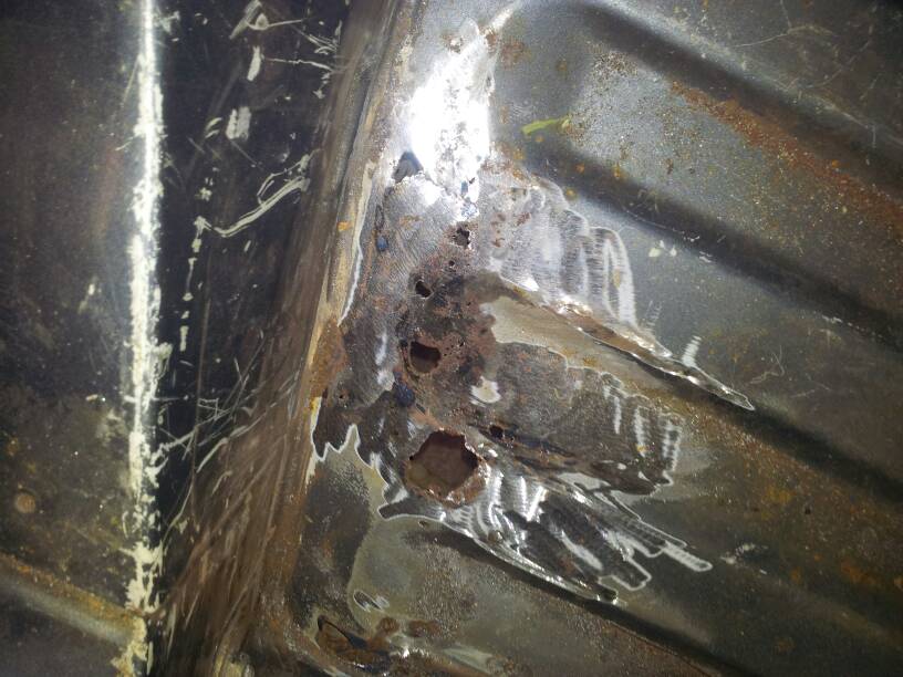

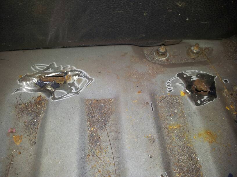

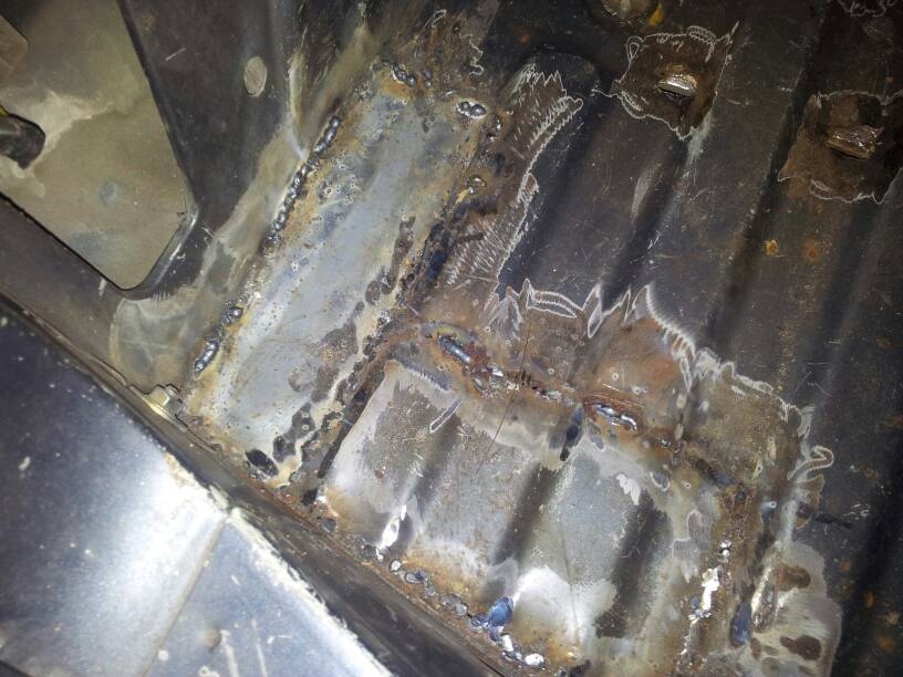

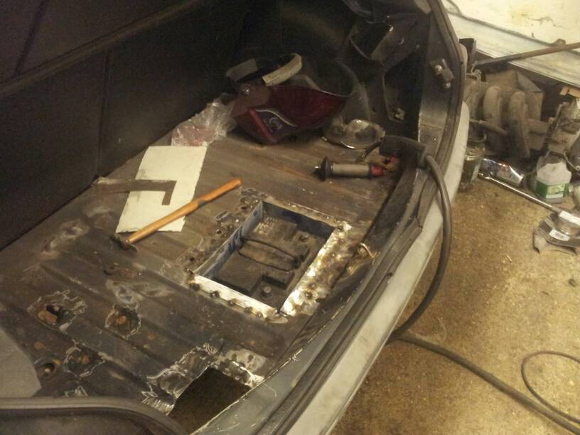

Got all the welding done on the boot floor and painted it black.
Next job is to clean all underneath and underseal the whole underside and in the wheelarches then relocate the battery in the boot

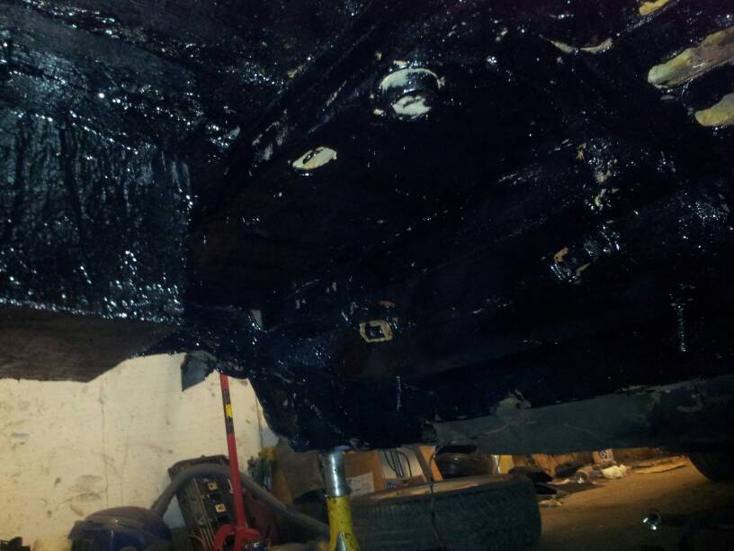

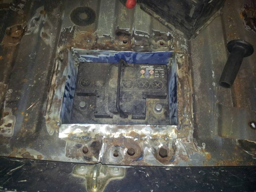

Been working on this the last couple of days got all the welding done axle off again and painted up to make it look a bit tidyer also got the diesel tank off and undersealed the underneath of the car and rear wheel arches
Just need to wait for it to dry and then put it back together and then I can fo the front end aswell

Mmmm love that stuff, it's not the cleanest but does the job and is bloody cheap! I have 5L exactly like yours for the 200 & 205!

I think you would have to get some more I have done the boot floor where the petty tank is and both rear arches and have used about half a tin lol. Yea its lovely stuff I got it all in my hair all over my hands and face and I cant get it out lol. Was quite well prepared with gloves, sleeves and a hat aswell

when you changed the gear selector over, does that shaft not try and drop into the gearbox?

No mate I didnt have any issues with the selector dropping down.
