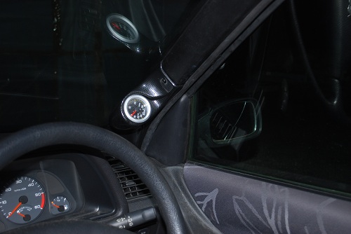

The novelty of having a boost gauge held in by gaffer tape got a bit old, so I got a nice new home for it.
#64
schaweeet!
i wants one Big Grin
#65
Better mind you dont blow the welds on the intake manifold with that boost gauge there y0

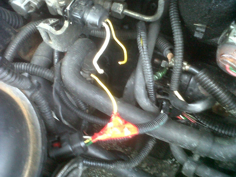

(26-06-2012, 09:14 PM)c.gerrard Wrote: Well, this is the state my car is currently in Sad
I thought whilst engine work needs doing, might as well take the opportunity to refurb the front and rear bumpers (and no i did not undo the bolts for the side panels thinking that they were for the bumper before you ask), there's a knackered hockey stick so that will be replaced as well, as well as as headlight that needs re-sealing (Jonny's fault!)
With a lot of help from Jonny, we got the Bosch pump fitted, which took longer than expected as the pulley bolt put a massive fight, bent one too many tools, so went and invested in a breaker bar Smile Just need to get an injector socket, fire seals and fuel injector hoses and then job done. The actual pump needs to be put back together properly, as Jonny thought it would be good a idea to take the head off and learn about the pump at my expense (DICK!!!) The issue is a sudden burst of power, instead of it being built up graduadly.
Hopefully that will sort out the massive white smoke I've been having, the car certainly starts a lot better than it did before. The timing of the engine is spot on, there was some initial excitment of thinking we found the problem, realised we were 180 degress out, turned the engine over a few more times and it was fine! Will have take it from there and if there's still smoke, the only major thing it could be is the head.

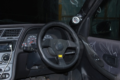

OMP Trecento 300mm:

Steering wheel looks awesome! !
#69
(09-01-2013, 07:37 PM)Jonny81191 Wrote: Steering wheel looks awesome! !
Very nice indeed.
How do i go about getting one of those in my car?
Does that thing in middle come seperate to the steering wheel?
#70
Its pretty straight forward.
Choose a steering wheel. Then buy a boss, you can either pay £50 for genuine ones or I got mine for £20 from a field somewhere in Bulgaria lmao Then it's literally three bolts!
The bit in the middle comes with the boss.

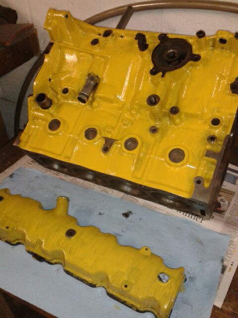

Not a great deal to report of late.
Got my engine back from the workshop during the week, so I've got a bit of a mad rush on to get that built up in time for the Nurburgring.
ITS YELLLOW!!!!!!!!!!!!!!
#75
Yellow is win.
#76
Mmmm, what could it be this time???

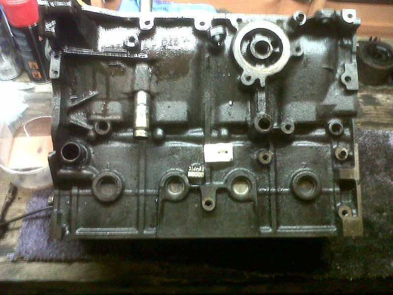

So had a bit of a shitter tonight.
Basically doing a complete and utter re-build, had quite a lot of work done, will do a proper right up when it's all done.
Everything was going well and then we noticed piston 3 was sitting flush. Grrrr.
Measured the rod and it is shorter than the rest.
Sodding thing is bent!!!!!!
Ahh well, trip the scrappers tomorrow and hopefully will be able to pick up some new ones and this time inspect them all thoroughly lol
#82
Just got home and put the offending rod on a piece of graph paper, it's like a f*cking banana!
Ah well, at least we noticed Big Grin

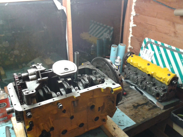

Fortunately managed to get a set of rods from the scrappers this morning, tenner for the lot lol
So after a few issues along the way, the block is getting there. Rods, pistons, new bearings, oil pump, flywheel, clutch all been done.
Plans for tomorrow are to get sump on, get all the ancillaries sorted, bosch etc. Will have to wait till Monday for my head gasket/bolts to arrive and then that should be the block sorted.
Will also have to make up some turbo adapter plates, fit new brakes, '6 ARB, the list goes on Big Grin
I'm a bit pushed for time now, as I'm off to Scotland on Thursday, so basically got tomorrow and three evenings, to build an engine, fit it and get everything sorted. But with the mighty Jonny on my side, we should be fine Big Grin

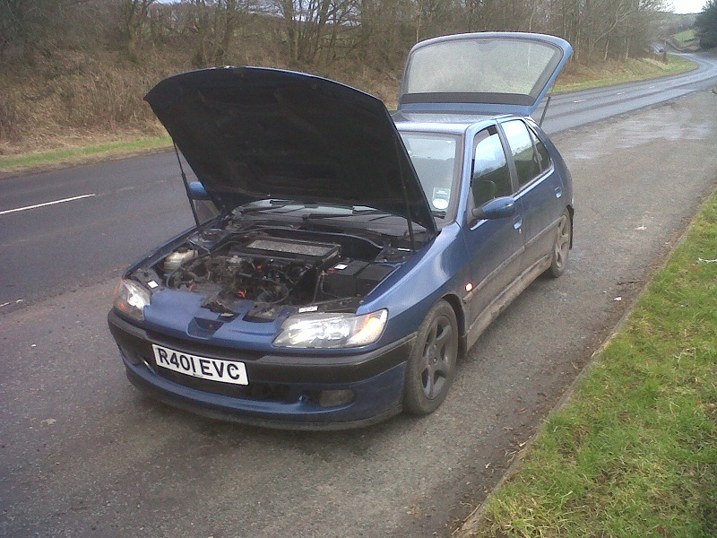

So this is the situation we're left in:
Fitting an engine in a blizzard, how's that for commitment lol

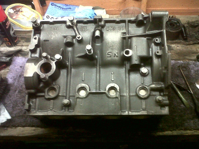

And just because I'm a photo slut, that is how clean the back of an XUD should be Big Grin
