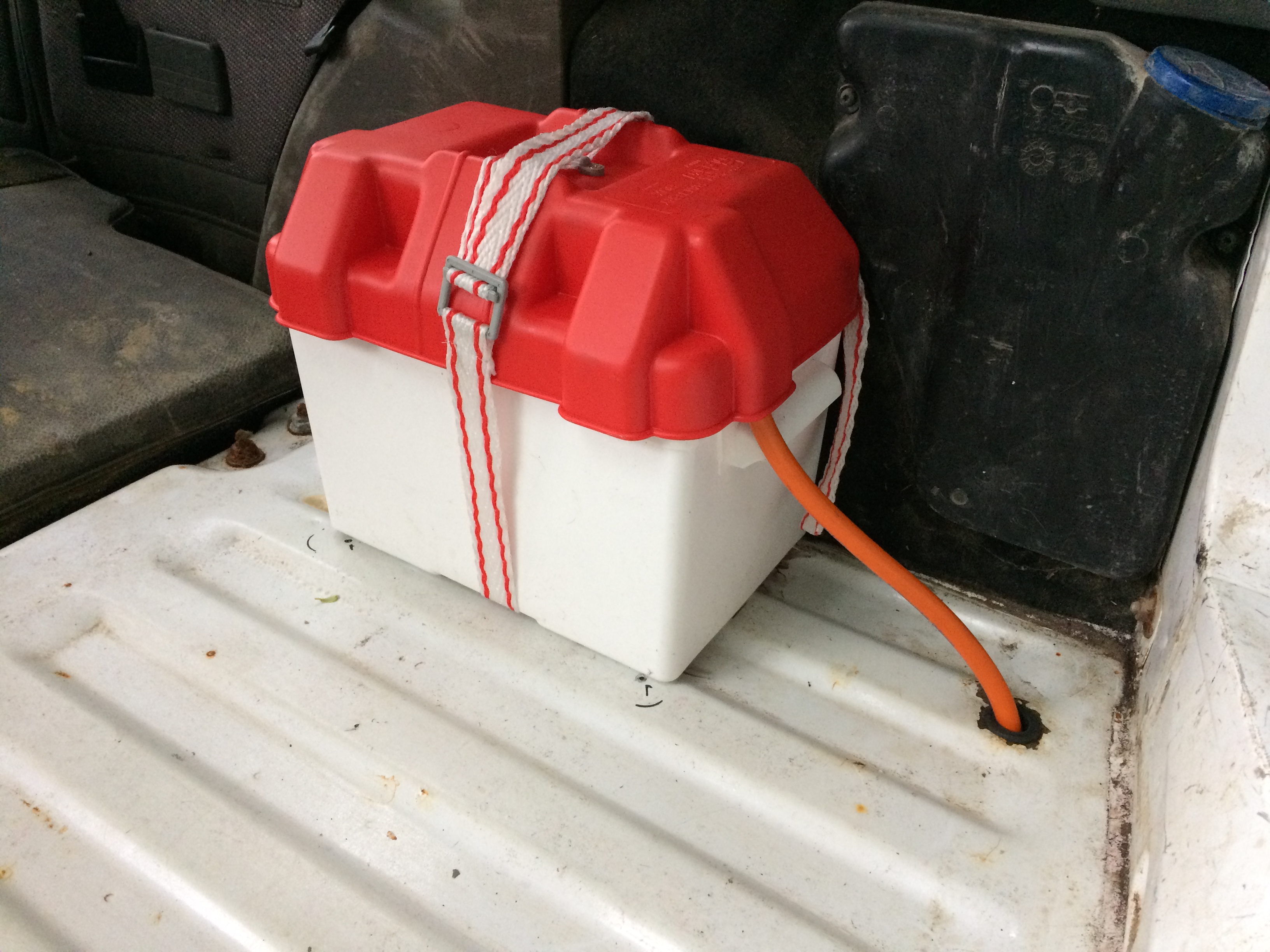

Purchased battery box and measured up how much cable I'm going to need.
Went to a local chandlery who sorted me out and will be making up the cable tomorrow.!
Also, chucked in some break fluid, checked all nipples were free, which they were. Then tomorrow will wait for the mrs to join so she can pump...

Bolted down battery box, drilled hole for power cable and fitted grommet.
And got hold of my cable with the spades fitted at each end .
