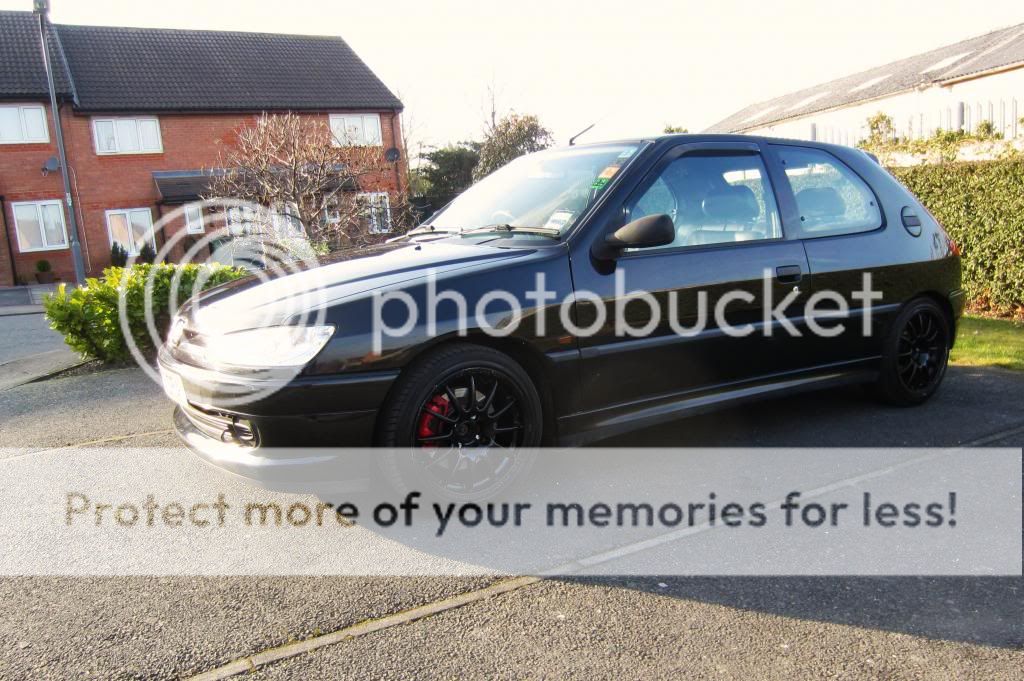

Not a fan of black cars with black wheels, but I actually quite like it now.. Would still be better silver though.
[Image: a0e69c78-576f-44cc-9071-a08f8e8539a9.jpg]
Rubbish picture, its not clean enough to deserve proper pictures being taken Smile

All you nees now is a ph1 front end and a green bonnet ad itll be like mine was lmao does look good though chap have you built the 10mm pump yet?
#87
Would love to phase 1 it, but I don't like doing anything that includes removing/re fitting body panels because I am rubbish at it!
Your old pump is sat on the work bench next to the 10mm donor pump, hopefully Sunday it will be built up. Not sure how long it will take though..
