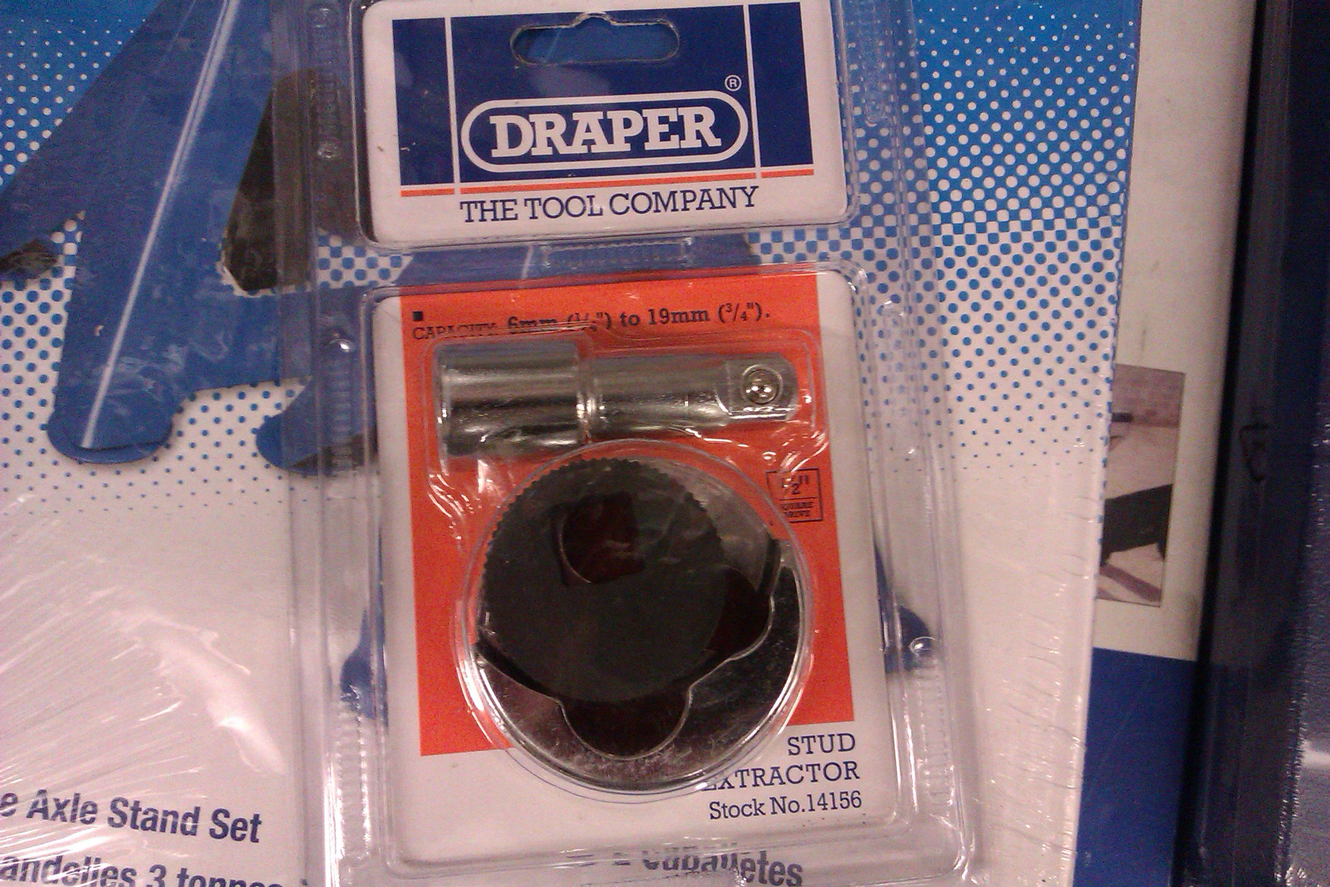

Right, were stuck again!! Need a universal stud remover.....but can't find one in halfords.....any idea where we can get one??
#43
motorfactor. pretty sure gsf sell em
or, two nuts, lock em together on the stud and use a socket or bfo spanner
#44
^^ thats a good idea! Ill have a rummage and see what i can find! Only 2 weeks left to do this in D:
#45
I tried the the 2 nuts locked together and that did'nt work! had too much threadlock on mine, 2 weeks left! ive already done mine Big Grin
#46
Its not really 2 weeks if sam want to use the estate for Uni..........I bet there'll be more stuff needs replacing when we can finally drive it lol!!
Also still dont have a stud remover lol...............
#47
I found this in the motorfaftors.....think its the right thong...but its 18 quid!? There must be cheaper ones about surely!
#48
Ebay it £8
#49
Can't wait for ebay postage really..........however, I have just found this at the 'other' local motorfactors I always forget about lol....it's next to 'The Golf' pub....time for some photos while Im there then. Big Grin
http://www.bennetts.com/bolt-and-nut-rem...801966.php
#50
Just my luck, they dont stock it!!! Sad
Can order it....for after 2pm tomorow, well thats really useful! Undecided
So now the option is to spend more on the one pictured above, or to order that one but wait longer....we were supposed to be doing this tomorow morning you see. Hmm...... Confused

However Ive now bought the more expensive one (Sams paying lol) so we should be cracking on with this tomorow! Try to at least get the box and clutch off if nothing further lol. Smile
