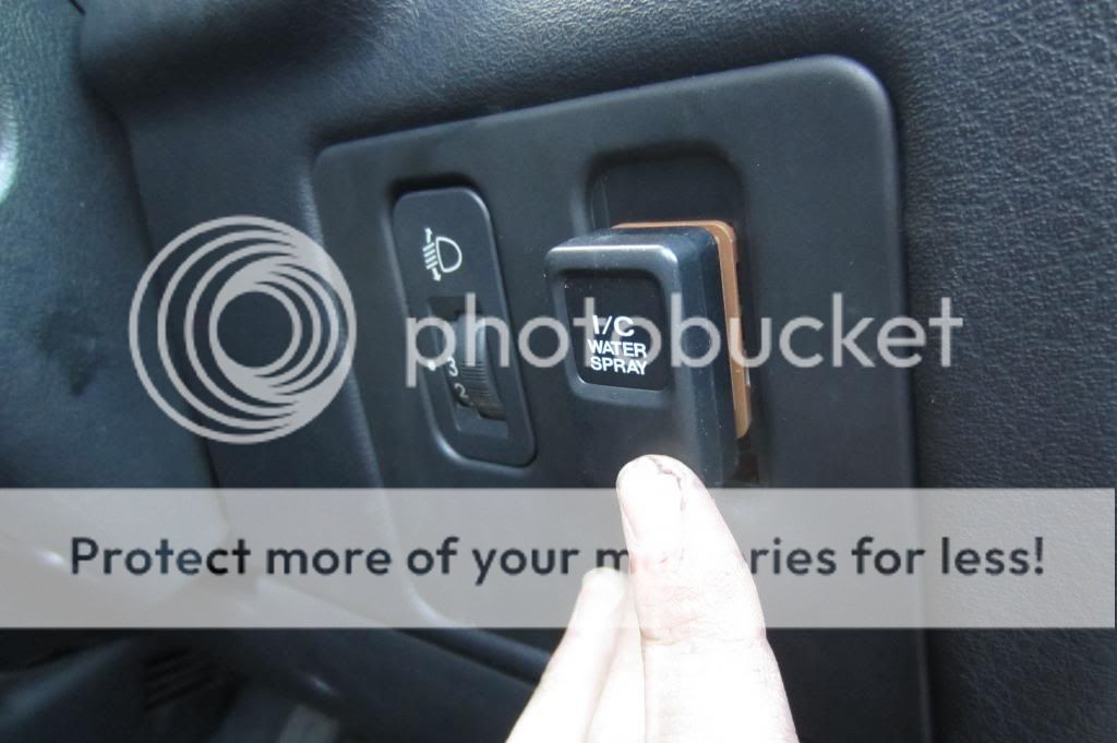

Found a nice little space for my intercooler spray button Smile Will make it flush when I actually need to fit it, once I have built up an intercooler spray! Plus an intercooler to spray..
[Image: IMG_1190_zps2beb5e62.jpg]
Turned down the max fuel today, going on the dyno on Saturday hopefully, and the way it was, the EGT's would have been up to 1000 degrees easily. So now it's slower, pulls pretty well still but I doubt it would be over 130hp. I don't care though, still fun to thrash Smile

Thats cool Smile make it your selft dude?
#37
The button? No, its from a Subaru I think
