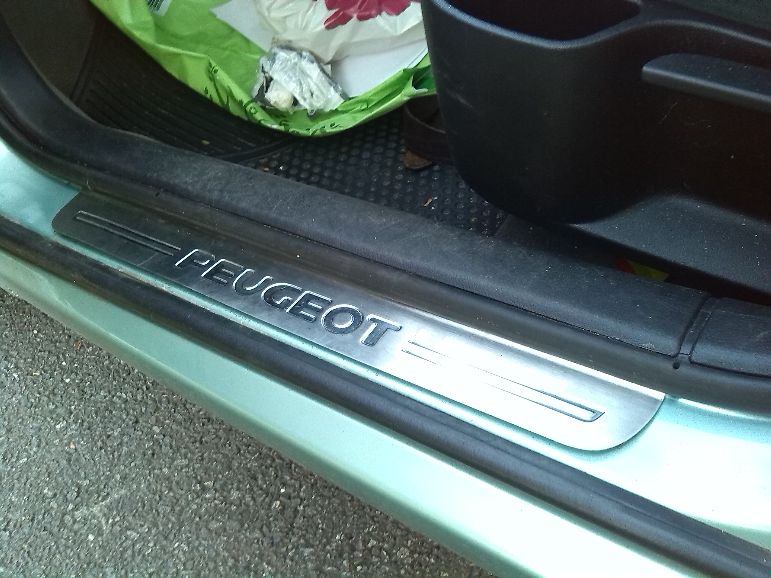

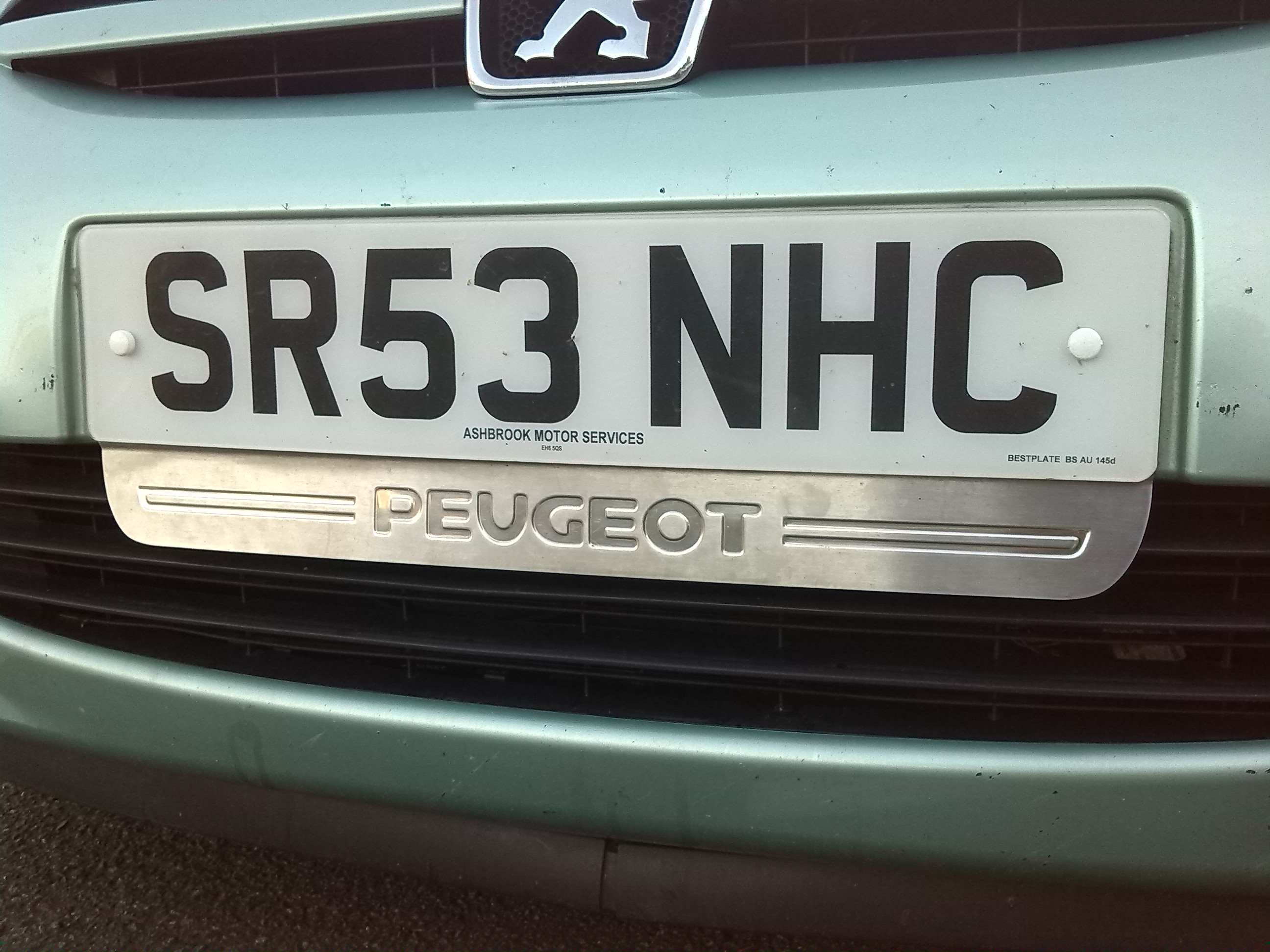

On the subject of repurposing parts from other models, I just picked up these brushed stainless sill guard step plates from a 307 xsi 136, intention is to go on my SW sills but they're nice trim pieces and could be fitted elsewhere!
For example! Could easily be drilled out for l.e.d.s
#54
They work number plate doesn't look to bad I'd be scared of losing it tho and I'm not sure about the visors tho the wiring would be easy enough interior light to mirror
