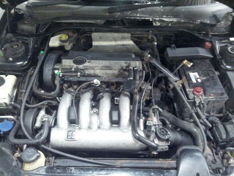

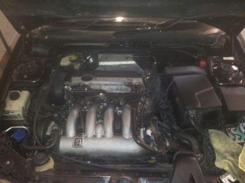

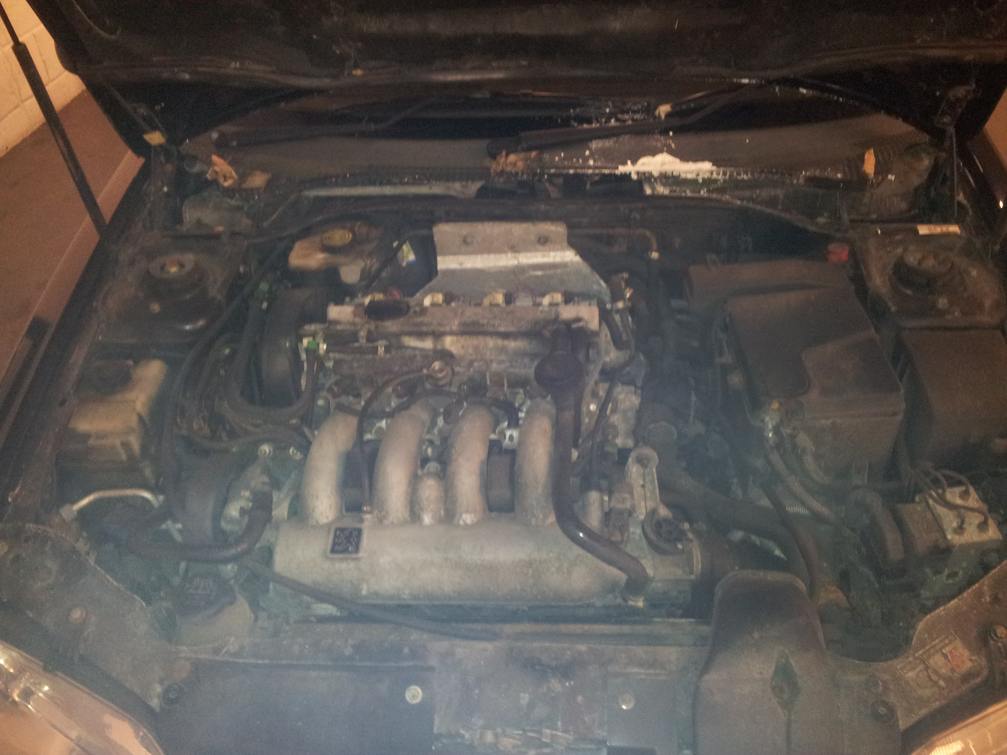

Started on the engine clean up been at it a few days now and i am sick whistle
Before
During
After
It still looks a bit shit. So time to take remove the inlet manifold and have proper degrease and a lick of paint me thinks cam covers will be cleaned and prepped and painted

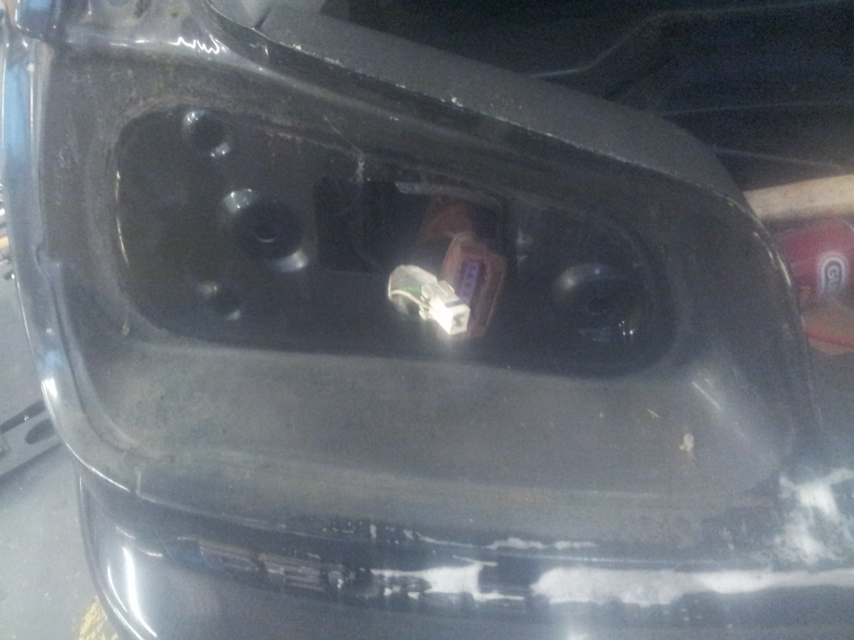

Oh and a quick picture of the muck behind the rear lights

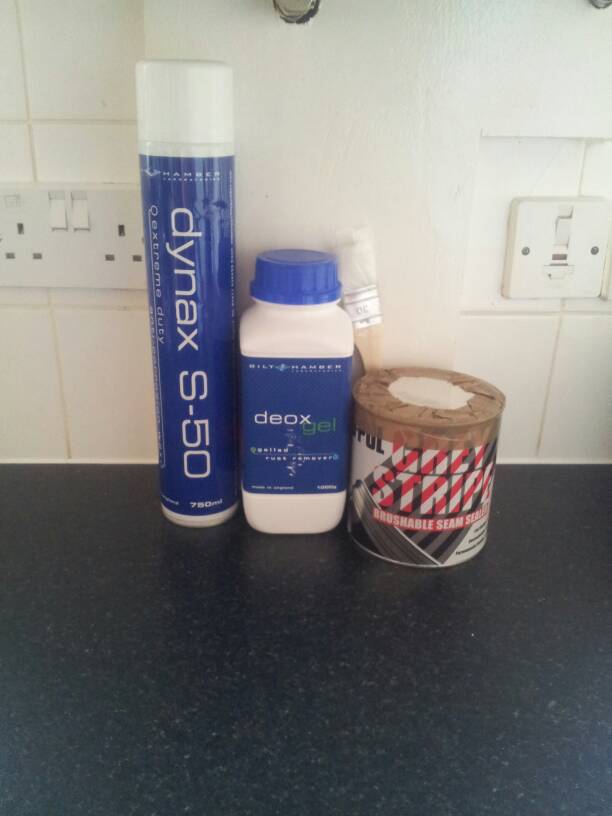

So I will be using the following products
Bilt hamber detox c
Bilt hamber detox gel
Bilt hamber hydrate 80
Bilt hamber dynax s50 anti corrosion wax
U-pol seam sealer
Acid etch primer
Black hammeright

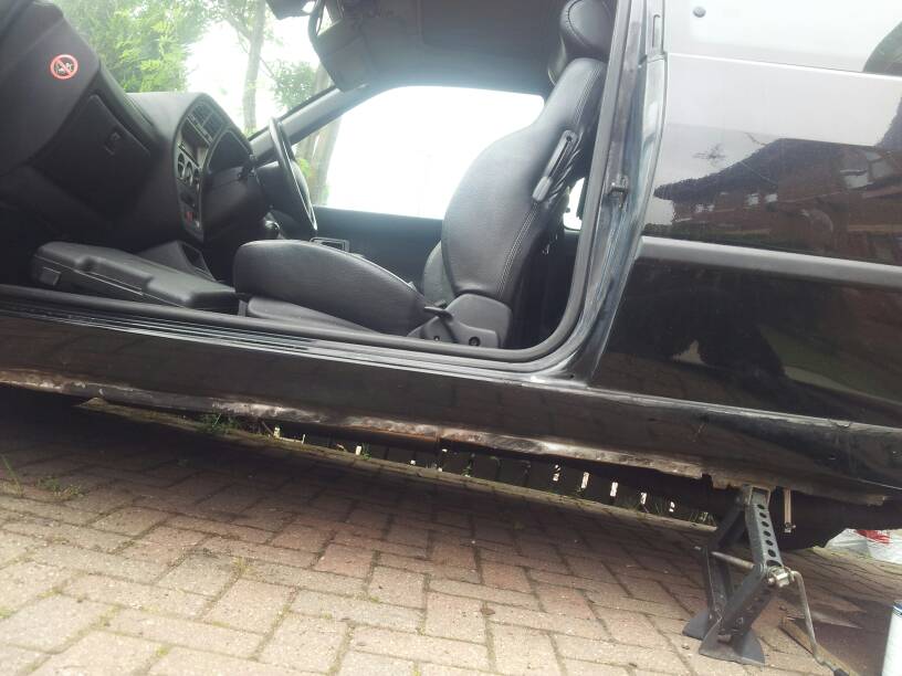

So with nothing to do at the weekend I thought I would get cracking tyding up

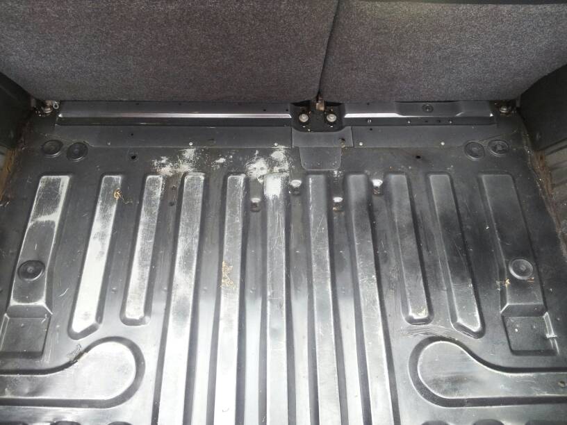

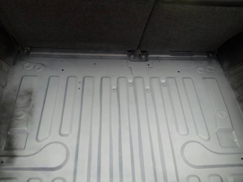

Bit of a tidy of inside boot floor

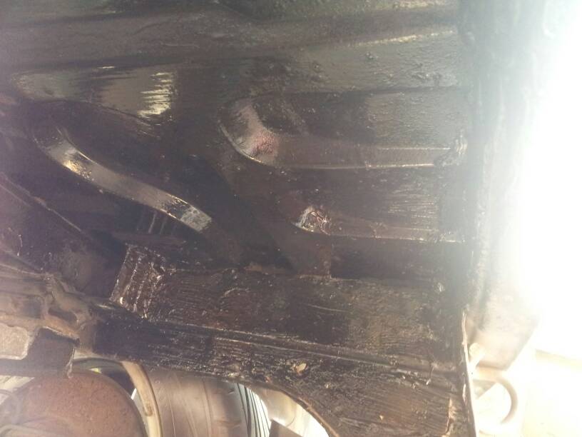

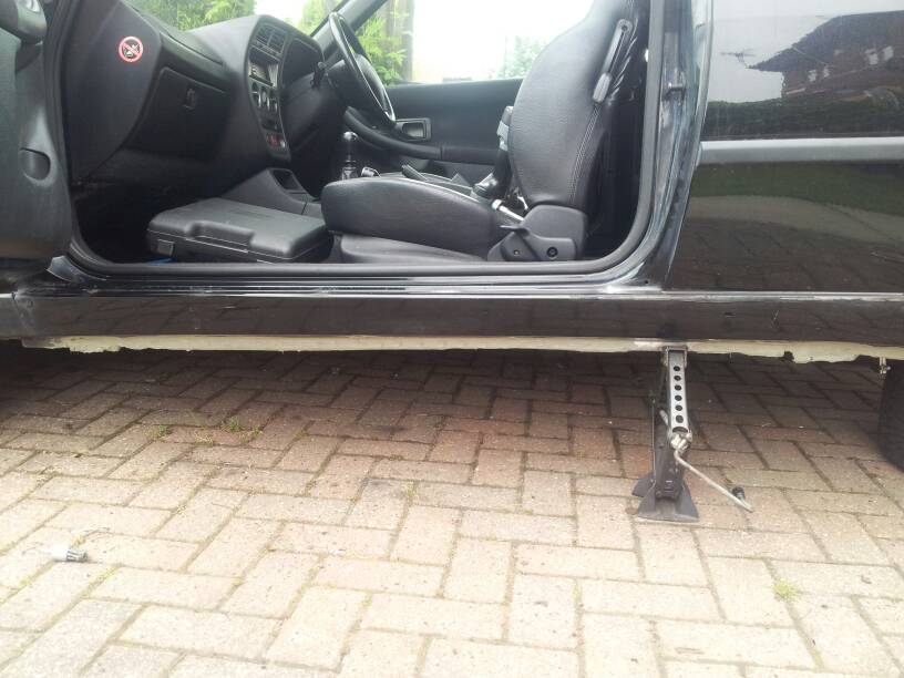

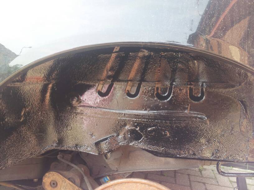

Side skirts removed rust treated with hydrate 80, etch primer,seam sealer, black hameright
Rear arches gave the same process

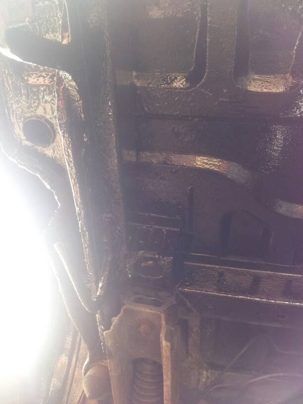

Also gave the underside a bit of love same process as above
I also found this down the fair on sunday those under 30 will have no idea what movie its from lol
Exhaust off today & follow on the process working my way forward
#44
I've done the under side and rear arches like you have. I need to do the sills though before I put the side skirts on
