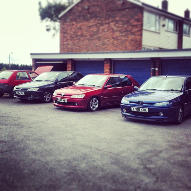

Stolen off le bookface. Thanks Ginge x
[Image: 9062412990_c17cc2d435_z.jpg]
Untitled by 306ep, on Flickr
Looks sooo much better. looks like a very similar height to mine,
You ready for that SP spoiler yet?
