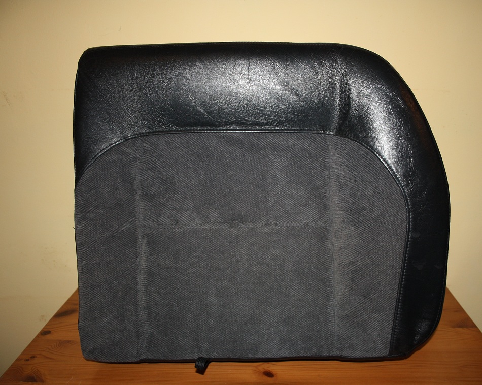

Well as the car is off the road with head issues at the moment, I've started on my interior, just done one of the back seat bases to begin with, but it's all in bits now and the new fabric should arrive at work tomorrow, so with any luck I should be able to sew it up at lunchtime and get some pictures of it fitted tomorrow evening Big Grin

Here we go! Looks epic, just need to finish sewing it together on Monday lunchtime, then re fit it Big Grin
Are you a seamstress or something!!
I get pissed of sowing my name in my socks Lol!!
Haha basically yeah. I work at my dads company. We make rucksacks and outdoor equipment, bit of mountain rescue and military stuff too.
Jonny if this looks good, i will have some work for you!

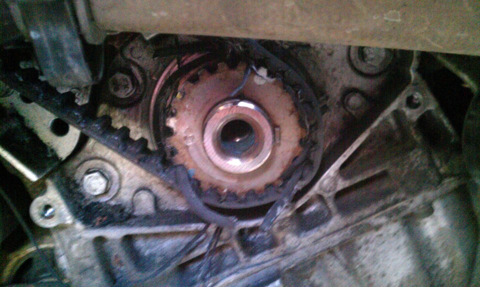

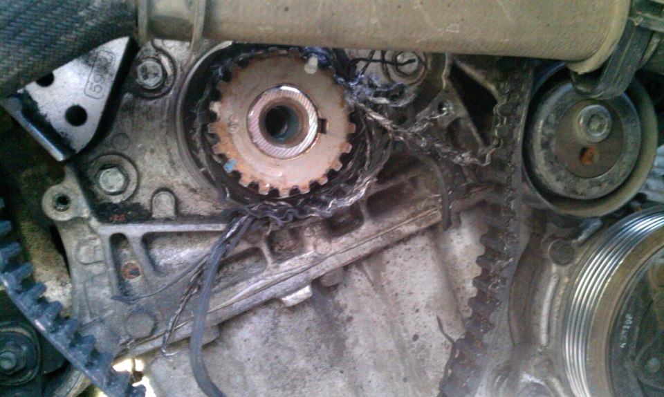

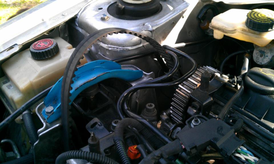

So I went to Europe and this happened..
Basically, in a tunnel in Lyon, the aux belt let go at 5k, and went into the cambelt, round the bottom pulley and caused the belt to slip several teeth, mashing the valves into the pistons. Broke half of the rockers, so we attempted to get it running on 2 cylinders, which failed Sad
So I've finally got the beast back home via an epic road trip in a flatbed to go and get it back into the UK (Big thanks to Vaughan and Fooby, top lads!), then used my AA relay to get me back from Fooby's.
New engine is going to be picked up this weekend, and will be fitted on the bank holiday weekend. Then, once I've rebuilt the current engine as a spare, we'll see just how much fuel I can get in before something melts Big Grin
