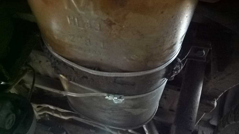

Repaired my exhaust with my favorite bodge, a giant jubilee clip. The exhausts on these are really heavy and always seem to break there so the clip will hold it for a year or 2.
