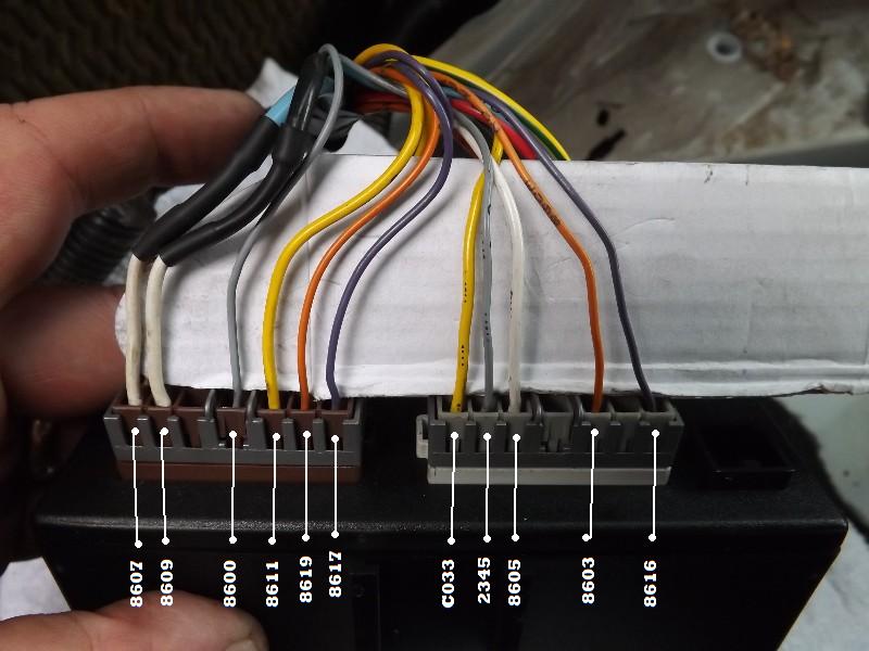

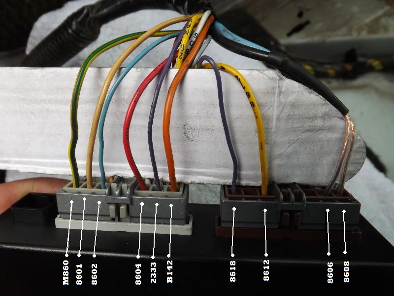

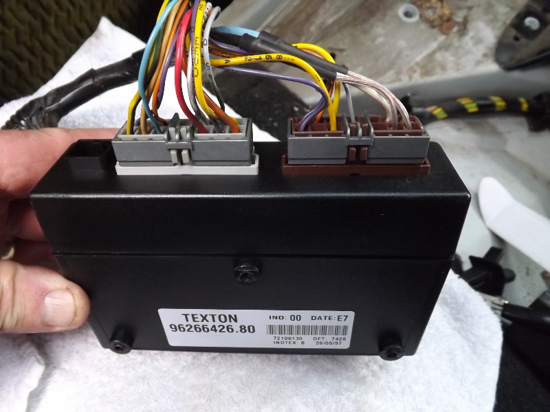

next set of pictures ar of the alarm control box
with an explanation of each wire
M860 : Ground/Earth
8601 : Bonnet open info
8602 : Theft protection alarm command
8604 : anti-theft alarm siren control
2333 : rear right direction indicator ????????
B142 : 12v
8618 : Connection to central locking controller
8612 : Right-hand front door open info
8606 : L Ultrasonic sensor
8608 : R Ultrasonic sensor
8607 : L Ultrasonic sensor
8609 : R Ultrasonic sensor
8600 : Dipped headlight relay command
8611 : Left-hand front door open info
8619 : Interior protection neutralisation info
8617 : Connection to central locking controller
C033 : ACC 12v IGN
2345 : rear left direction indicator
8605 : Theft protection alarm siren info
8603 : Theft protection alarm cut-off command
8616 : Boot open info
