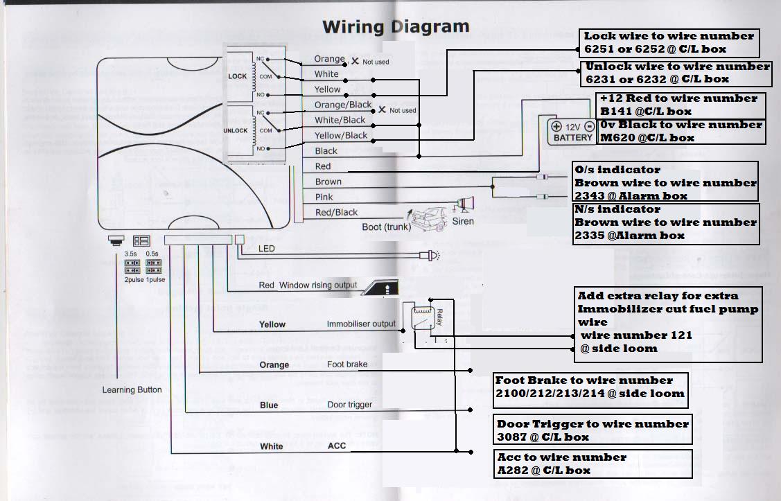

(22-08-2013, 08:05 PM)londondan86 Wrote: Woa! Nice one cully, may have a go at this myself! My p2 has no alarm at all, is there still a trigger wire for the indicators and could I add a siren do you think?
as for the trigger wires for the indicators the main rear light loom runs in the O/s quater panel so you could pick wires up there
i have been a little busy tonight but i have looked at the wiring drawings
and have come up with my plan of attack
the drawing im about to post is a thinking out loud drawing which i will test and confirm it works with more pictures of the install
RE: Ph2 IR central locking conversion to RF - by cully - 22-08-2013, 08:31 PM
