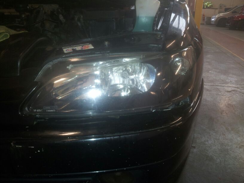

Rubbish picture but hey
Yeah i managed them with a heat gun. Used to refurb BMW e39 headlights, replacing the adjusters you needed to crack them open to acess them. and the heat gun method is something that i used all the time but the oven method is also a good one
next step is to go over the lenses with 1000, then 1500, and finally a 2000 grit sandpaper to make them all nice and new
