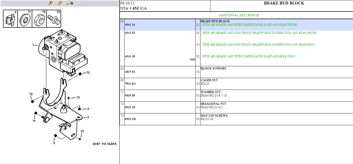

not anymore. i checked service box with my vin and the pug part number for my pump is 4541 34 if that's anyhelp. also checked with a generic 6 and it listed under additional abs5 bosch firstly my pump and another 2 the middle one was 4541 53 and the the last was NFP and was 4541 35. (screenshot below)
