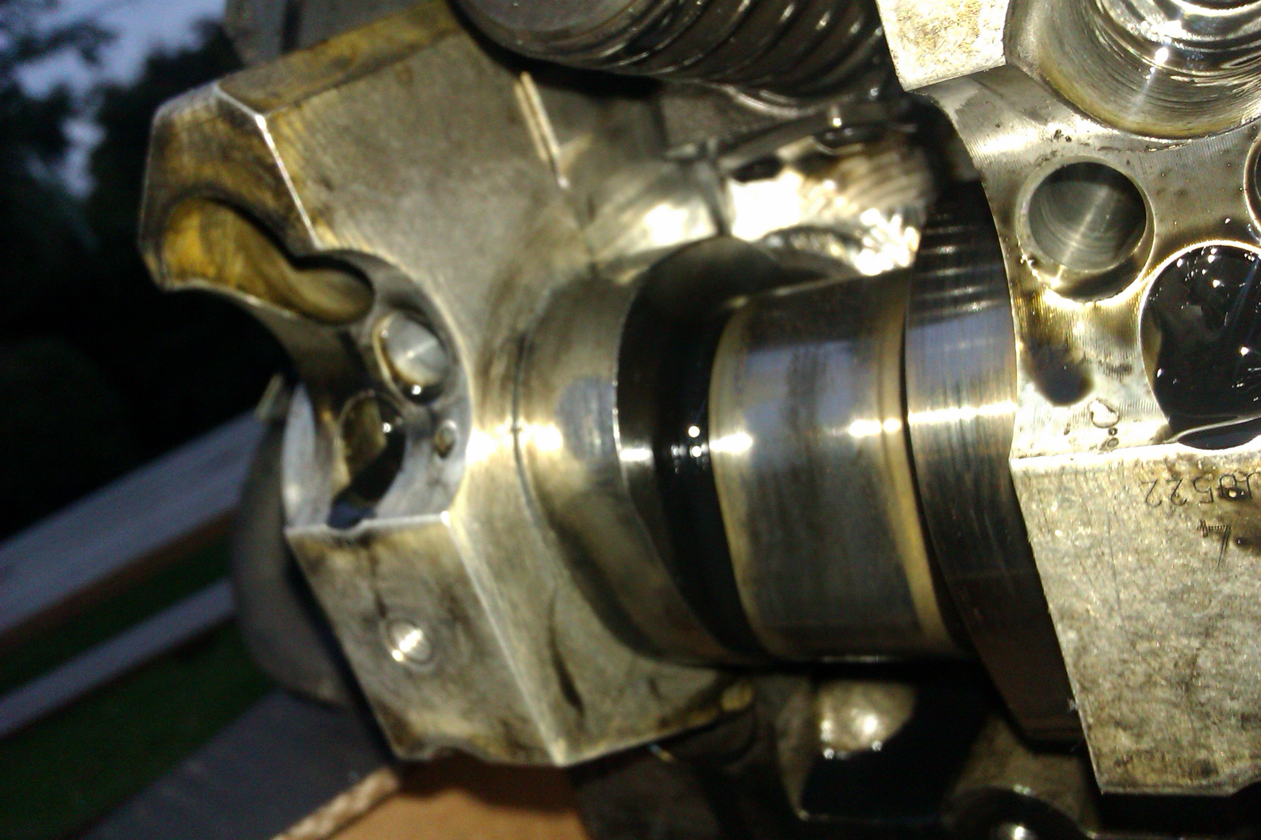

So erm, you know how cams are usually cam shaped like the one below, usually with a little less filings hanging off....
Yeah umm, the far right one is more egg shaped! lol
But on a serious note, with that much wear, and the huge dent in the lifter, the exhaust valve barely opens, litteraly a couple of mm max! Guessing that's the main problem lol.
What engine is it? I thought the 150's have crap cams?
Clearly 130s do as well!
It's actually the same part, but the 150s work it harder so they wear quicker.....that is until you're pushing mote than 150bhp through a 130. lol
