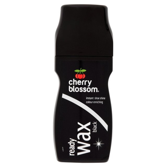

23-05-2017, 04:30 PM
(This post was last modified: 23-05-2017, 04:37 PM by cully.)
have been looking for something to turn my faded grey/black plastics back to black
after much searching I think i have found something better than peanut butter and cheaper than any car stuff in a tin
just mask up and paint on, took around 3 coats to go from grey to black the finish is excellent no brush lines or shading not sticky nor does it rub off
at 39p a bottle cheap as chips too
what do you think?
and what do you think it is Im using

23-05-2017, 06:02 PM
(This post was last modified: 23-05-2017, 06:03 PM by DeeTurbo.)
Wow, 39p and it looks great.
I haven't clue what it could be.
How did you hear about it?

Well, my guess with the chips reference and cost it would be vinegar.

found it by trawlin the net like most things
emptyed the bottle into a pot then used a paintbrush to apply it

Genius! Will be good to know how it lasts as lots of black plastic on my phase 2's is looking fairly shabby.
