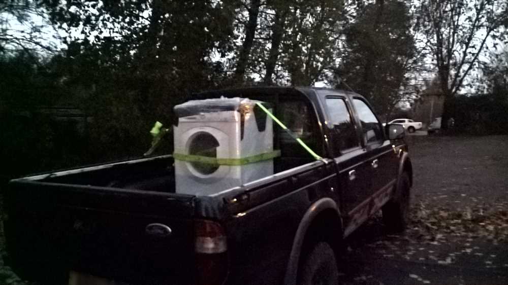

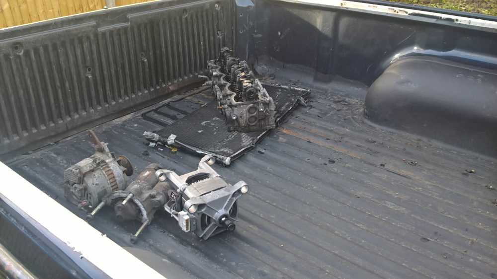

Anyway the Ranger has been being useful at picking up my new washing machine and running stuff up to the scrap yard.

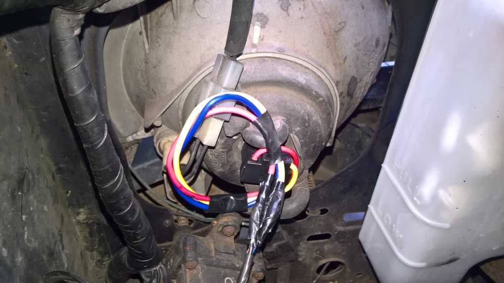

Swapped the headlight plugs for some brand new ones as a common fault on these is the plugs corroding giving dim headlights.

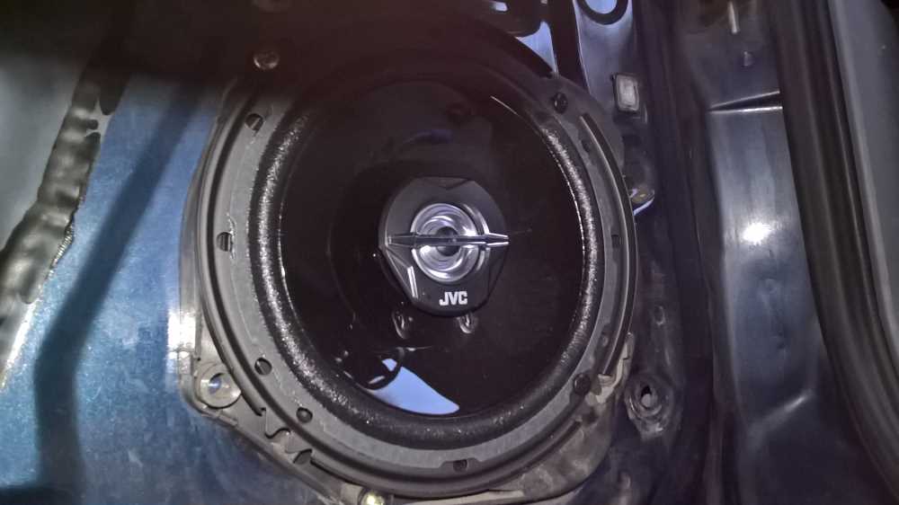

And fitted some new JVC speakers as the originals sounded terrible and popped and crackled at anything past volume 20 (you'd need volume 30 to drown out the road/wind noise at 70mph)

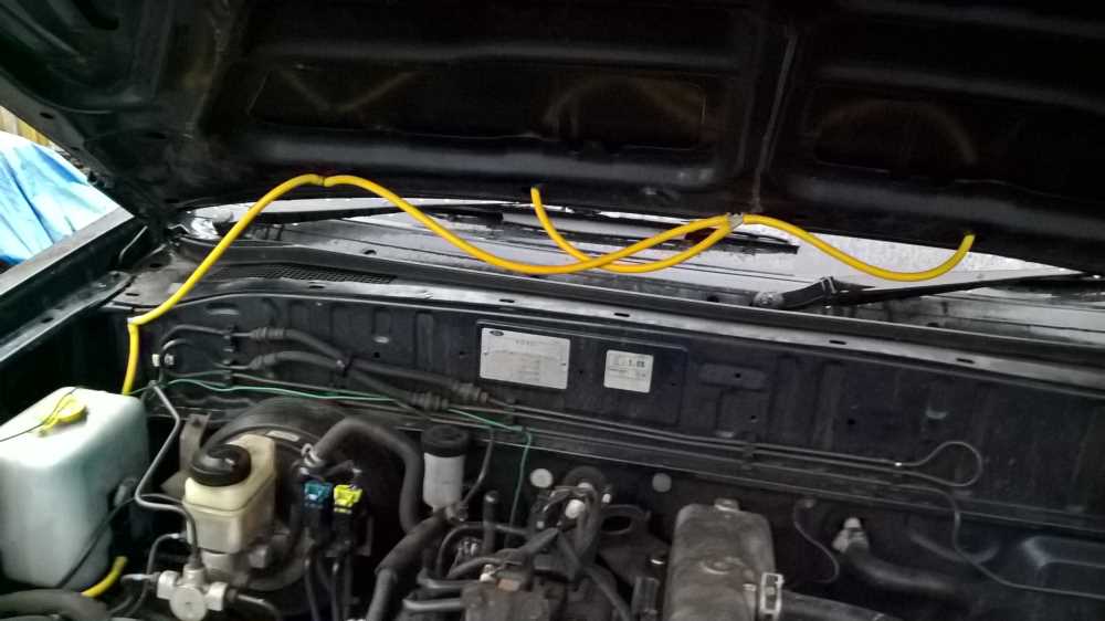

Been having terrible trouble with the washers generally being shit, decided after cleaning them out I'd re-hose them with some nice yellow silicone I had knocking about.
Been up to Scotland, at a steady 75mph on the way up I got 22mpg Sad

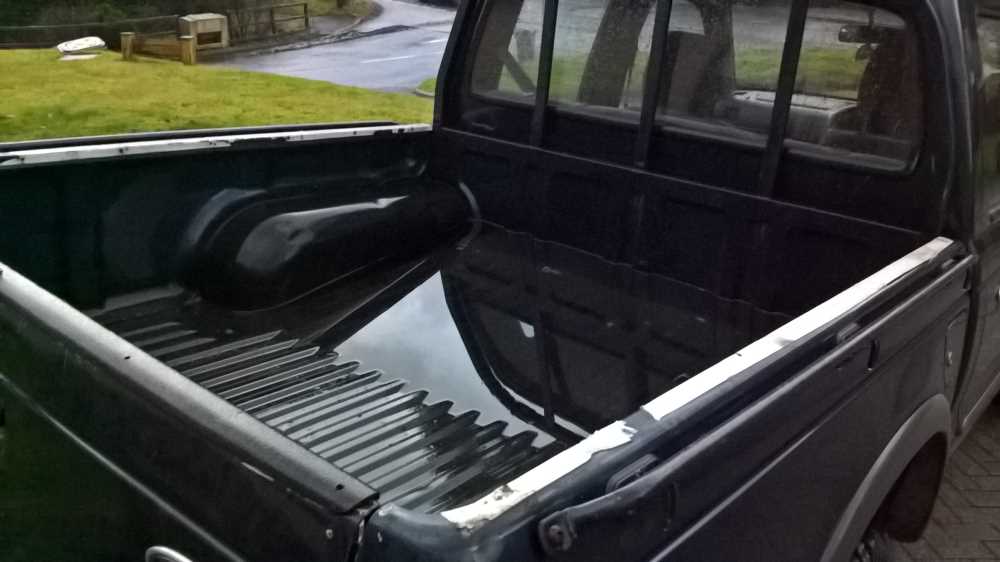

Only took a couple of days to get a massive puddle in the bed.

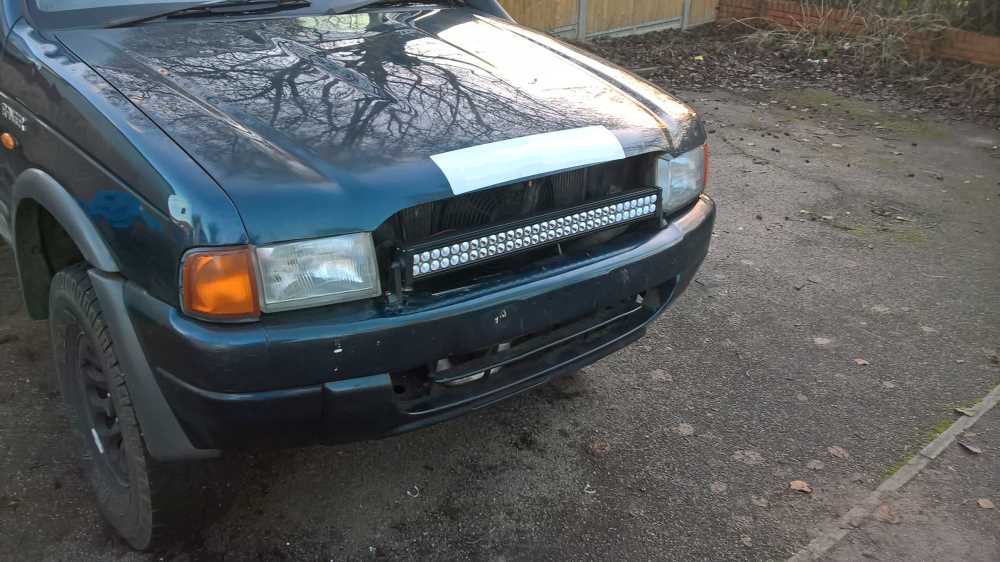

Now I've started fitting a LED light bar to the front. Going to cut the grille to fit around it, hopefully cover the mounts too.

Done some more on the light bar, cut the grille to fit the bar, sadly I couldn't keep it in one piece and it looks shit but I can't see how I could do it better (other than cutting straighter).

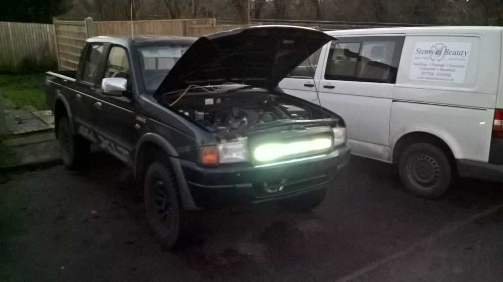

I've largely got it wired in via a fused relay. Just need to mount a switch and run the last wire from that to the relay. Going for an on-off-on switch.
I did run a little bit of wire from the relay to the battery to check the relay was all working nicely and sadly it's so bright it makes my camera go shit but even in the daylight you can see the light on the houses 50m+ away.
