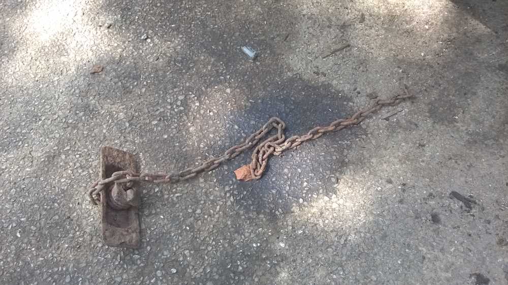

Stripping stuff off the underside is finished as I have the spare wheel out
It is suspended by a chain that is turned through a hole above the numberplate I have a 6 sided chisel that fits in a 17mm socket so that on a few extensions and a breaker bar got at it, I turned it till it had let the chain all the way out and then gave it some welly and snapped the chain with brute force on the breaker bar.

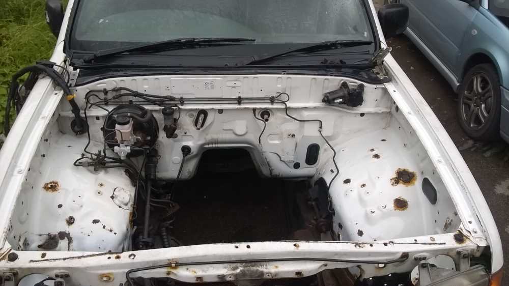

I looked at the fuse box again and it actually says what fuses it wants so it's an easy fix when the fuses get here.
I unplugged all the wiring from the bay and labelled it. I gave the bay a good attacking with a bottle of Cilit Bang and a scrubbing brush. I actually can't believe how well it came up, wire brush and treat the rust next.
And gave her her first wash of my ownership, again surprised as to how well she came out, she's much whiter but still not what you'd really call white and there is a load of green stuff between the cab and the bed I can't get at for the moment. I think I'm gonna take the bed off at some point to clean up underneath and get at the fuel tank.

Hehe, get plenty of grinder discs in stock, unless you have a plasma cutter Tongue That bulkhead is going to be getting a nice massage at some point in the near future! Smile
Looks good though, always pays to get everything clean / sorted out before starting on a project like this!

#76
looks fairly tidy actually. cant believe how good that bay is.

(21-06-2016, 05:02 PM)Eeyore Wrote: looks fairly tidy actually. cant believe how good that bay is.
Cheers buddy, it's only really rusting around where the arch liner clips come through and only one of the holes is going to need welding.
