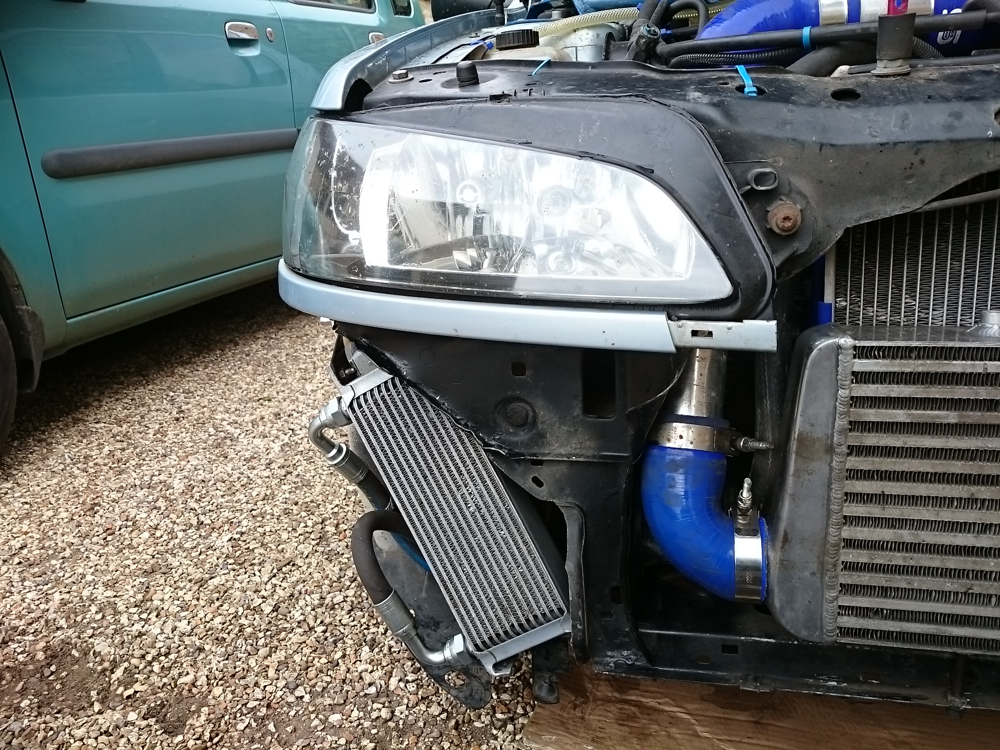

Got oil cooler on... Remember previous results? Hopefully this be a bit better. Mocal 13row cooler and thermostatic sandwich plate, pirtek lines.
How it sort of sits.... Note: less kinky boost hose also
With bumper: (bumper just slotted on to check fitment)
It will get some shrowding as will the rad/ic.
Had to "make" a tool for doing up the oil lines in place...
Painted couple brackets that looked nasty too. Lots of room now for some air flow
#looking good bro
love the tool got a few of them in my own workshop
Haven't you got to be a bit careful running the cooler upside down?
its pressured wont make a blind bit of difference

(19-05-2016, 07:51 PM)allye Wrote: Haven't you got to be a bit careful running the cooler upside down?
Run it anyway you want... 6 bar pressure sorts things out
