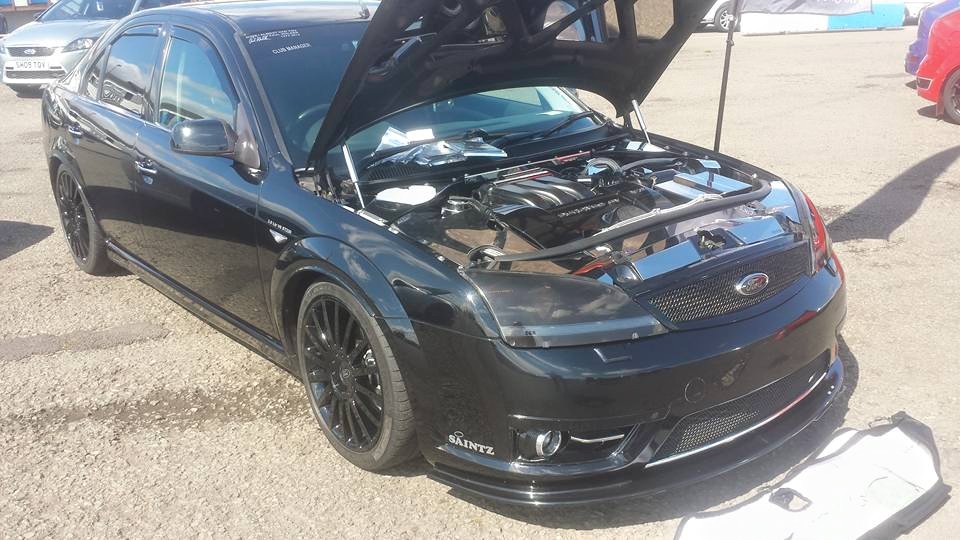

One of those things I've started and never finished,I used lods of autosol but only rubbed it in by hand,you should do the cam covers next.
[Image: Cn91r40h.jpg]
Cheers dude, yep cam covers are next on the list.
