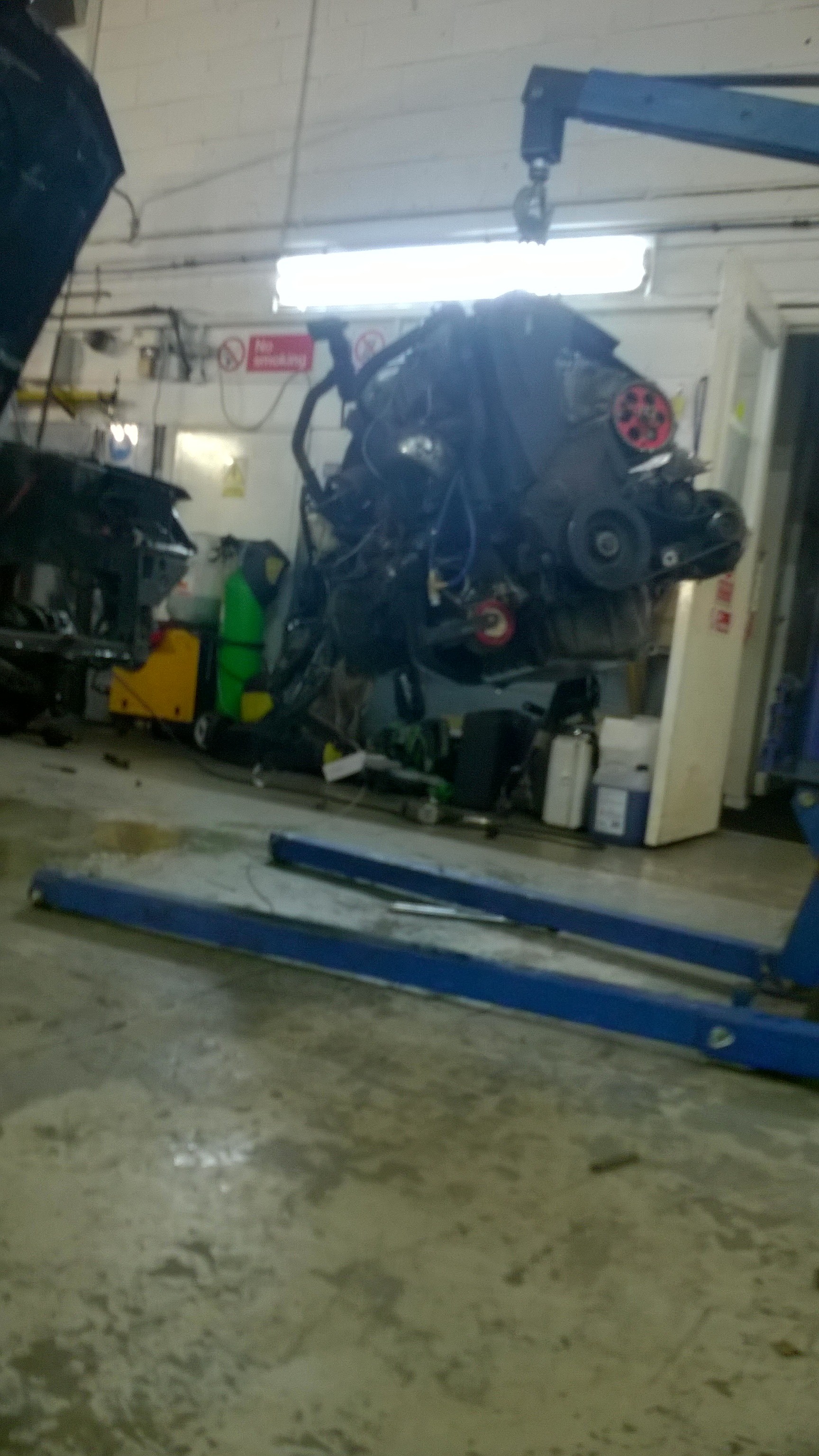

Engines out guys. Wink
New PB i think
Update. Building up a bosch for this and all i have is 11mm heads. FML. I want a 9 for once!!
So im back. Left workshop at 1.47 in the morning. FML ran into issues trying to bodge a bosch pump together for it out of salvaged parts. Fired up and drove home fine though.

(24-10-2015, 01:11 AM)bashbarnard Wrote: So im back. Left workshop at 1.47 in the morning. FML ran into issues trying to bodge a bosch pump together for it out of salvaged parts. Fired up and drove home fine though.
Glad to hear the engine is good Smile Hows the clutch?
Team Cyril
No piggy this one was not fun. But i wanted to have a weekend off. Well after work till 12 today anyway. Clutch is fine. More than happy with it. Think the crank pickup for the revs needs replacing drops in and out on good known clocks but thats it. Everything else is spot on. So far done 26 miles.

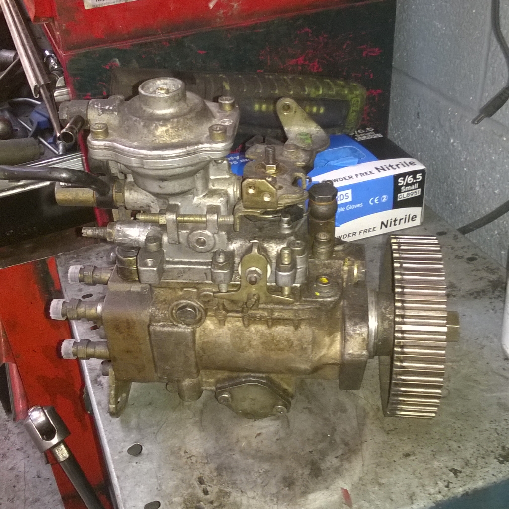

So i pulled the pump off the 806 to find it was semi ecu controlled so got a spare pump body out and a spare advance mech and thrashed together a 9mm pump for the old thing. 9mm will flow more than enough until i get bored again plus the 11mm on the tiny turbo is driving me mad. so made a short video of the strip down for you guys as well. overall the engine went in last friday night and i havnt lifted the bonnet once since. got to love the reliability for a change. Also got myself a xantia manifold coming to fit the front mount as the top mount is doing nothing. has no flow to it as the bonnet lining was removed for the 2.1 and i already have a FMIC to go on so why not hey.

So another 9mm built for her to get the 11 off. Not needed for the tune im going for. Plus if i ever got bored it super easy to put 11 mm on this pump. So ill have an 11mm for sale soon. Got my xantia manifold through as well so this weekend its full steam ahead. To get my winter setup. There are wheels in motion for this to have "reasonable" power again soon but still reliable. Smile so ill then be happy to move anto another project

Who do you get your seal kits for the ve bash?
Was guna get 2 kits off darwen diesels, these any good?
http://www.darwendiesels.com/common-rail...m?id=12686
                                                      HDI D'Turbo Daily Driver ---- XUD D'Turbo Project
I get them off my motor factors get them for super cheap. Ebay if not.
People have been sayin the ebay ones arent great quality.
That kit off darwen diesel is £5 i think. Farely good value
And is the shaft on our pumps 17 or 20mm?
Im guessing 17mm
Sure its 20 mm on our pumps. Ill get you the bosch part number then just look for that. Then you have quality parts.
Yeah its 20mm. Measured 1 there now

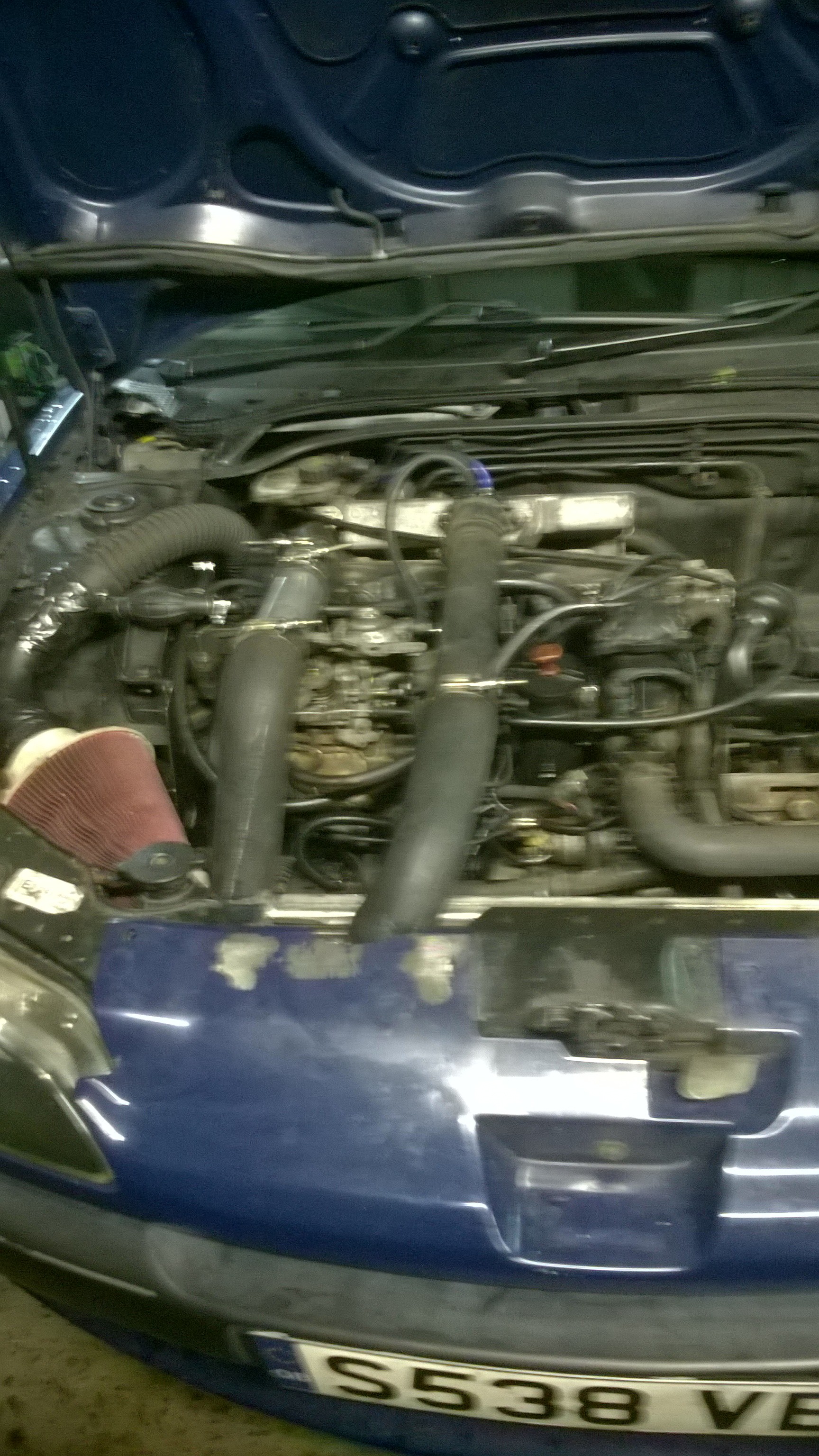

So tonight i got my "winter setup" sorted. 9mm pump back on. Thank god. 11mm was horrid on tiny turbo. Front mount fitted. New cambelt on penny mod on fuel filter for the ol veg oil. Lots of bodges and a huge snagging list i have. Air filter to sort. Catch tank to sort. Interior gauges to sort. Properly tapped in boost take offs. Rocker cover and gasket. Oil and coolant change probably got a few more things. But im happy with the power for now while i have my winter off climbing under the dam thing. You guys are just going to have to wait for the big boost for now.

Just secured some wiring and adjusted some bits in the bay and where the battery used to sit just looks so empty! Im sure filling it with a turbo would make it feel better about itself.
