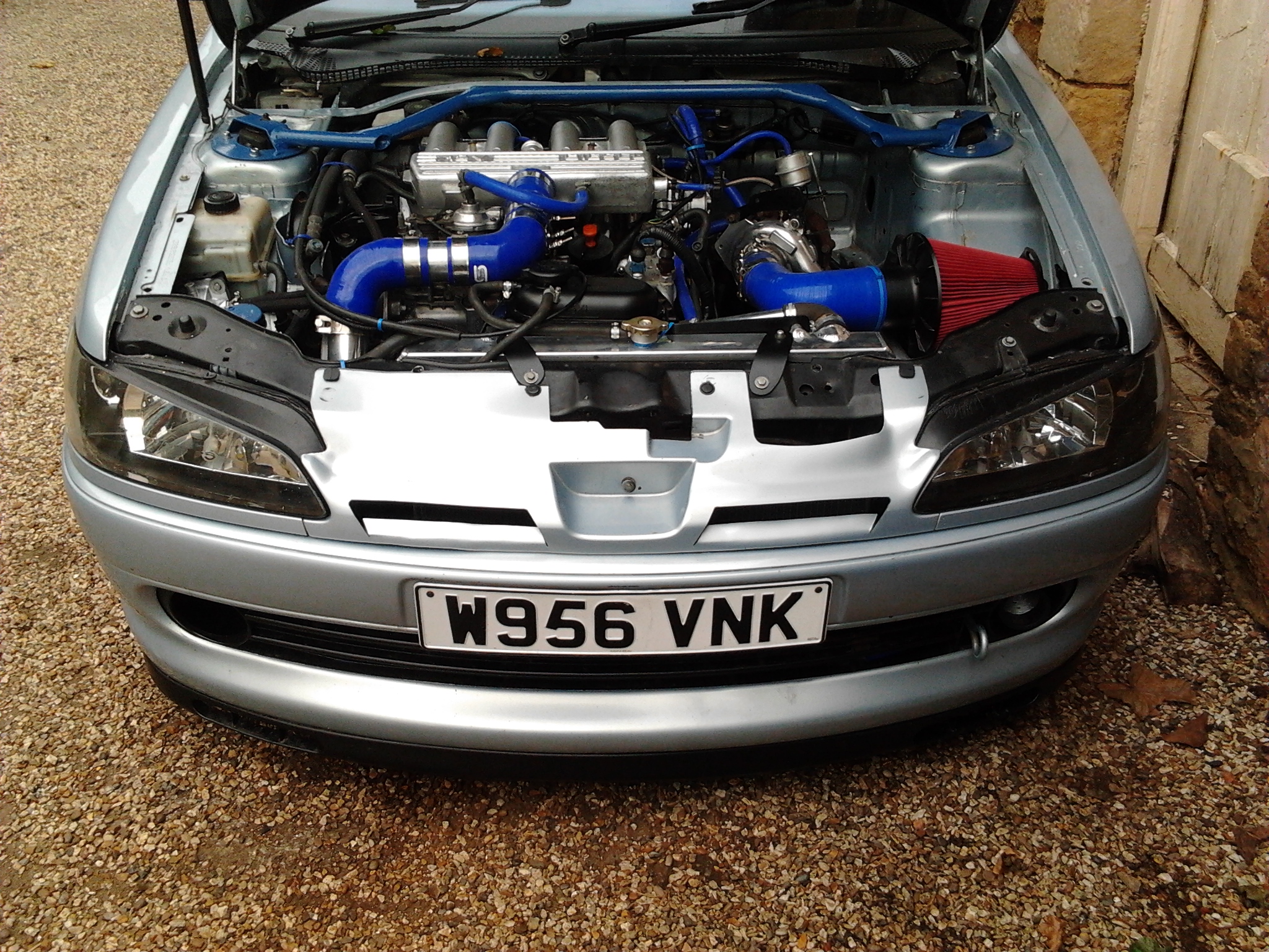

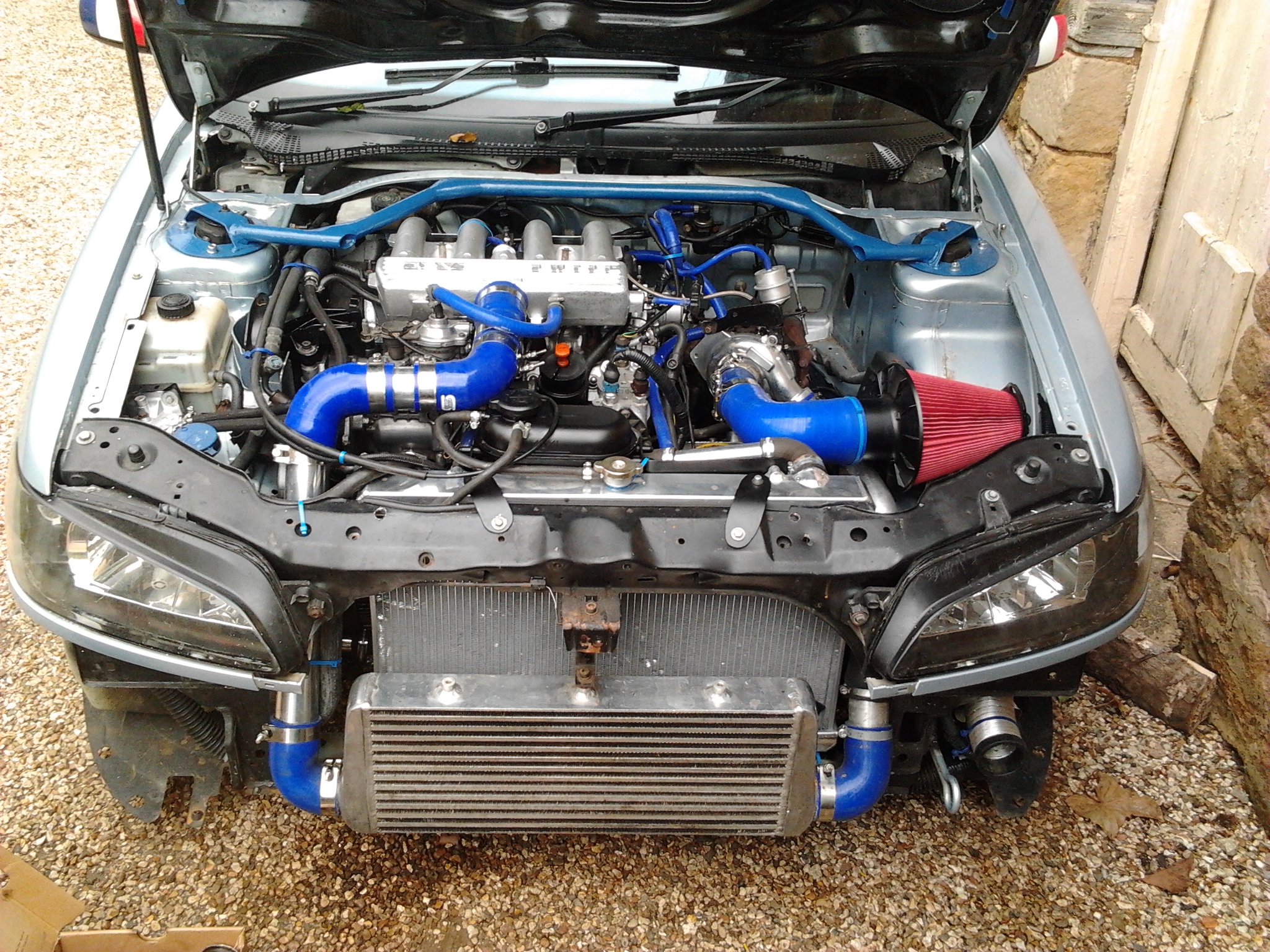

soooo... no video updates as I have naff all internet
But I hope these pics will upload.
Basically, just been waiting on little bits to arrive as so busy not got time to go to shops or a town WITH shops to buy the odd bit of pipe or connector!
Cooling system is FINALLY plumbed in and bled. Had to switch to 19mm piping to the rear of the block from expansion bottle which was a PIG!
Then had to order two 90degree bends from ASH, SO EXPENSIVE, which then turned up two days late after paying next day delivery.
Bodged the grill to see if it helps and if I like the look of it. One side was ok, the other I got too hot. Doh (see wanted thread! lol)

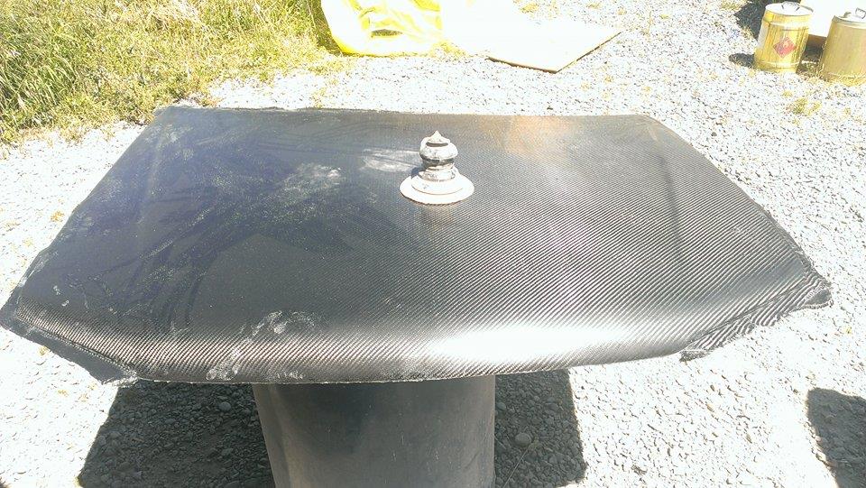

Need to finish the bonnet now (guna attempt to wrap it in something you will all hate) and will try and get some lexan sliders in place as its BOILING inside!

Could be much worse than carbon wrap.

Good things: was epic fun, used £7 fuel to get there and back and do 5 runs. Cooling was well up for the job. Got the back out a little. Great to see everyone. Make coal and noise! No one seemed too upset with my "carbon effect wrap"!

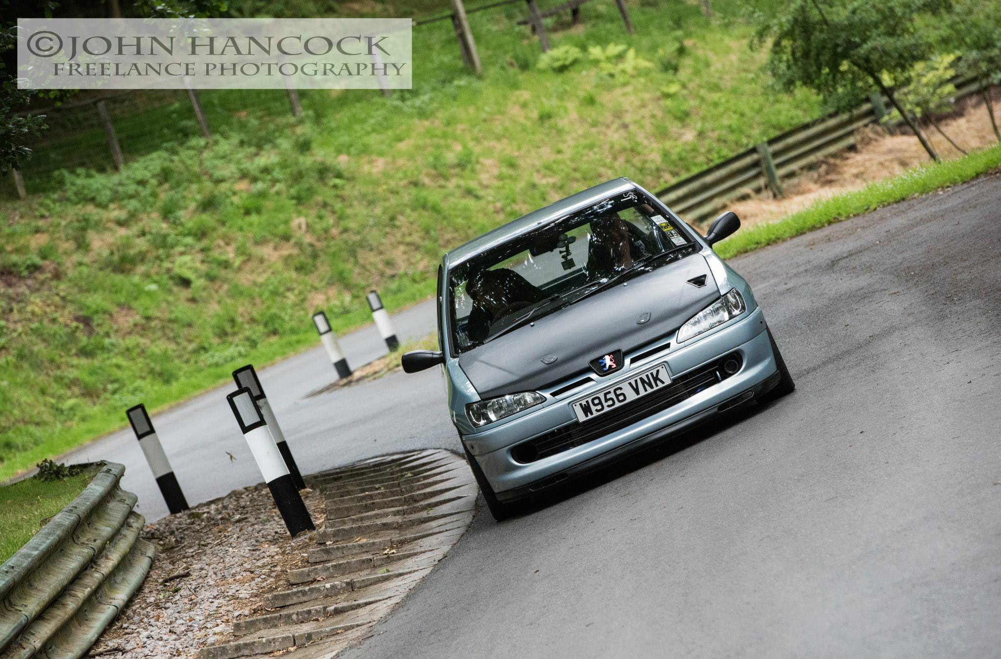

weighed it in today.
1000kg!
some pics:
1000kg?? you need to get this thing down to 950 kg Tongue
(13-07-2015, 08:18 PM)procta Wrote: 1000kg??  you need to get this thing down to 950 kg Tongue
still got heavy fiberglass seats, steel wheels, fat spacers and the sound deadening stuff.
Don't think I would managed 950 though...not without a different engine me thinks
Trucks use the Mikalor High pressure clamps on the boost hoses, they work, never had issues fitting them.
looking them up on the Mikalor site their data suggests around 20 bar pressure for the standard Jubilee worm drive clamp, or near double for the T-bolt style.
what the hell you doing with two seats? get one removed and tell the wife to walk Tongue
(13-07-2015, 08:23 PM)procta Wrote: what the hell you doing with two seats?  get one removed and tell the wife to walk Tongue
tbh, she prefers it.
I seemed to scare her too much on way to pugfest that her nerves were no good for any hill runs lol  I was only cruising too!

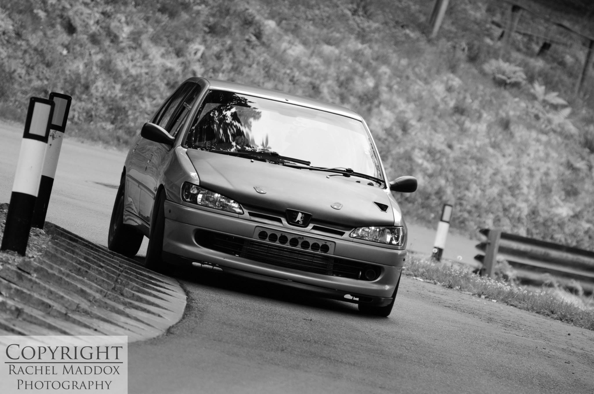

I just timed my runs:
from 1st to 5th run:
1:02
59.5
59
59
57.5
I really wanted another run or two but it was too late and with our bodged repair I wasnt sure how long I would have my coolant.
The first bend, once warm and rubbered in I rekon is flat. Second hairpin I need to carry MUCH more momentum through, little kink before esses needs to be flat, then straighten and brake for the esses, and last bend I think I need to stay in 3rd aswell, lose a LOT of time on the second hairpin and last bend.
Car was immense to be honest, so much more grip than last year, more power but able to put more down, and the brakes are just amazing.
The only reason it wasnt closer to 55 seconds.... me. Driver lack of skill!
