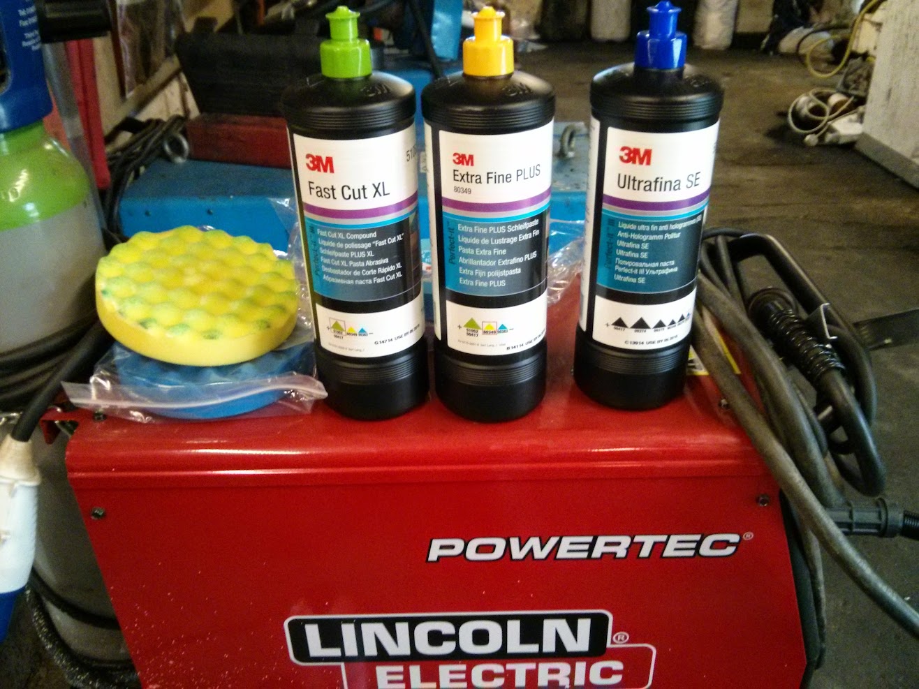

This went on for many hours, and although "progress" was being made, I couldnt seem to "correct" the marks the sand paper was putting into it, I was using quality paper, and a sanding block, but still somehow managing to put deep marks in, that simply wouldnt buff out....After doing numberous research online, I decided to try using some "proper" products rather than just what I had lying around, so bought what everyone recommended, cutting products and pads all from 3M:
[Image: X6DqrnFPRKoyDbMPcdCKsb9v7CPwp4CWW6gXgLH3...16-h987-no]
Now I must say at this point, this is the next big lesson learnt / advice to anyone else trying....dont even waste 2 minutes messing around with products you can buy in halfords etc...complete waste of your time and effort...proper product and pad instantly made this job 100 times easier!
So sanded some panels back again, and re buffed using the new products:
[Image: IMG_20140718_200937.jpg]
[Image: IMG_20140719_195104.jpg]
As you can see, a much better shine was made possible using these, which also claim to have no fillers in them at all, IE what you see is what is acaully going on!
