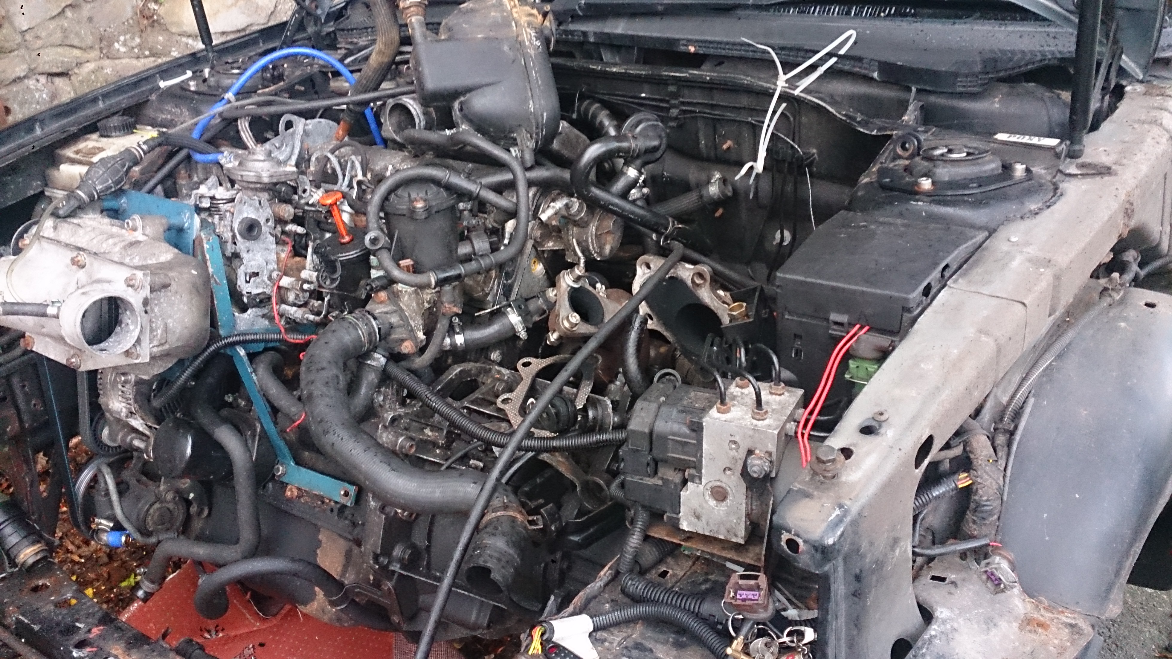

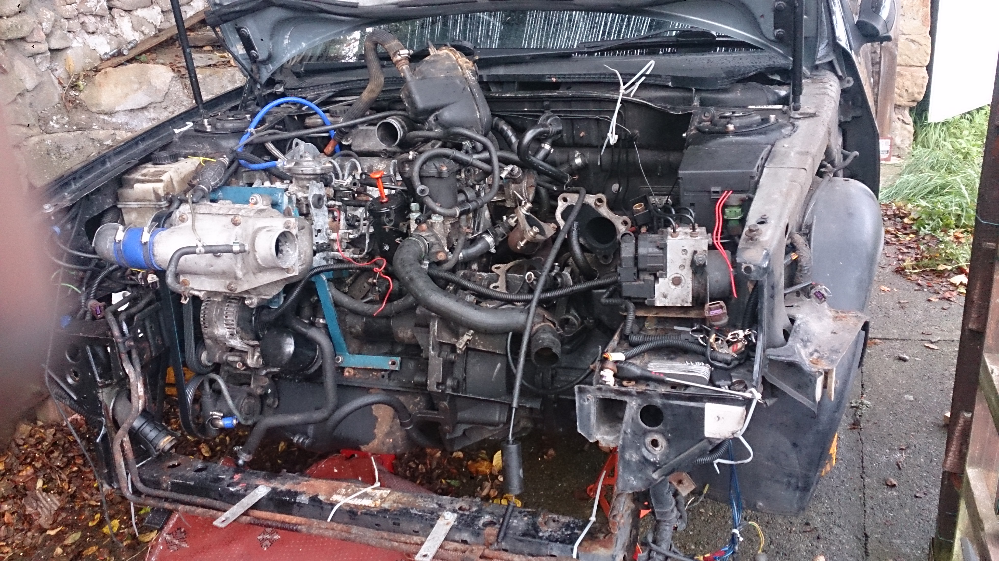

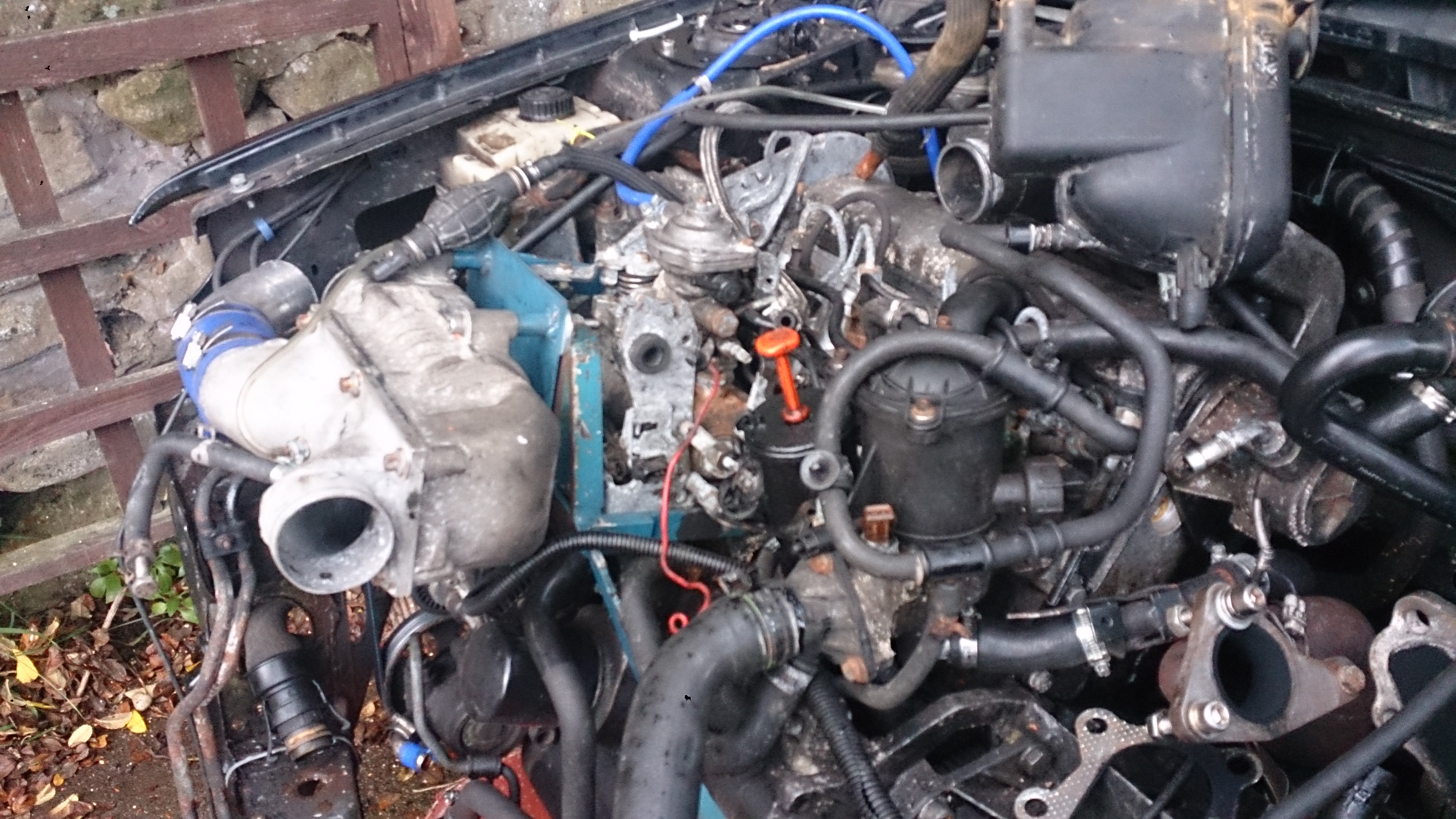

Finally an update - even if it is a small one!
Began the strip down today at last. Just haven't had the time lately but she's not been forgotten!
Front end off
Bits on the floor! lol
How she looks now, very sad!! Even had to take a wing off as I couldnt fit through the gap between the car and fence!
Need to sort out a hoist now to get the engine out to be stripped down. Debating on whether to buy or hire as I have a feeling it may be out again rather a lot!!
