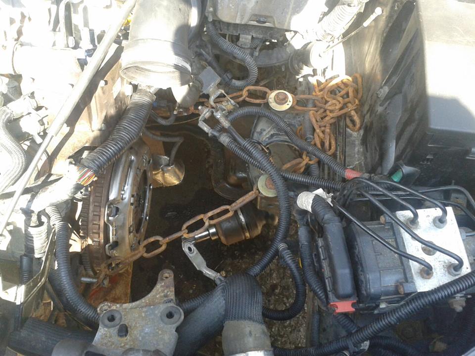

So all sorted now? seems like I have a rattly bearing now too so will be doing this job shortly

That LUK clutch looks quite worn to me!
Well done though chap...you are no longer a clutch virgin, congratulations!
AAHHH think I could well be in need of a gearbox and it wasn't the clutch atall!! f*cking hdi's!!
Just whack your spare DT box on it if you've still got it? just swap the bits from the HDi box?

shit one dude! makes me think twice about just whacking a clutch in mine as the box seems a bit notchy atm too
[Image: 20gh7o0.jpg]
Gearbox needed the Sad had to take it out again and roll the car back

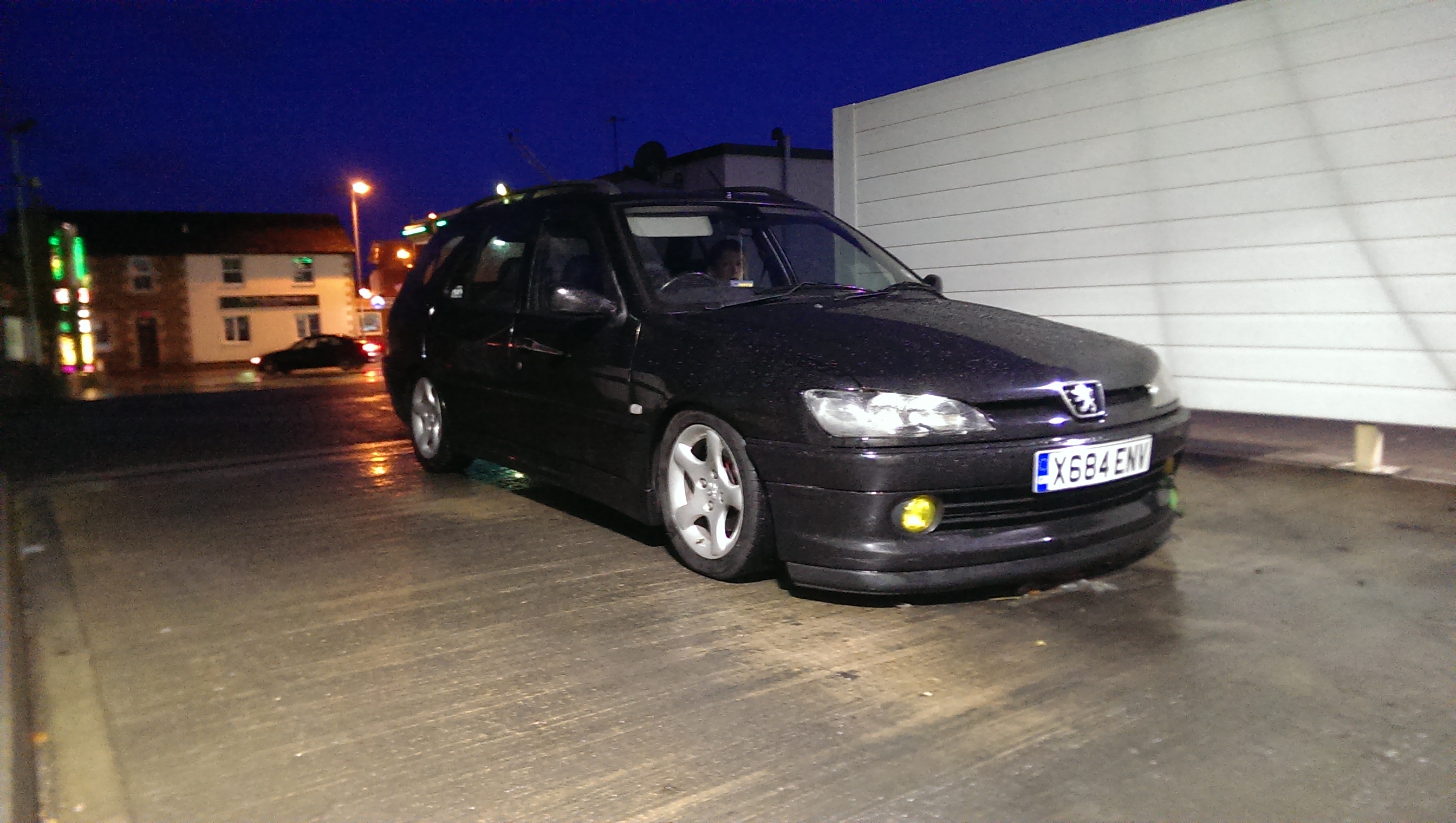

BECAUSElightweightracestate?
nice new clutch in there though!
well that's summin I guess
Nice chain in there! That's something else. Any you've saved weight. See, the pros are adding up!
custom solid engine mount is that Big Grin

Sad prefer the old wheels. Looked awesome! But loving the new lows!

Ooh I like it. Agree with matt though, needs something more exotic than clones

defo need to do sumit exciting with the clones...looks a bit boring

I much prefer it on the 'clones tbh!

cheers Tomm i think so too Big Grin

Please put the minilites on it, it would be so much win
