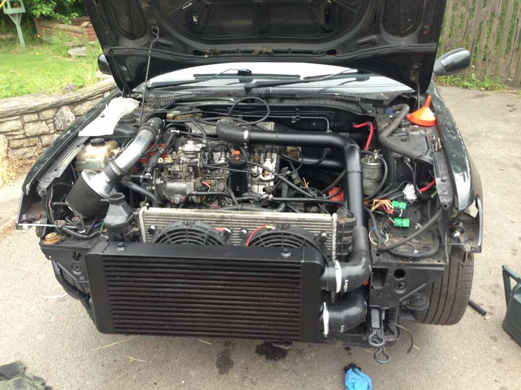

Got the air intake sorted today. Its quite a tight fit between the inlet manifold and brake servo but i think it sould be fine. I think for some reason it seem to be holding it back though but its difficult to know as i havent really driven it yet.

Would you not have been better coming straight up between the brake fluid reservoir and side of engine bay?
Boost pipe in the way . wouldn't be able to mount filter

(20-07-2013, 10:29 PM)Sambarker Wrote: Would you not have been better coming straight up between the brake fluid reservoir and side of engine bay?
Like jimbo said there is no room there cuz of the boost pipe
Got some black 90deg silicone bends today from modified mania so all the boost pipe joints all match and these are a little longer so the pipes seem to fit a bit better
[Image: null_zpsc7039779.jpg]
I do think that something is not right with the air filter though. When i rev it right up the piping pulls together like its sucking a lot and not getting enough air. But it is hard to explain. I need to take the air filter off and then see what it does

What size is the air intake pipe? The flexible one.
(22-07-2013, 01:38 PM)Tom Wrote: What size is the air intake pipe? The flexible one.
The flexi pipe is 70mm and I got a silicone reducer for the turbo 51mm to 70mm
