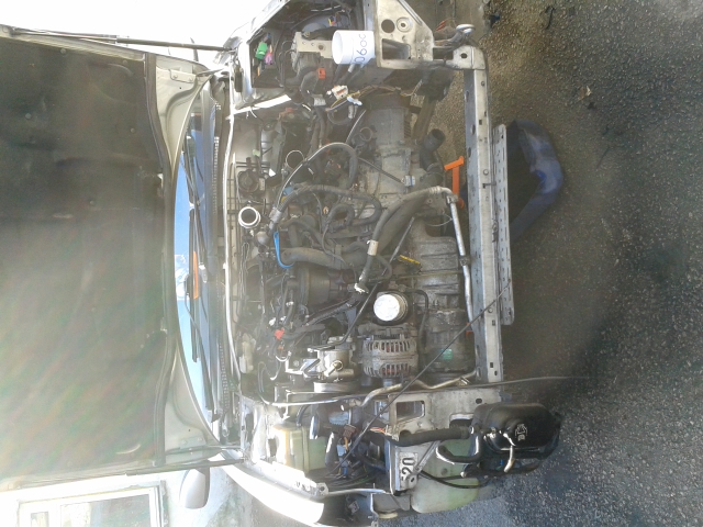

Went and got a replacement engine today, then started taking the old one out.
You'll have it done before the weekend then.
No. Just made a start, I wanted to take my time removing the aircon as I'm either going to sell it as a complete working system or keep it in storage in case I wanted to fit it again in the future.

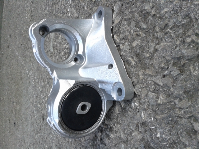

Bit of progress tonight, I've cleaned up the new engine and started making a stiffer bottom engine mount.

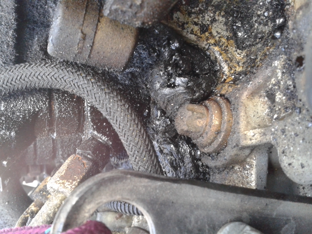

This is what a leaking injector does over a long time.
And the "solid" bottom mount.
Don't know why my phone does that to the pictures. They were the right way up when I took them..
The Rattle-your-teeth-out-o-matic 5000 being fitted to the lower engine mount, I see..
Just keep an eye on your gearbox bolts it's a solid mount that ultimately killed my car twice! I do however have my billet item for sale if you want a proper one lol!
www.prestige-auto-care.co.uk
What did you use to put in the lower engine mount Jonny?
A rubber mallet it seems lmao
Oh I see lol
It looked like dirty metal.
My bad
Yeah yeah I'm a pikey. But tbh it's solid rubber pressed into the mount. Same as any other uprated one
I've finished it now, looks good Big Grin

In other news, I've got my aux belt fitted, hopefully going to make my new battery box tonight.
