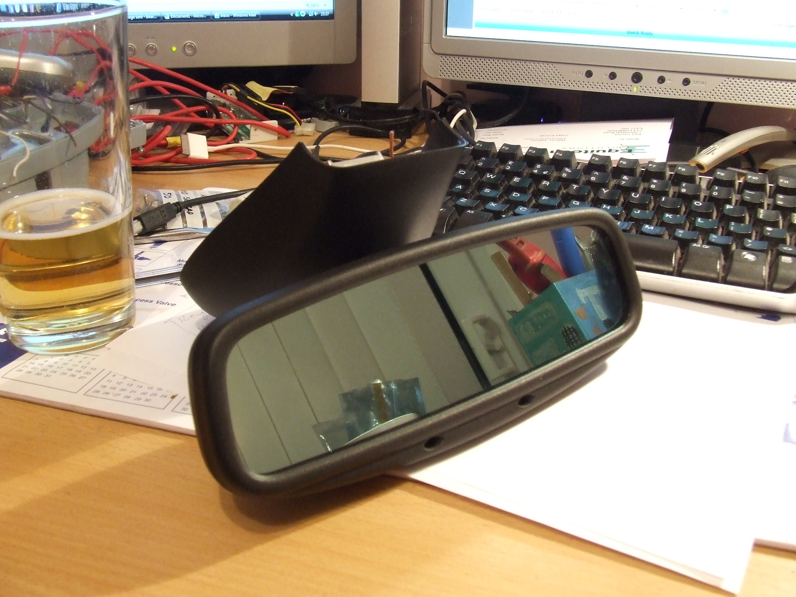

03-02-2012, 11:40 PM
Chris Wrote:Audo dimming mirror? yes! This was mentioned before.... but its quite a large parcel... :/
03-02-2012, 11:41 PM
Chris Wrote:Audo dimming mirror? well done chris we have a winner Rep for you ........ well there would be if there was some was a large parcel as the seller went mad with the bubble wrap
03-02-2012, 11:45 PM
BOOO! Only an interor mirror

03-02-2012, 11:51 PM
what colours are the wires coming out the mirror? iv just fitted one
03-02-2012, 11:53 PM
Mines wiered up to the map light, going to do the reverse wire too at some pint.
03-02-2012, 11:55 PM
Black is 0V, white is Switched 12V, and the grey is to the reverse lights

04-02-2012, 08:51 AM
ive yet to look at how to get the 306 mirror off
is it a case off slideing the mount up off the fixing block?
04-02-2012, 08:55 AM
cully Wrote:ive yet to look at how to get the 306 mirror off Yeah, just firmly smack the mounting arm from underneath with one hand while supporting the mirror with the other hand so it doesn't fly across the car/smack you in the face But yes it just slides over the top of the block
cully Wrote:ive yet to look at how to get the 306 mirror off Yeah the whole thing just slides..........but the glue on the block isnt all that good and often pulls off with the mirror! In my heavy handed experience anyway!
04-02-2012, 08:57 AM
Toms306 Wrote:cully Wrote:ive yet to look at how to get the 306 mirror off Thats just you tom, never had a problem, if you just hit it then the mirror pops off nicely if you rive it around you will probably pull the block off the window
