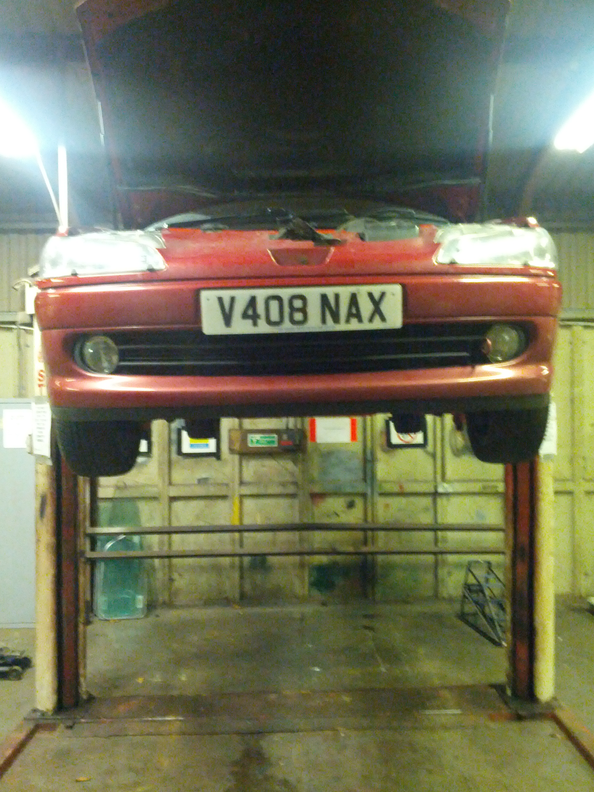

Productive evening at the motorclub....
'6 splitter fitted, '6 brakes fitted, lower anti roll bar fitted & decat...
slight problem with the decat though... its knocking on the subframe, short of grinding the sub frame down a bit and the same with the decat, i cant think what else to do!
Ive even raised the middle exhaust clamp to try and lift it a bit more...
Thinking about trying to find a pipe bender and just give it a little knick just so it misses the subframe...

Rung up an exhaust place in basingstoke who are going to have a look and bend the exhaust so it misses, it only just hits atm, but its enough to make a shit noise in the cabin!
Will be sorted today or tomorrow, and ill get some pics of my new stuff!
#44
Front end
New brakes

What are your engine mounts like? My exhaust used to catch the subframe, had too much movement in the engine
[Image: SDC10442-1.jpg]

Not had a chance to "drive" themyet cos of the rattle...
(18-10-2012, 07:13 PM)Jonny b Wrote: What are your engine mounts like? My exhaust used to catch the subframe, had too much movement in the engine
Mounts are fine... ive got an inch clearance between the bottom of the exhaust and the subframe...
the knocking onlycomes when the clutch is engaged....

Um, sorry to piss on your fire, but that means your mounts probably aren't fine lol.

As poodle said bud mounts are probably shot, check the top mount that's usually first to go and causes most movement
