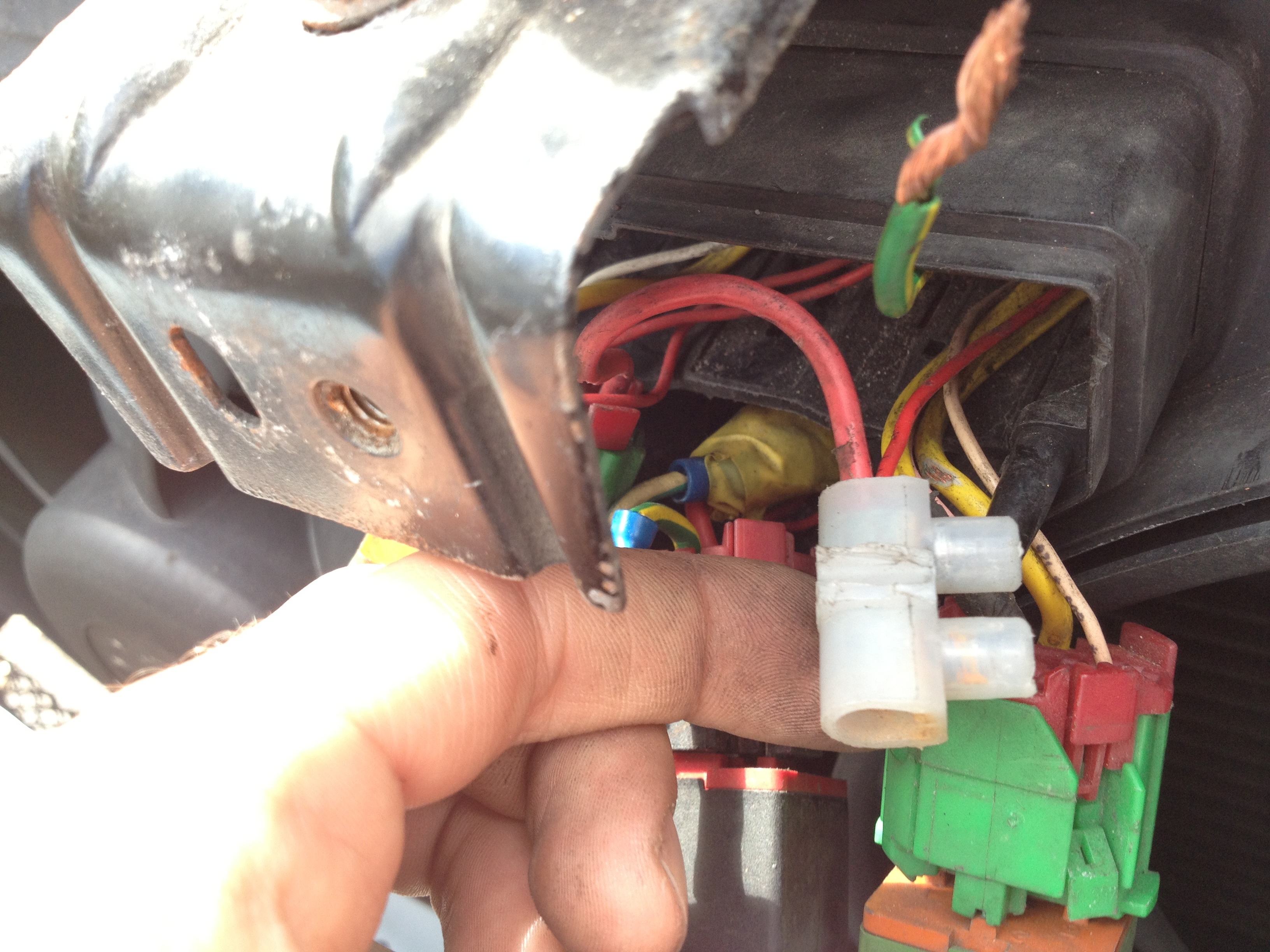

Fan not kicking in - Northern-john - 30-06-2013 Hi guys, this wiring doesn't look right to me.. Any advice on what to try to test radiator fan? And in layman a terms haha, I'm new to pugs
RE: An not kicking in - pugjohn306 - 30-06-2013 (30-06-2013, 09:28 AM)Northern-john Wrote: Hi guys, this wiring doesn't look right to me.. Any advice on what to try to test radiator fan? That looks like someone has had summin previously wired in...as for the fans mate most likely thermostat... RE: An not kicking in - Northern-john - 30-06-2013 So just a case of re-earthing, and then checking the thermostat?.. Any clues as to where it is?.. RE: An not kicking in - pugjohn306 - 30-06-2013 (30-06-2013, 12:57 PM)Northern-john Wrote: So just a case of re-earthing, and then checking the thermostat?.. Any clues as to where it is?.. Usualy on the radiator mate RE: An not kicking in - Niall - 30-06-2013 Does yours have AC? If so, i unplug the brown sensor on the thermostat housing with the engine running. If the fans dont kick in on full speed after a few seconds, you need a new Bitron fan controller RE: An not kicking in - Northern-john - 30-06-2013 (30-06-2013, 03:19 PM)niall Wrote: Does yours have AC? If so, i unplug the brown sensor on the thermostat housing with the engine running. If the fans dont kick in on full speed after a few seconds, you need a new Bitron fan controller Tried that, and still nothing , but also, checked the thermostat.. And correct me if I'm wrong, but there's part of it missing? LolOh and forgot to add, the ac still works lol RE: Fan not kicking in - Niall - 30-06-2013 Err yes that is f*cked! lol In which case mate, you need a new bitron fan controller. http://www.ebay.co.uk/itm/PEUGEOT-306-405-806-CITROEN-ZX-XANTIA-SYNERGIE-RADIATOR-FAN-BITRON-CONTROL-UNIT-/321064043503?pt=UK_CarsParts_Vehicles_CarParts_SM&hash=item4ac0e883ef Thats what you need but its far too expensive!! Ring round some scrappies and you should be able to pick one up for about £20. It lives under the inner wing under the near side headlight. Bit fiddly to replace. Have to take out the arch liner then you can get to it. |
